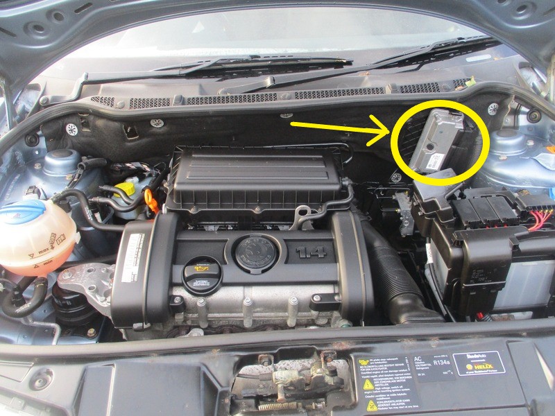

Anybody know where the engine ECU are located?
The mechanic says he have tested the fuel pump and fuel pump relay.
Is it a common thing that the ECU ****s up in these kind of cars?
Silver box, back of engine compartment on the right.

I wouldn't say ECU failure is common on the Fabia, no. What model Fabia is it?

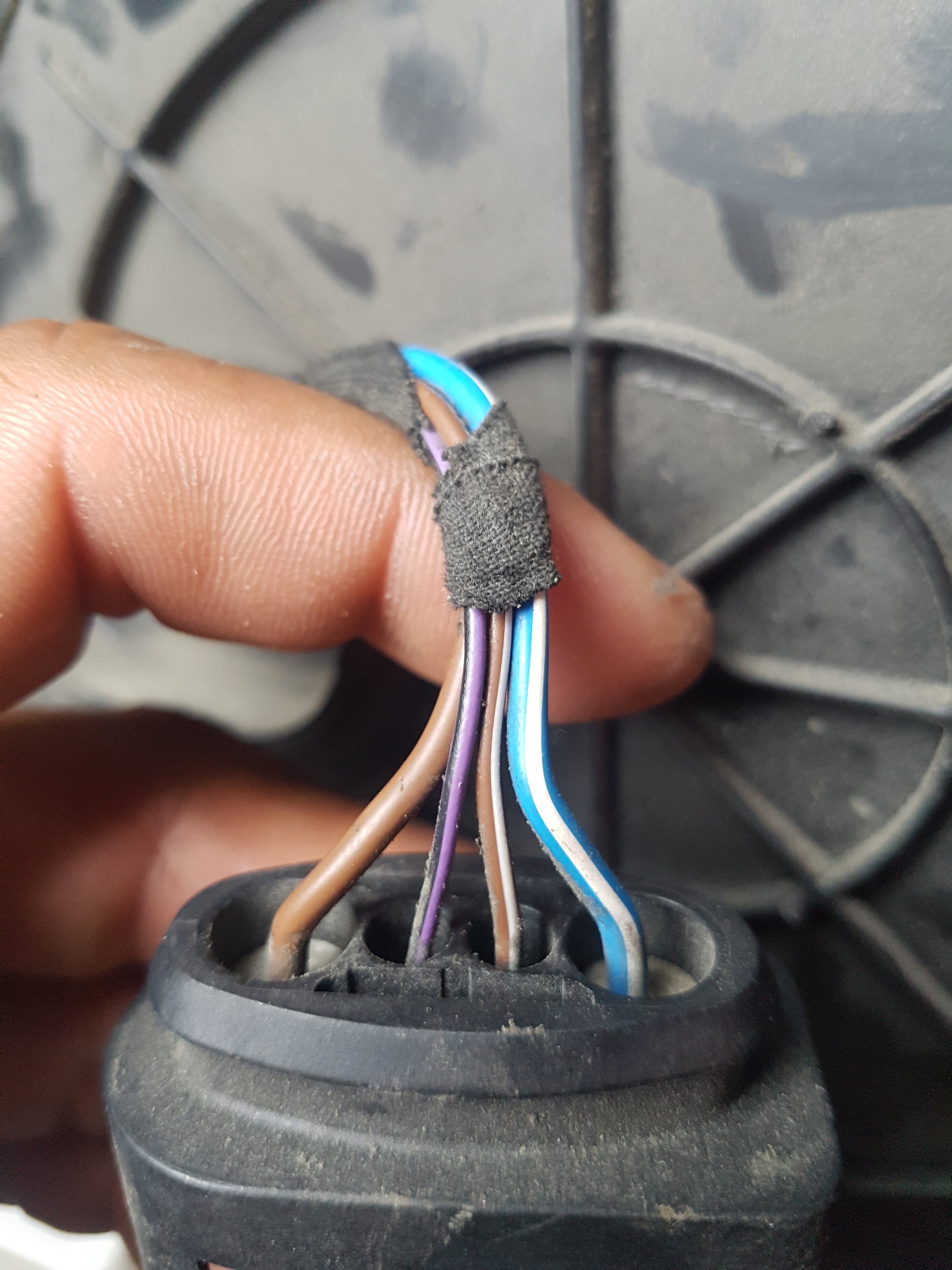

When I try to start the car, I cannot hear any sound from the fuel pump. I guess it's lack of power. Can anyone tell me what these wires are? I was thinking of trying to ein the fuel pump directly from the battery just to test. But need to know where to hook up the wires.
  • Sponsor
Brown negative, blue/white positive.
