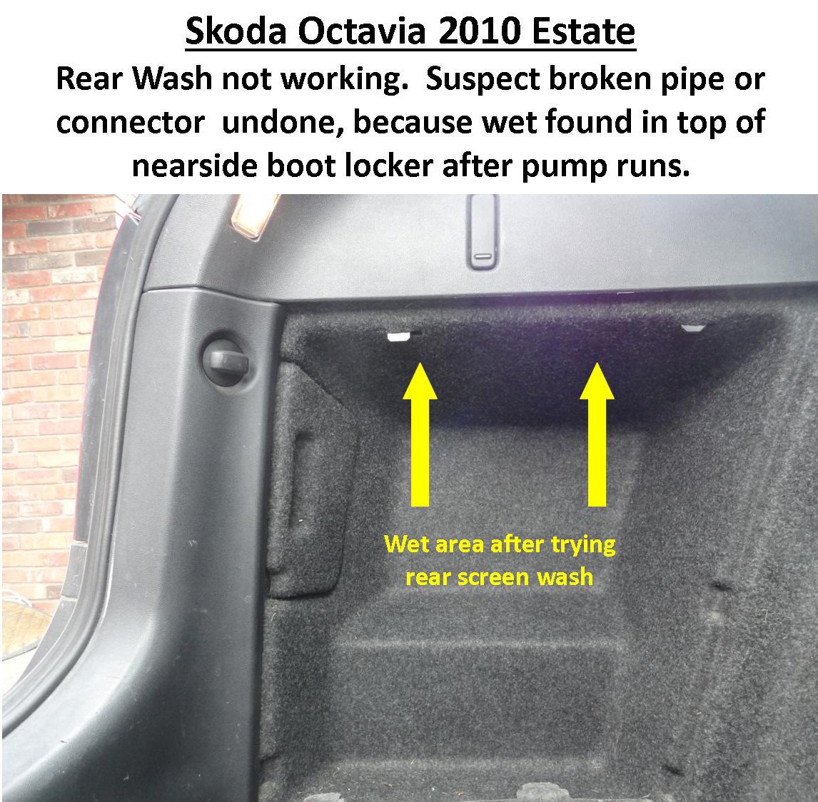

I have a 2010 Octavia estate, last week the rear wash stopped producing water to the rear screen.  The pump is running, but no water.  After a little fiddling about I’ve discovered that the top of the inside of nearside locker in the back of the estate becomes wet.  See Photo.

  1. Am I right in hoping that there’s a connector that’s probably come undone above the nearside locker, given that it’s the top of that locker that gets wet after trying the rear wash?

There are several joints held together by plastic connectors, they're the same on both the hatchback and estate i.e. weak and brittle over time.
The wet boot carpet confirms that each time you operate the rear wash you're filling the boot with screen wash.
So yes, a failed connector is highly likely to be the probable cause and yes the boot side carpet needs removing to properly access and repair the connector.
There will be some subtle differences with the way the carpet is fixed between the hatch and estate, but they'll also be a lot of similarities. Buy yourself some trim removal tools...
