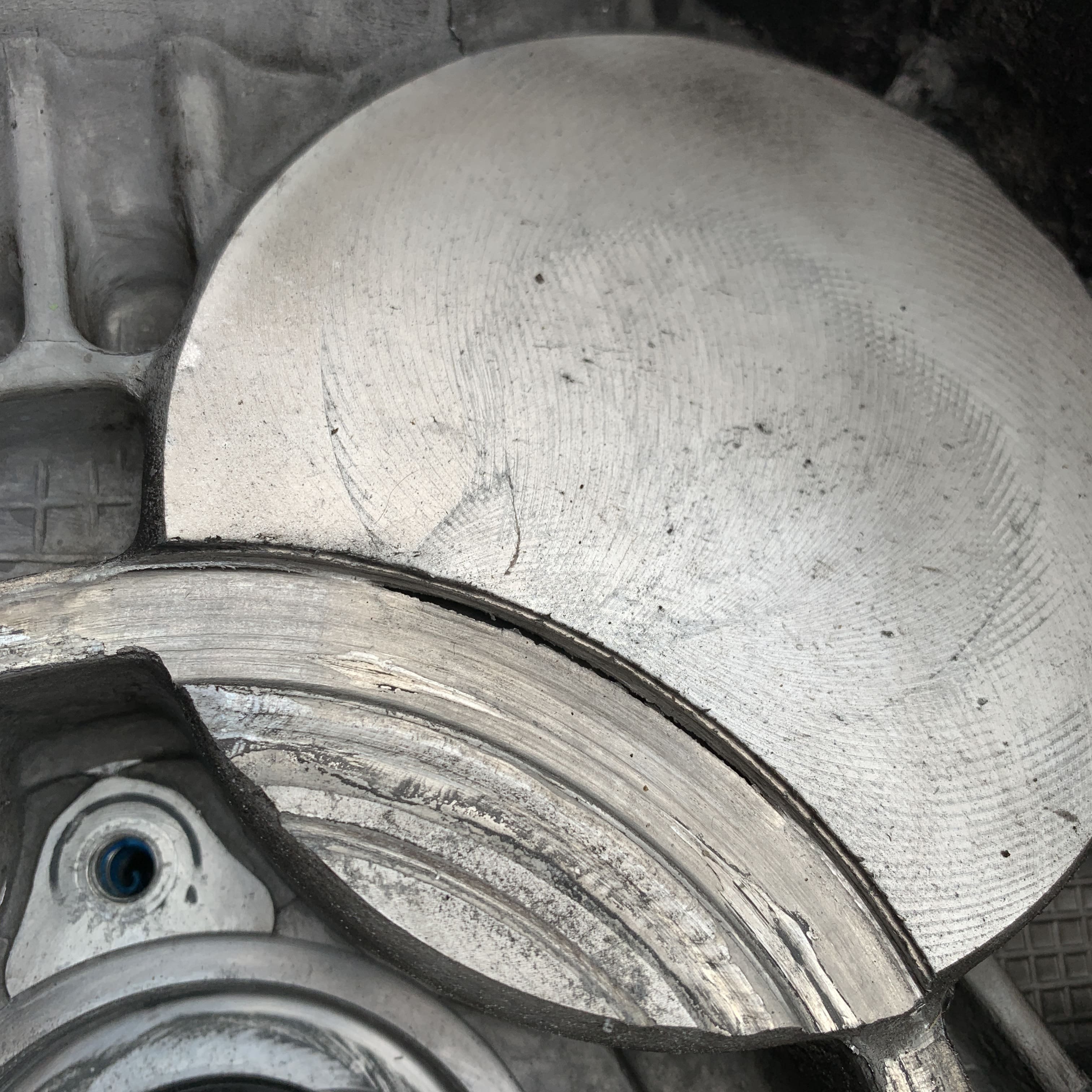

Basically, the clutch ring broke, and over time wore a hole into the gearbox, which then basically leaked all it's oil.

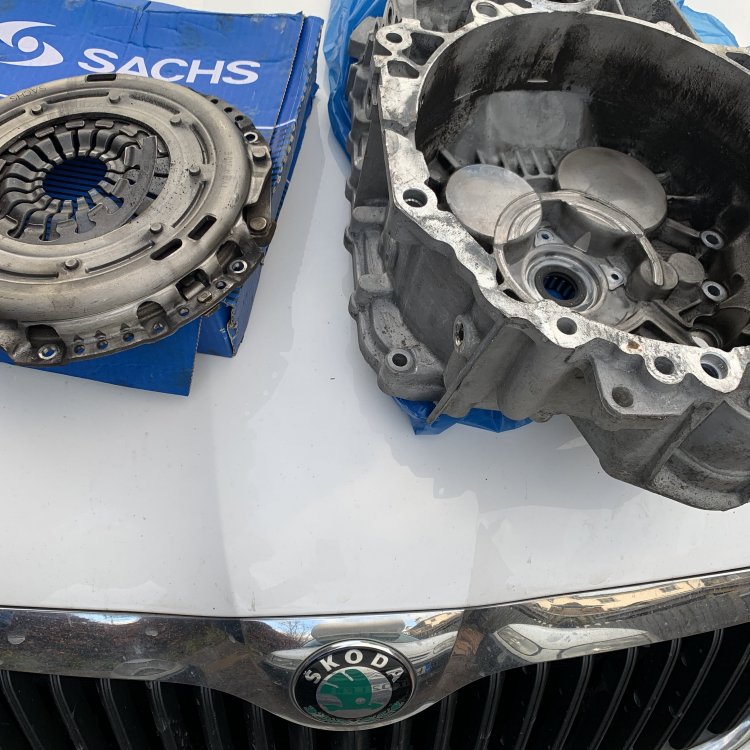

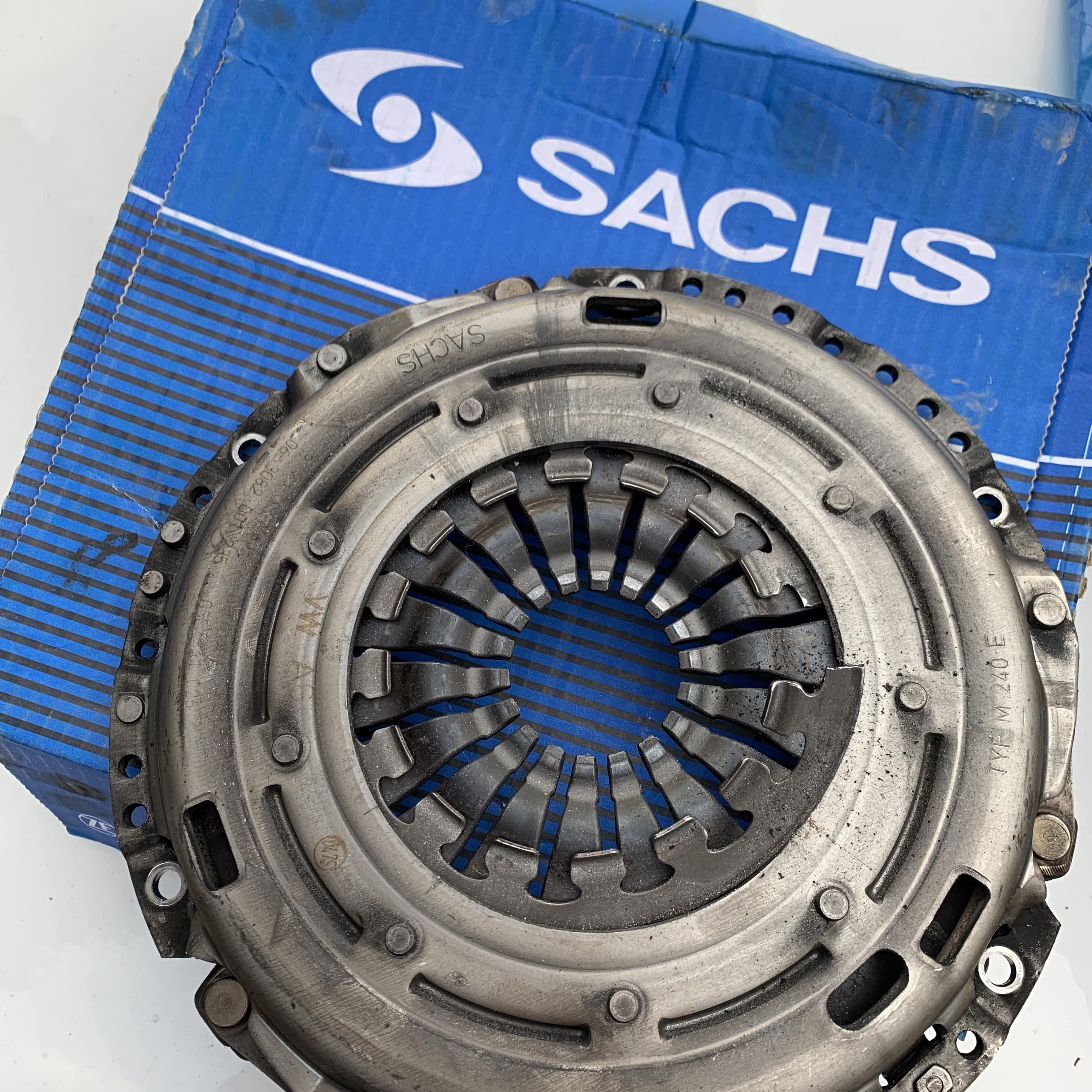

broken clutch ring - the garage thankfully told me the new Sachs part does not have this "necessary" ring on it.
You can see where the metal has been wearing away at the softer metal of the gearbox (look top right of the circle for the hole).

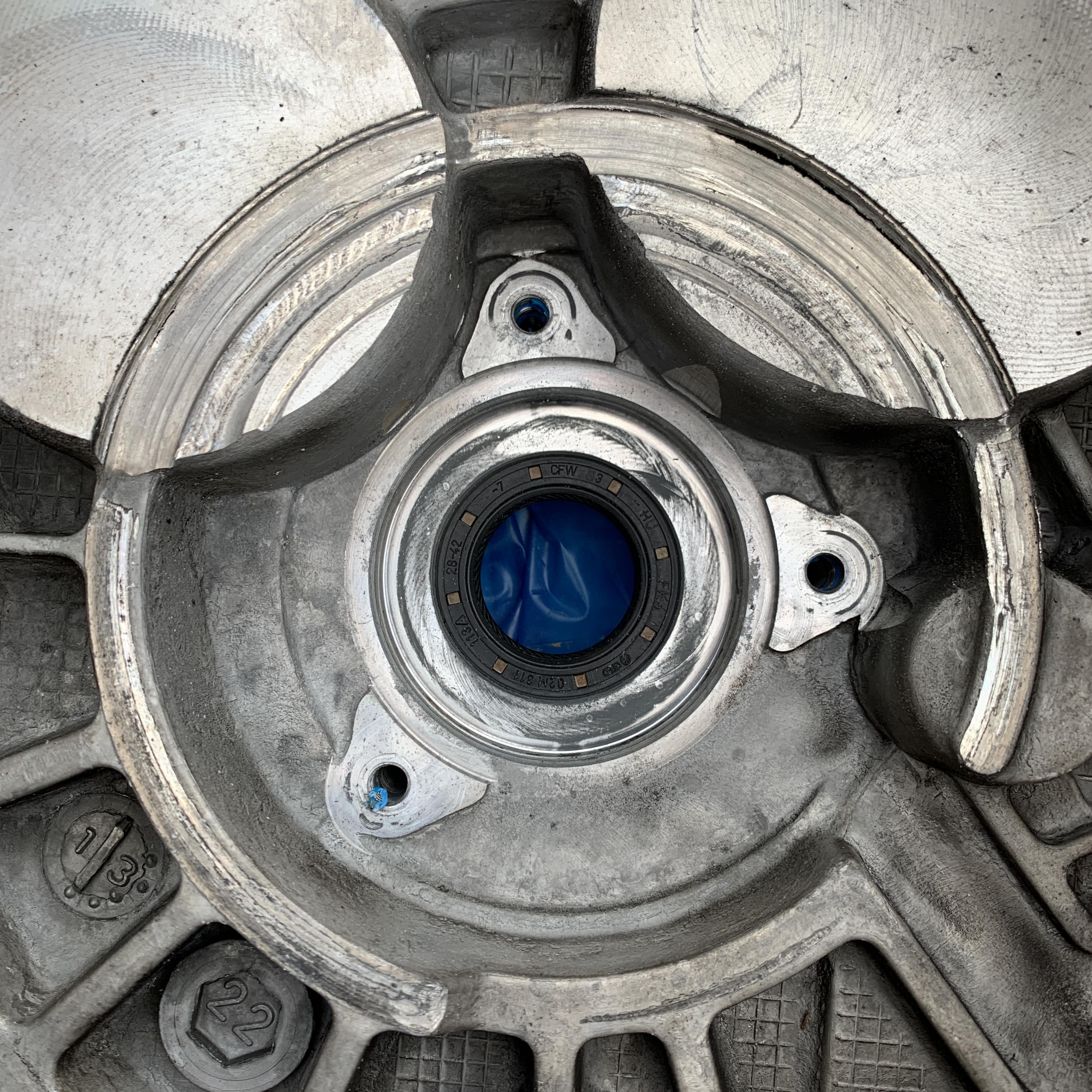

Close up top right.
Artistic shot of the damaged parts at that SKODA badge.

Common and known quality issue with Sachs clutches on 2.0tdi iirc
Yep, exactly the same issue with mine a few years back, about a year out of warranty IIRC.  Clutch ring disintegrated, and a hole punched in the gearbox casing (causing oil leak onto hot bits).  The broken bits also bored throught he clutch slave cylinder.   I managed to get the gearbox casing welded up, and a new clutch, flywheel, slave cylinder and a lot of work.  It was a big bill.
Skoda were ultimately useless.  They refused to do anything at all because I had the car recovered to a local garage, and not the nearest dealer (30 miles away).  The fault was as clear a case of metal fatigue as I have seen outside of textbooks, and despite this, Skoda still did the slopey-shoulder thing.  Apparently the correct course of action for me should have been to have the car recovered to the dealer (at my cost) who would diagnose (again at my cost), and repair (at my cost) and only then would Skoda UK "consider" whether there was a case for a good will payment.   The estimated bill from the dealer would have been >£6k.   Actual cost to me at local indy garage was in the region of £1k.
