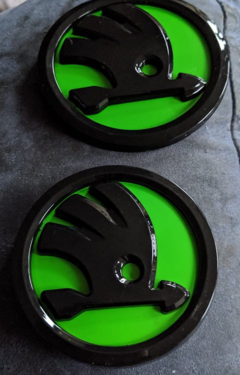

Has anyone tried replacing the old enamel badges with the new silver ones?
Yeah I replaced mine.easy to do with a heat gun/ hair dryer and some dental floss
Which badges did you buy? The Mk3 Fabia ones?
Not sure  what mk was the front ones location pins were different ( had to melt them off ) but the adhesive pad stick very well got them off eBay just mind that the front ones are different size from the back 90/80 mm think
90 & 80mm as mentioned, They sell colour coded and black on Ebay, Again all from china and doubled and price when listed on uk ebay.
If you don’t mind waiting a few weeks on delivery get them from AliExpress Here.
I bought newer ones from eBay and sprayed them black, This was before they ready available as it only used to be superskoda who sold them for a daft price.

Did you get MK3 badges as amusedmussel was asking? and did you have to do any mods to get them to fit as me👍
Sorry, the ones I bought were listed as 80mm/90mm only.I had to heat the front badge and bend it slightly to fit but all was good from what I can remember.
Fishing gut, An old rag and a plastic pry took to remove the originals and a lot of Auto Glym tar & bug remover to clean off the old ****.

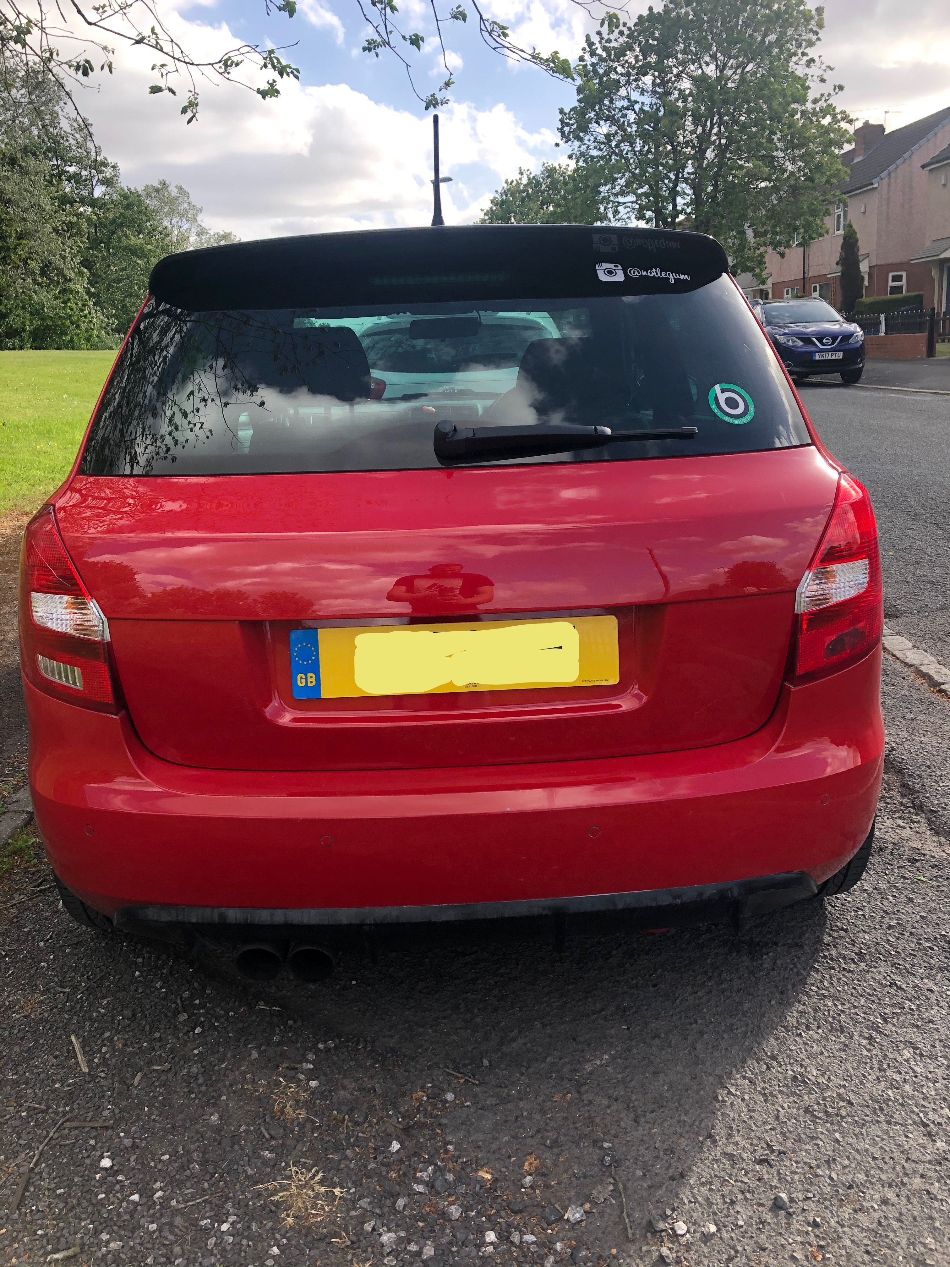

Get the back one filled in, looks much better 👍 then again I only got it filled in because of the rust at the number plate lights.
Edited by LGM
somethings missing there!!!.............😉
