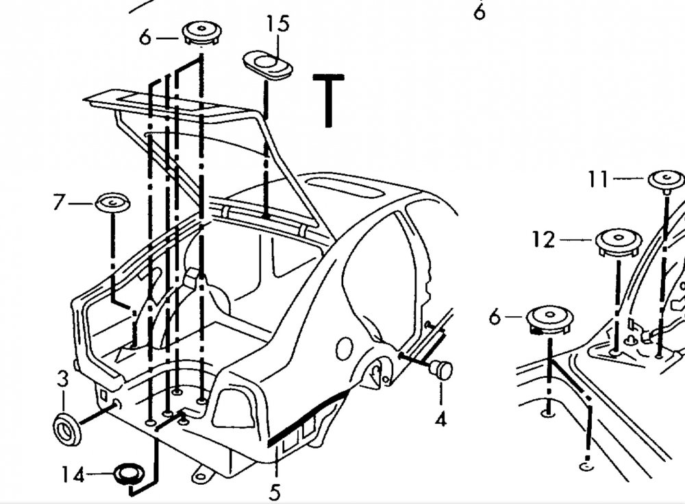

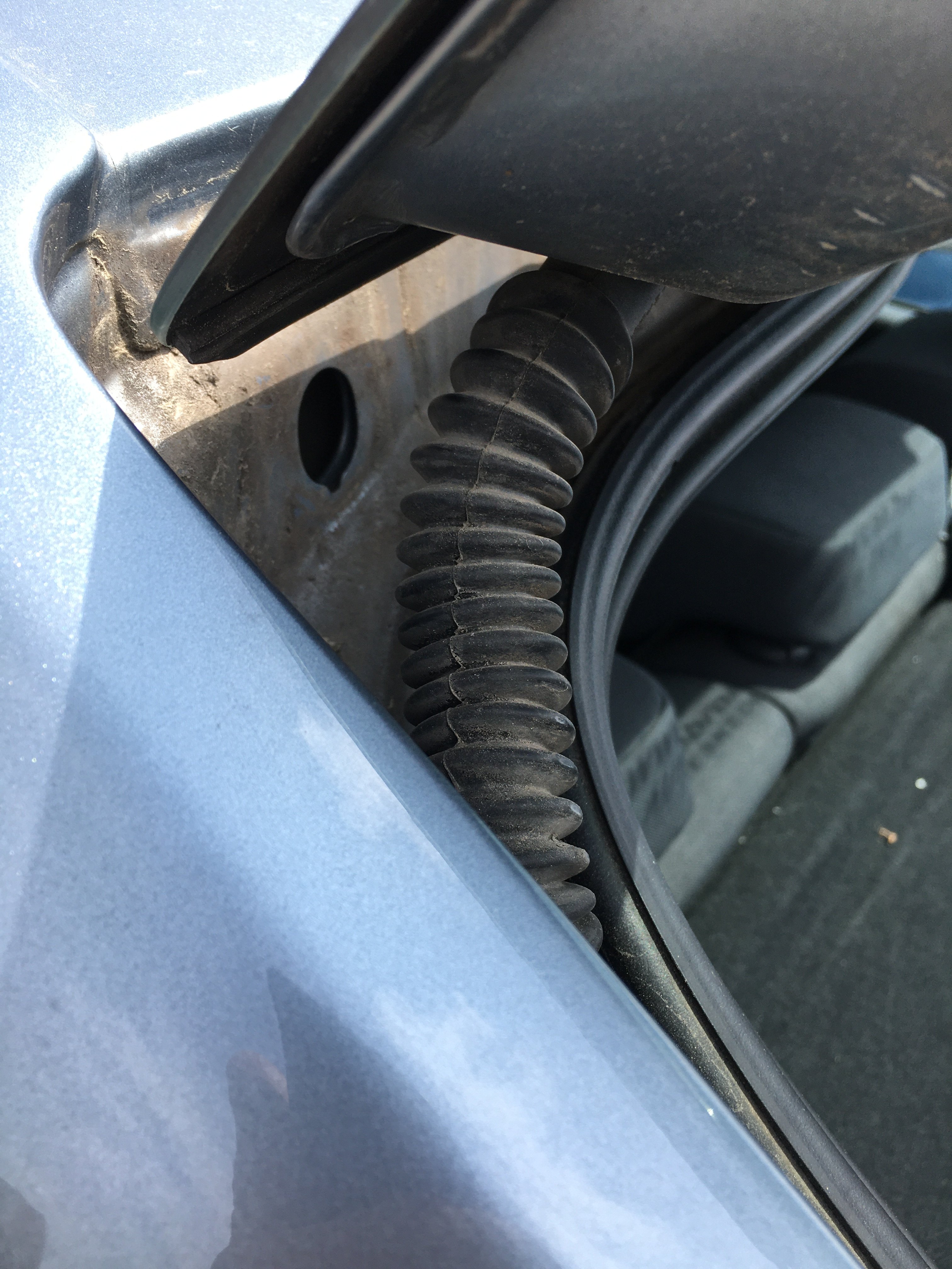

could somebody please help what is the part number or name of the missing plastic “cap” in the picture? Behind the rear door. Octavia MKII pre facelift hatchback.
I was not able to find in ETKA
thanks in advance

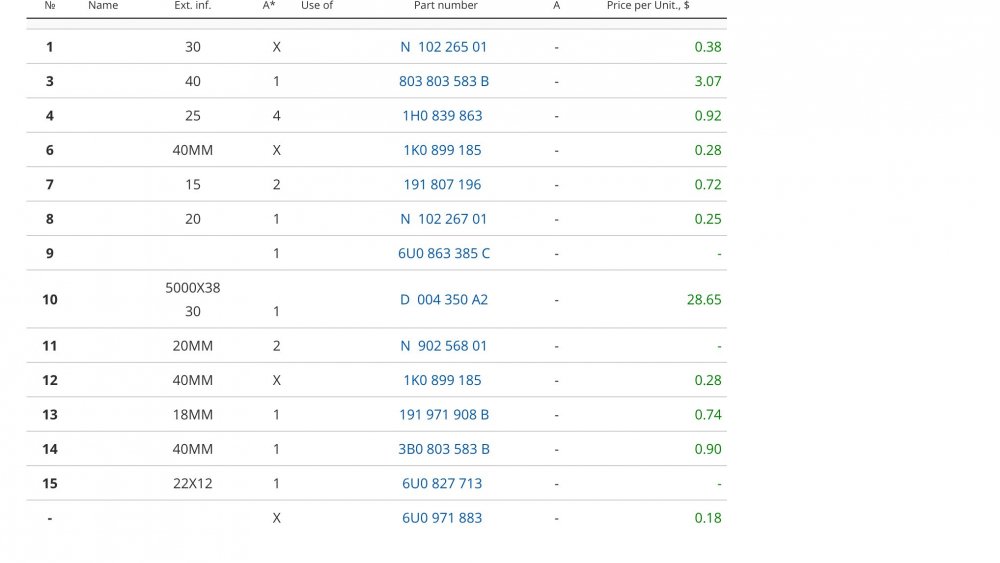

Is it number 15 in the attached pictures. No idea what the last one, without the number is though lol.

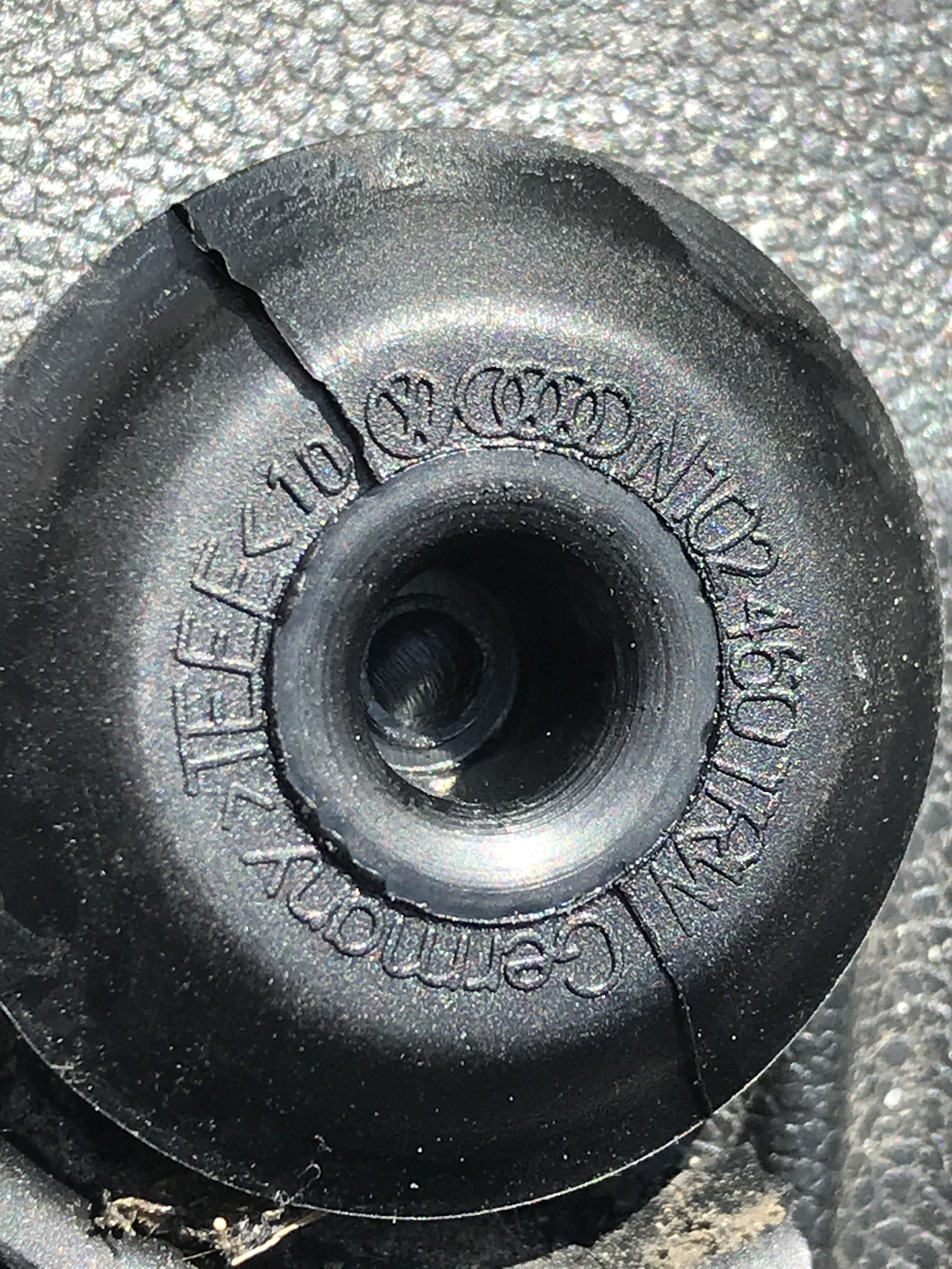

This is the part. I replaced both mine last year. About 90 pence each I think.
