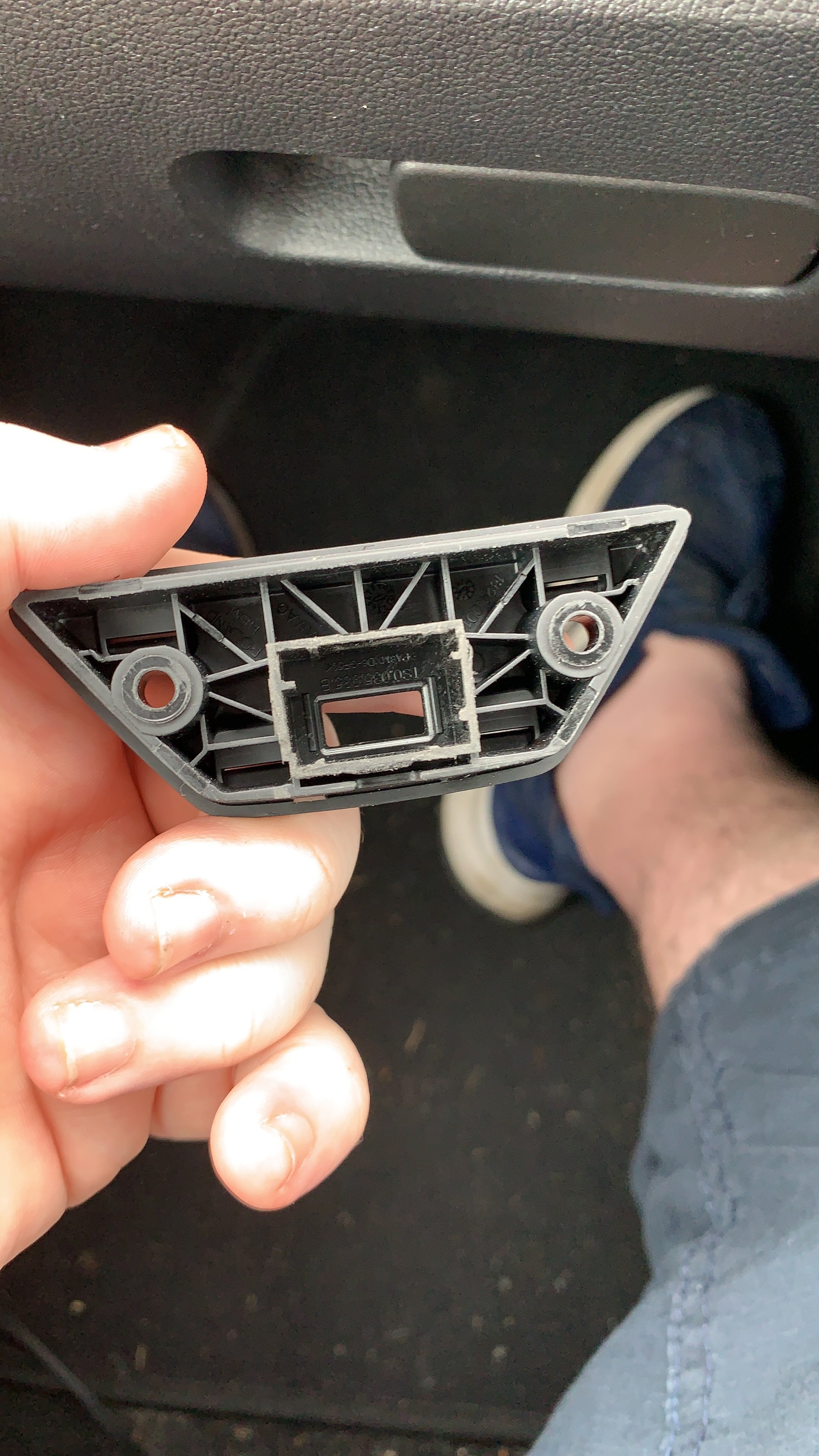

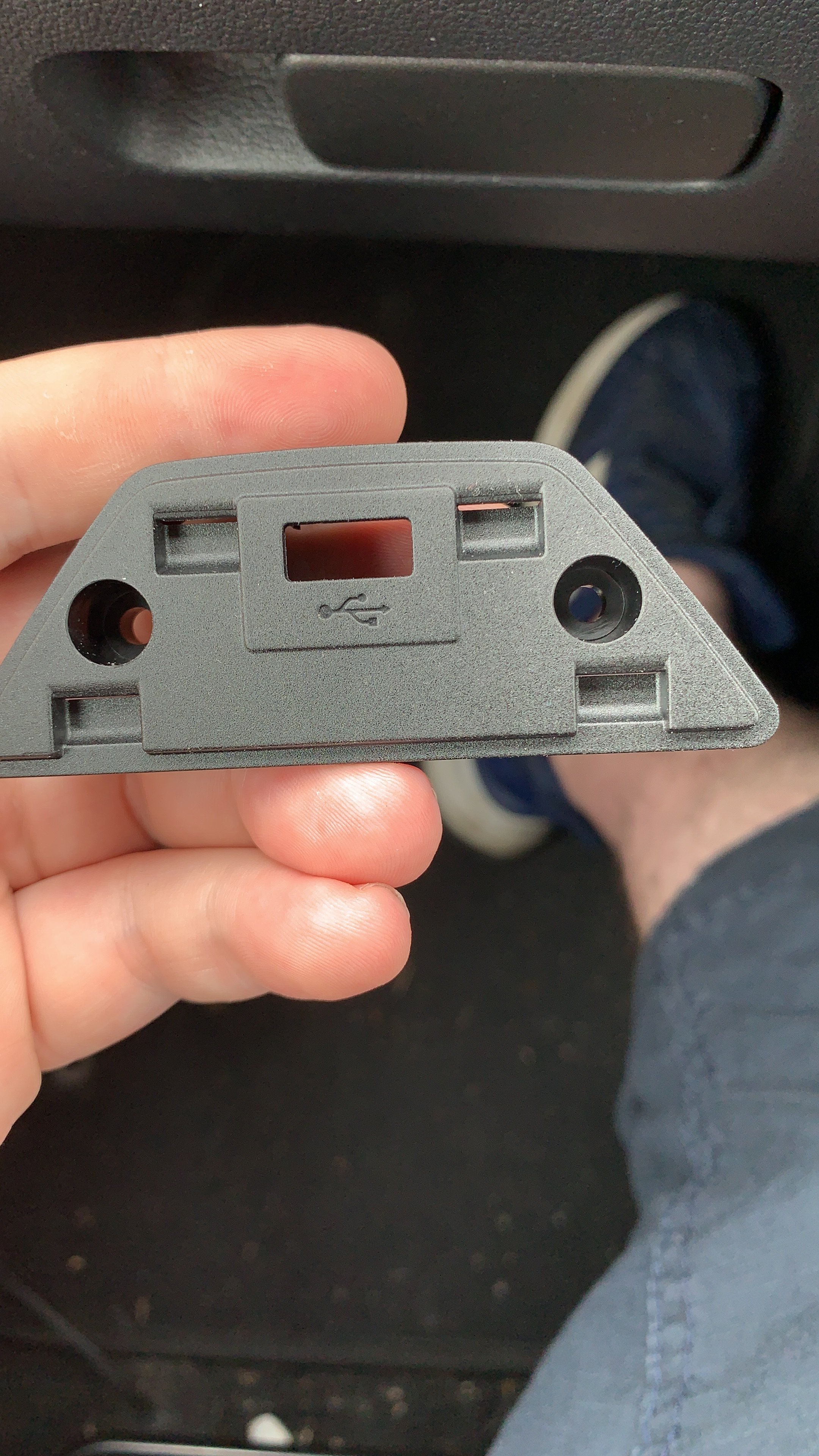

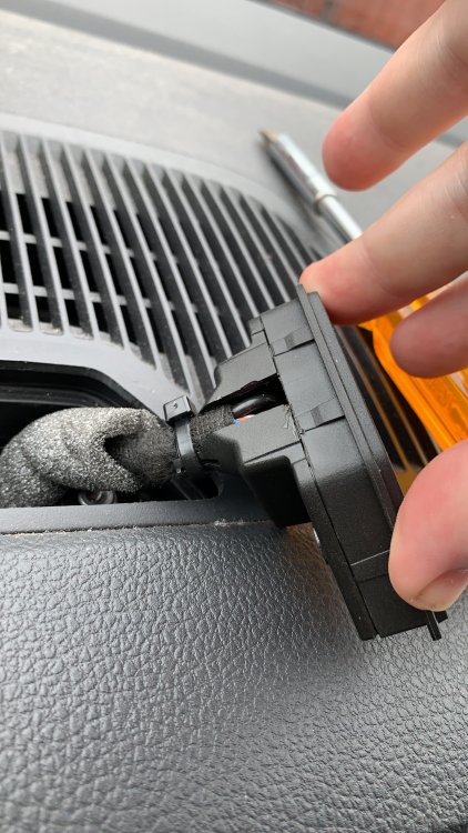

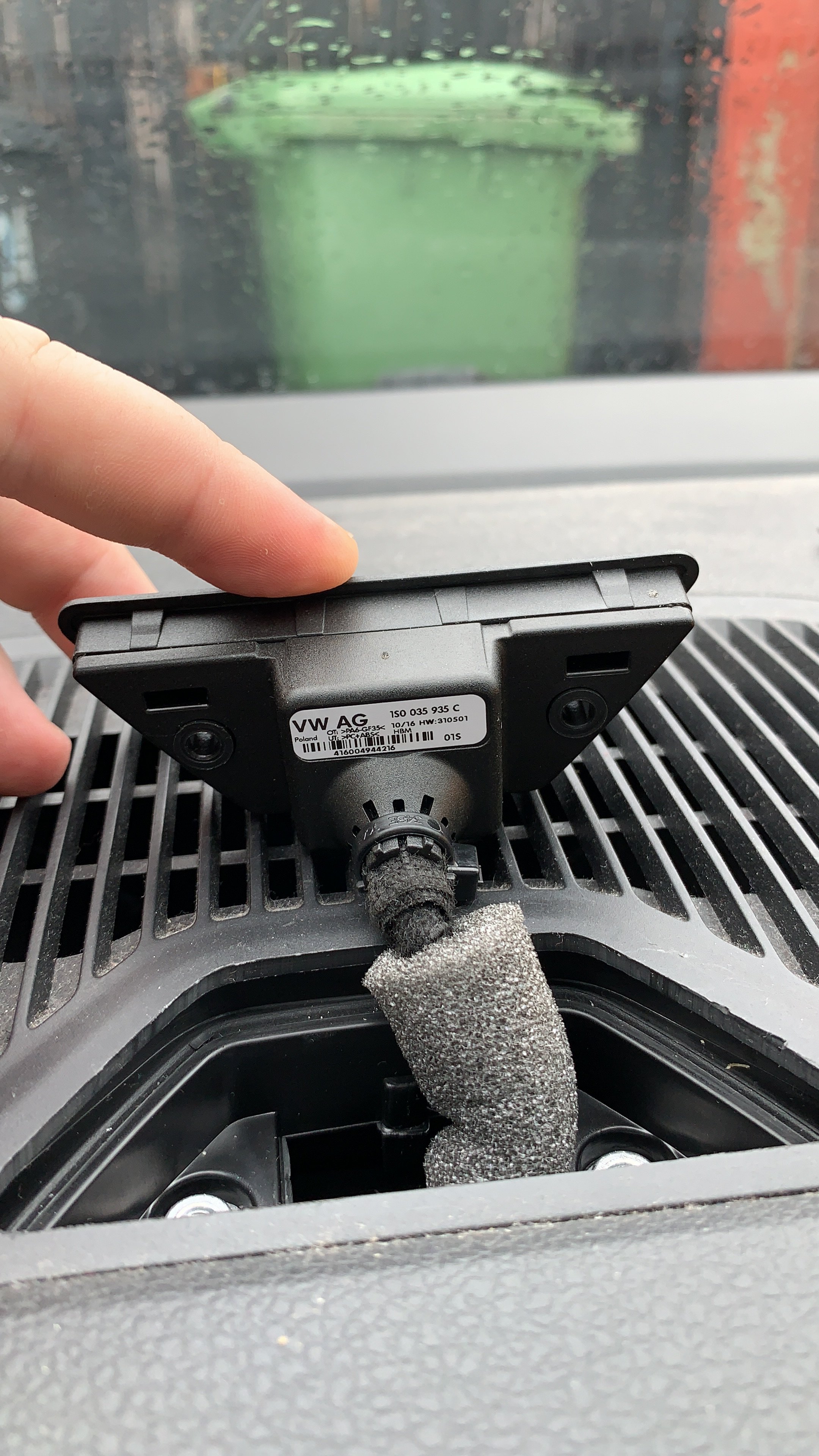

I have a 2016 Skoda Citigo & it has the GPS/Sat Nav dash mount. I recently purchased a replacement fitting so I could swap to the mobile phone mount but am having trouble replacing it. Does anyone have any advice?
I have attached pictures of my progress.

On the original connection, there seem to be a connector similar to an antenna/aerial plug (FAKRA type)
Oh, and what you are showing on the photos is only a backing plate. There is no plug/connector nor the wiring, which is different on face lift models.
original wiring from pre-facelift PID holder wont fit - sadly.

Top blanking plate, top view with USB port in place HERE
Top blanking plate, side view, with USB port P/N visible and VAG USB plug/wires HERE
