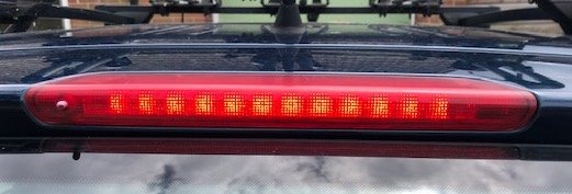

Just a quick question. I have a 62 Octavia Estate (Elegance). Can anybody please tell me how many LEDs should be illuminated in the high-level brake light strip?
I am seeing 12 LEDs light up, but it looks like there should be 14. See the attached photo for details.
Many thanks.
12 is correct.
Twenty twelve according to Diane who knows about these things.
Thanks. The reason I ask is that I have an intermittent bulb warning light and the garage tells me it's an intermittent fault with the LED brake light unit.
I'm not sure if your high level light is monitored, certainly on a 2006 it isn't, having noticed mine had failed and required repair.
Unless you see the results of a scan I'd suspect a dying incandescent bulb or dodgy bulb connection, just remove, clean contacts and replace and see if there's further issue.
Current consumed by the LED array is probably too low for the volt drop monitoring system, I would be very surprised if it were to react to the failure of one LED unless it was shorted, I'm with MicMac on this one.
Thanks. I’ll query this again with the garage before going any further.
My car doesn't tell me which bulb has failed, but I use the Carista app through the diagnostic port to tell me which one. Never fails. Other apps are available.
