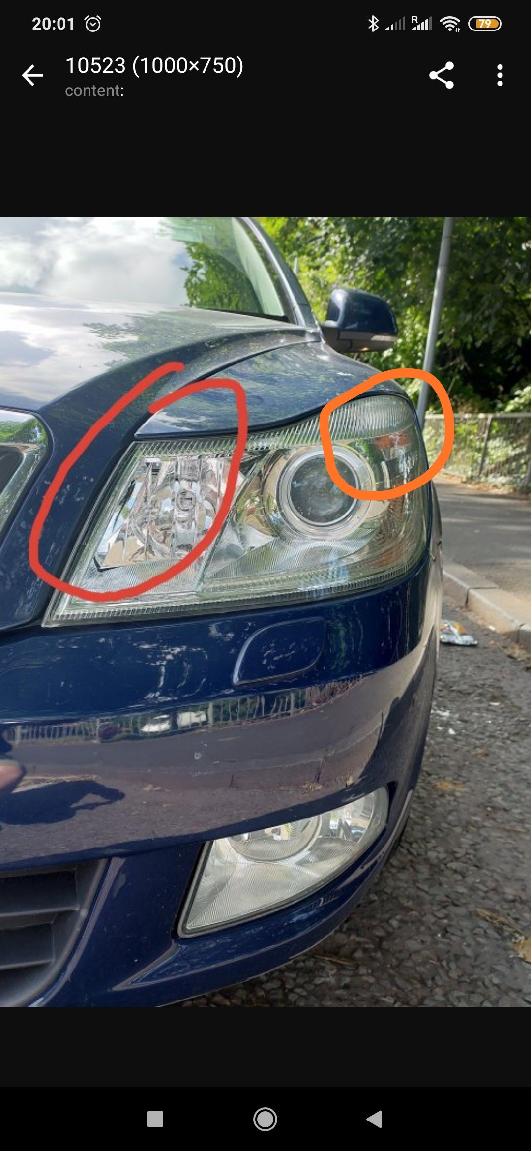

Since English isn't my main language, I'll upload a picture where I indicated with red the bulb that needs changing.
I have a H1 bulb in there at the moment.
Isn't that the main beam?
The parking light is to the right in your picture above the round dipped beam lense.

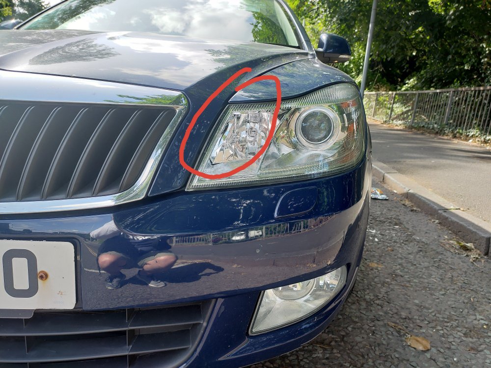

Here is where my sidelights / parking lights are on my FL.

I don't have a vRS. My lights are the same as yours.
The H1 is the main beam (comes on when you pull or push the indicator stalk).
But like I said the parking / sidelights are where I indicated. And they are a small W5W bulb.

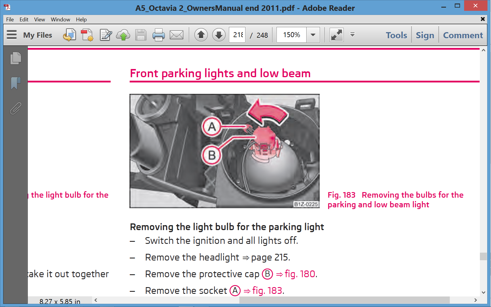

You don't say what year car you have but here is an extract from my 2012 car's handbook that shows the position of the side light bulb in the headlight at A.
2012 models came with DRLs fitted but not commissioned (confusingly called activated in some texts). I used the Carista app to do this and then activated them using the left stalk as shown in the Owner's Manual. (If you don't have one then you can download it from the pinned thread at the top of this forum)
