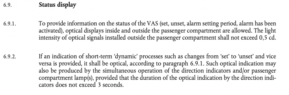

I suspect that Skoda realised the option should never have been there on EU cars. I was always surprised the option was there given the ECE rule is 'no chirp'. I reckon they thought it was OK to have it leave the factory off but allow the owner to change it. But maybe now someone has told them 'actually the rules say you can't even have the option to enable it'. I know at least one other VAG brand never had the option to switch it on for EU cars (for the same reason).

@lowedb   When did this EU Legislation come into being and what does it say?,
as brand new cars now still can arrive into the UK with a chirp from locking them or activating the alarm.
It's not new legislation. It's been around for years. The document I found easily was from 2008.
It's regulation ECE 97.01. The specific paragraph is attached. The significant part is that any signal SHALL (my emphasis) be optical. In other words shall not be audible. So technically, cars cannot arrive with a chirp from an approved alarm system that is part of the type approval.
