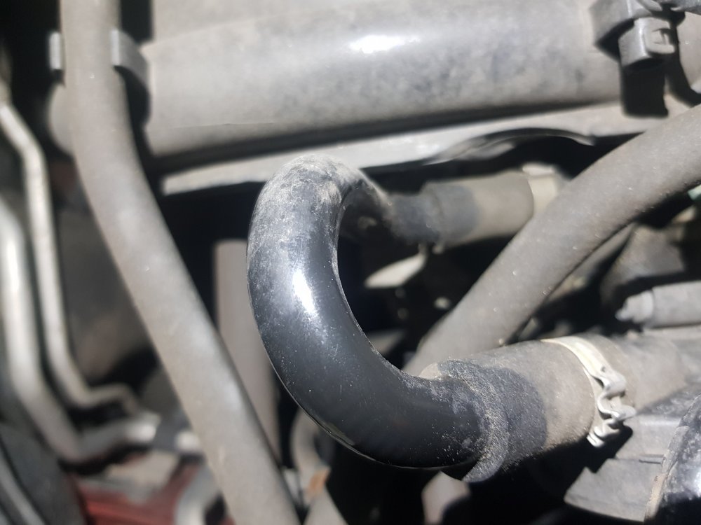

I have a silly question. Is the loop that goes into the pcv supposed to come out easily?

The hard plastic loop of the PCV pipework  is just a push-fit into the rubber couplers at each end, so will move in/out without huge effort. If it was loose enough to leak, I think you'd hear hissing when wiggling it about. Add a cable-tie or two to snug it down if it seems too loose?

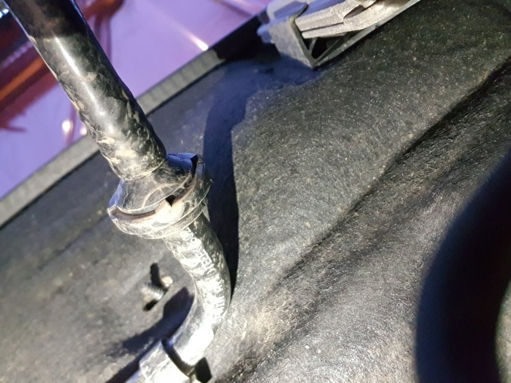

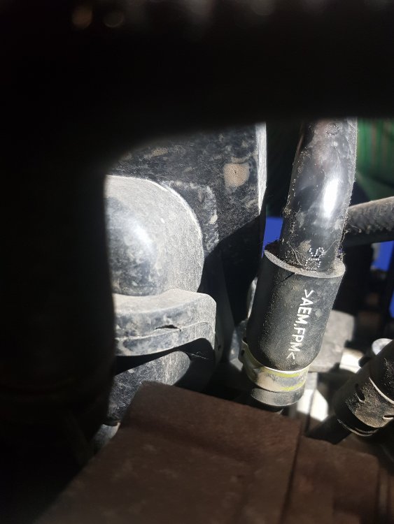

Wondering if the crack in the first pic might be to blame on the intake (left of hose and clamp).. or that notch in the 2nd pic on the intake (top of 2nd pic, slightly right of hose). Small gap but will try and get a better pic tomorrow.
This picture is looking up on the drivers side(rhd) looking up . Left is the intake manifold and right is the pcv pipe
This picture is on the driver's side (rhd) looking down on the pcv side to the rear of the engine.

Next steps in the diagnosis process is to take VCDS and check a few figures before and after zip tying the PCV pipes.
The cracks/separation on the intake manifold are looking mostly superficial. Holding fingers over them (or trying anyway) I couldn't feel any draft.
