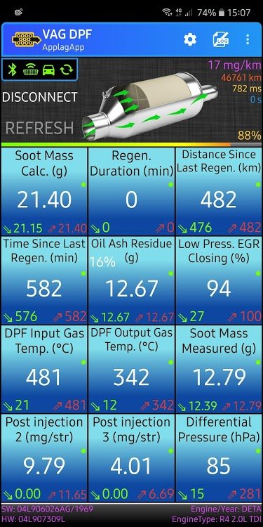

The easiest way is to use the android + vagdpf application .. regeneration is almost always systematic. I always have mine every 200 miles. I use this application and I see when I have 95% I am going to drive on the highway to regenerate it. It is simple. the filter has its capacity on the soot. at 25grams in the filter starts regeneration. always after it is about 5-6 grams.
vagdpf on android with vgate obd bluetooth
