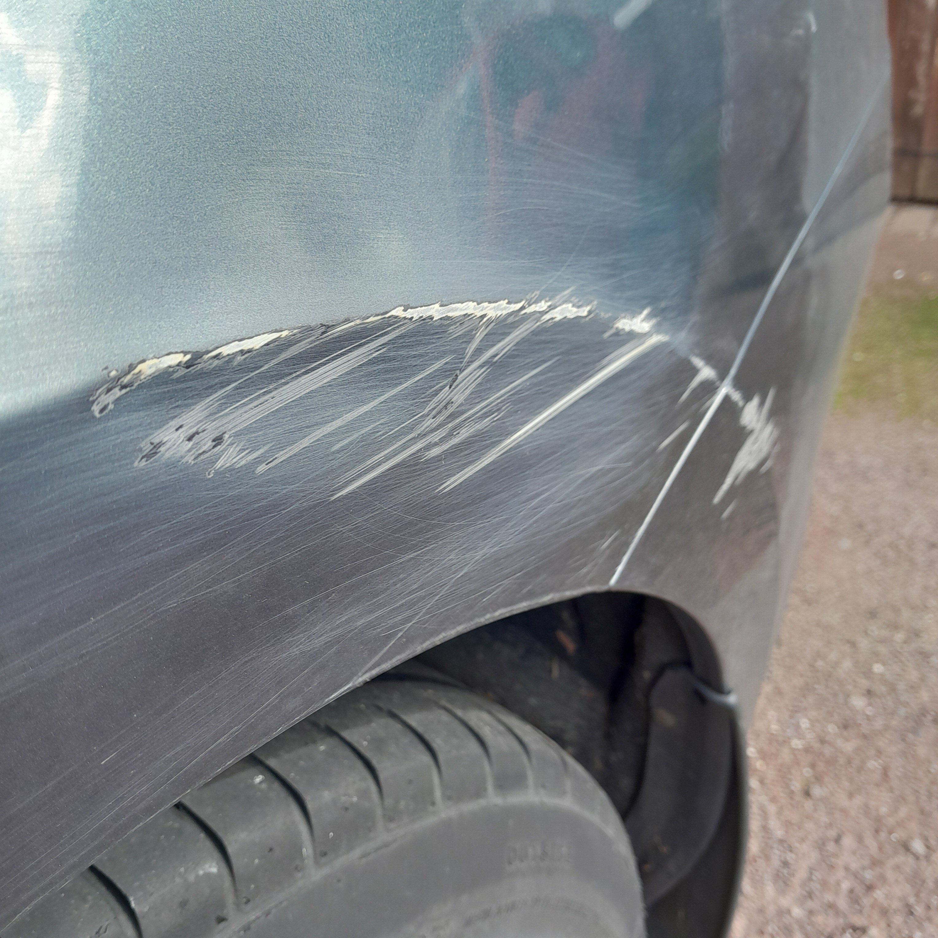

  7. Hmm, the wife doesn't want/trust the DIY route and I've yet to visit a body shop for quotes. The reason I was entertaining the DIY was I've a few other minor blemishes which could do with a touch up so a can of matching paint like from here .. https://www.paintnuts.co.uk/category/colour-matched-paint would suffice for those but not sure how "matching" they would be? Thanks a bunch lads and I'll let y'all know the outcome. NB there is a slight dint in the wheel arch and was wondering about trying to knock that out myself....
  8. Hi, couldn't find what I was looking for on search but this subject may not be model specific. anyway. I was unfortunate enough to scrape a stone wall with my rear nearside wheel arch and its taken the paint off down to the white undercoat on a few scratches and was looking to get it 'sorted'. Q 1 - would you go with a professional body shop or just buy a can of spray paint to go over the scratches. Q 2. If its the latter, has anyone used an online paint mixer/supplier and are they a great match? You will note that the edge of the rear plastic bumper has also been effected anyone with some experience in "smoothing that out" before applying paint would also be appreciated. I thought I could sus out the colour code from the vehicle data sticker but not too sure as mine looks different to what I've found on here. Thanks
