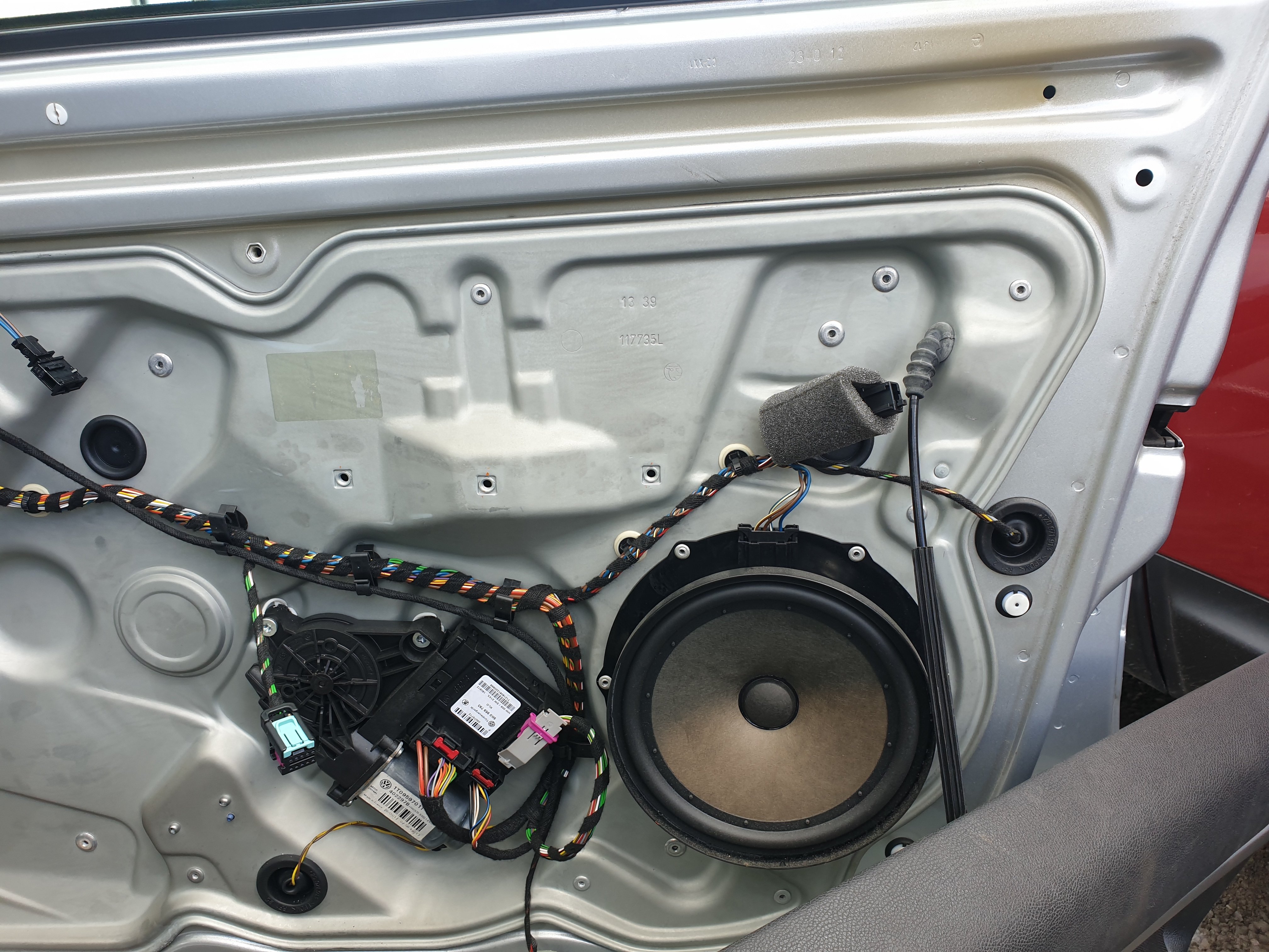

thanks mate, there is a secondry panel in the way of accessing the door lock mechanism that is riveted in, here is a pic..
oh, on mine, there is a foam for soundproofing and if i rip that off then the mechanism comes out from that hole.

another way is to take the panel off, have you got a rivot gun?
I tried drilling one of the many rivets out mate, it took some time but finally went, however there are quite a few and I gon't know if there is anything attached to them on the other side of it, as the window and all its gubbins are a part of it on the inner panel,
actually how about just taking the speaker out? the hole looks big enough for the mechansim to come out of there.
this is very similar to my door
IMG-9754-jpg-c55c66c2f7f33148a6c5aad6384
as you can see the grey foamy thingy on the left, that rips off and i can take the mechansim out.
Thanks for the pic mate, I drilled the rivets and took the speaker out, and then took the 2 bolts out of the outer door to undo the mechanism, but there is no way you can see what your fiddling with through the speaker hole, however the mechanism is loose, I imagine its attached by cable to the outer door release handle/door lock, so I imagine the whole secondary panel has got to come off to access it and see what I'm doing...

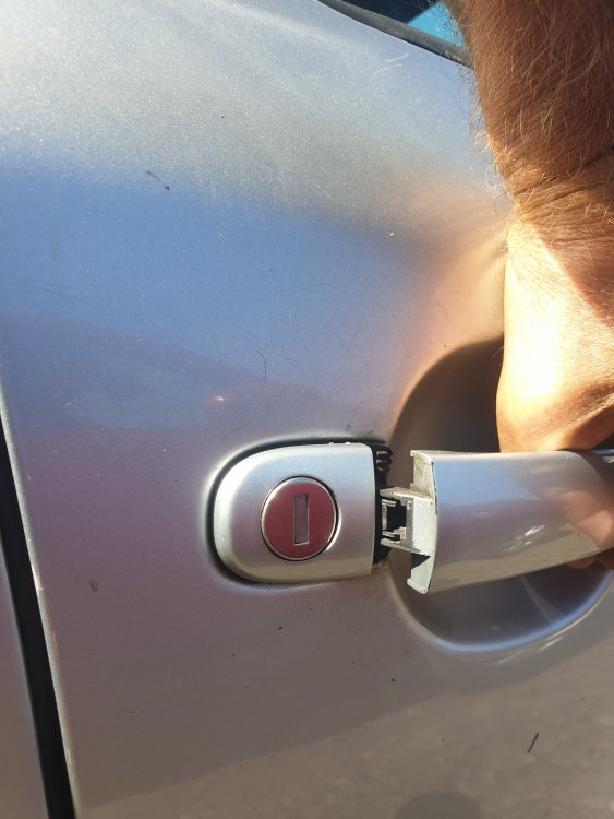

can you try taking teh handle off so you can undo the wire connecting to the mechanism?
I took the plastic surround off around the key holed lock, but I have no idea how it all comes apart or out mate, I'm worried if I bugger it up the door won't close properly and I need the car mon-fri for work,
i have heard its straight forward, will need to get a diagram/manual on the handle part. i can imagine once you can take the handle off then things would be easier.
