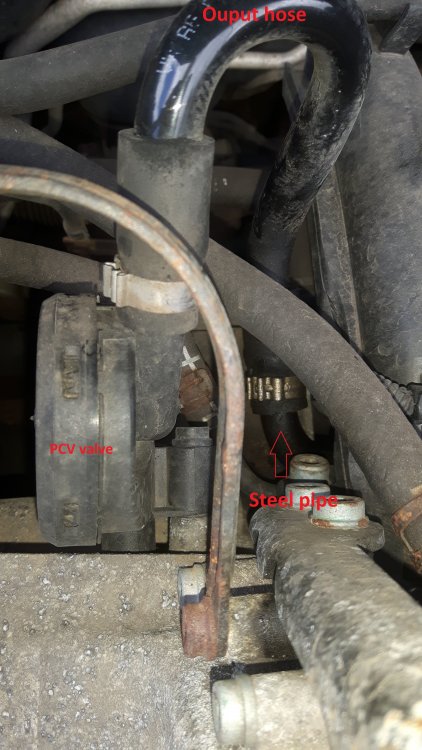

Happened to knock the output hose of the PCV valve as I moved my hand away from the previous test and heard a pronounced hiss/suck sound, accompanied by the engine bogging down.
Aha!

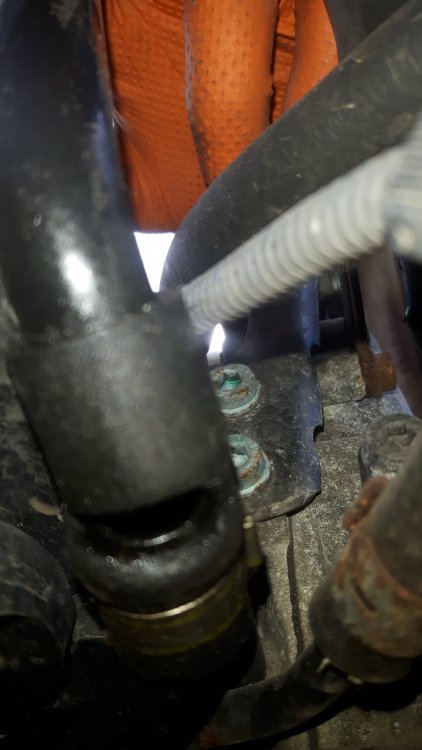

The shiny black plastic hose here is the one I knocked, and subsequent fiddling showed that an upwards knock near the steel pipe end had most effect.
And this is why (hose actively held upwards from its resting position):

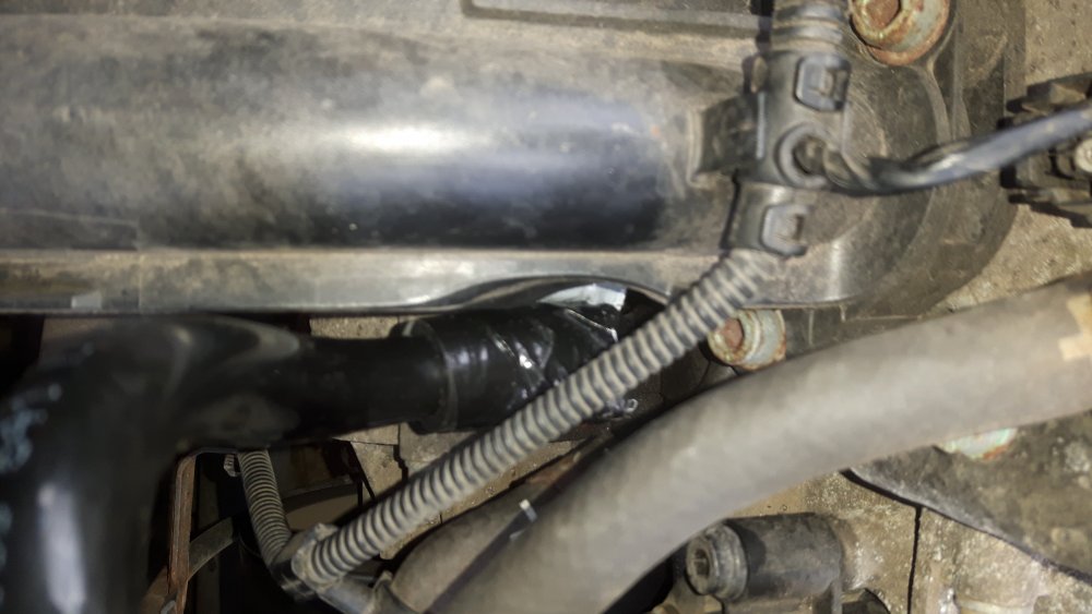

Gaffer-tape temporary repair was enough to prove the point:
The car initially wasn't at all happy at low revs, bogging down badly, but a few minutes running with a few on/offs and it all settled down. No fault codes returned during a short test drive.
