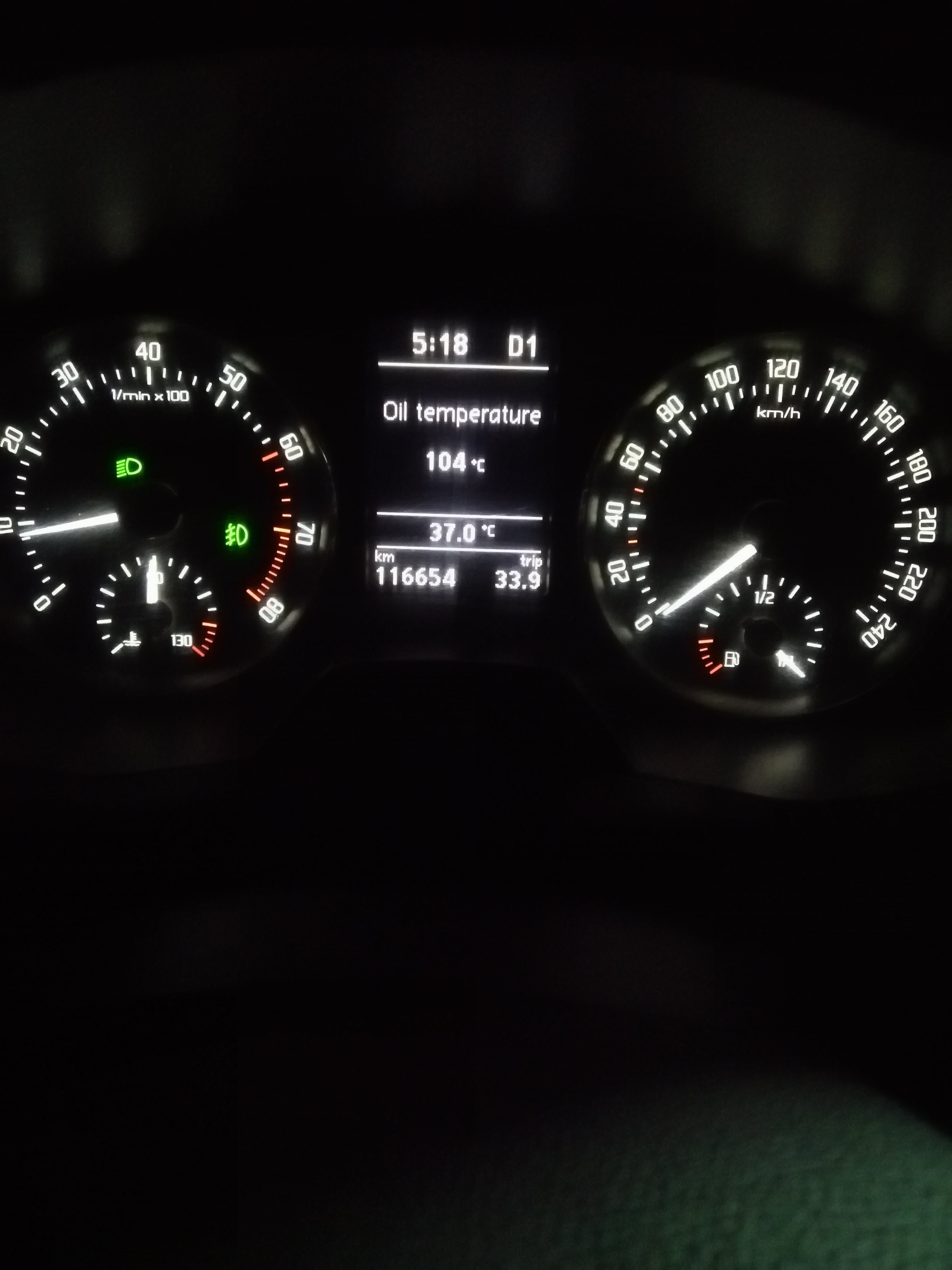

I drive a 2012 fabia monte carlo 1.6cc 16v petrol. I'm having issues with the oil temperature, It runs about 102c° but sometimes reaches about 111c°
Considering that i'm in africa with a daytime temperature around 40-45°c
Is It normal?

Activated On My maxidote
Ah ok, did not realise this was on petrol versions apart from the RS.
Because of your daytime temperatures, the engine is always going to run hotter than they would do in Europe or here in GB for example.
Engine oil optimum temp range is
230- 250° F which is 110 - 120° C
There's nothing to worry about but if it worries you then don't monitor the oil temperature since there is no action you can take and the sensor may not necessarily be very accurate anyway.

Just make sure to do proper oil changes, with the correct grade, at the correct time. Also, keep the coolant fresh. It may need changing more frequently in that climate. Go by the book or check with the local VW/Skoda dealership.
