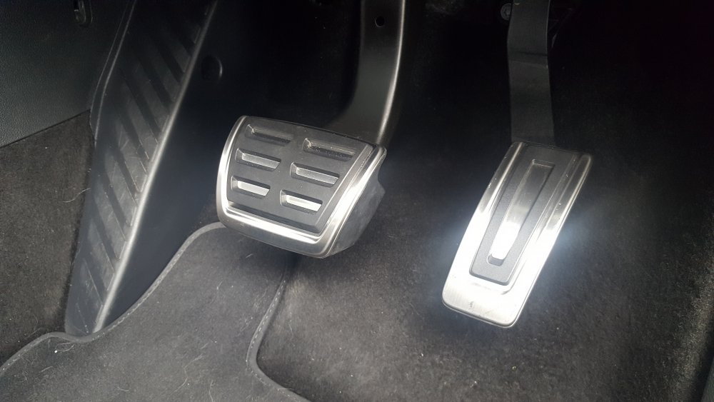

They cost just £28 incl delivery from Germany which is much cheaper than i have found them elsewhere. They look original equipment with part no.s and fit very well.

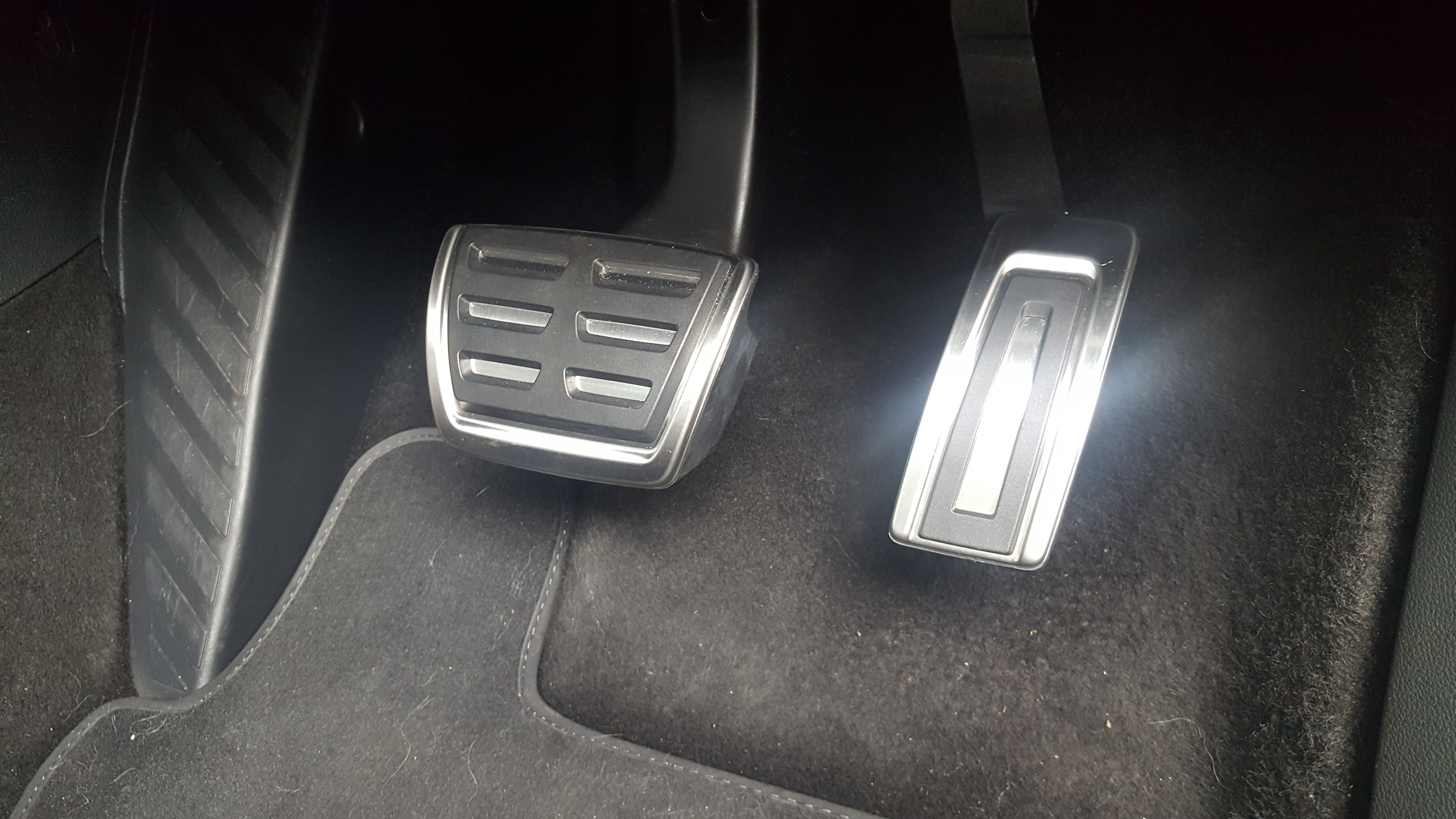

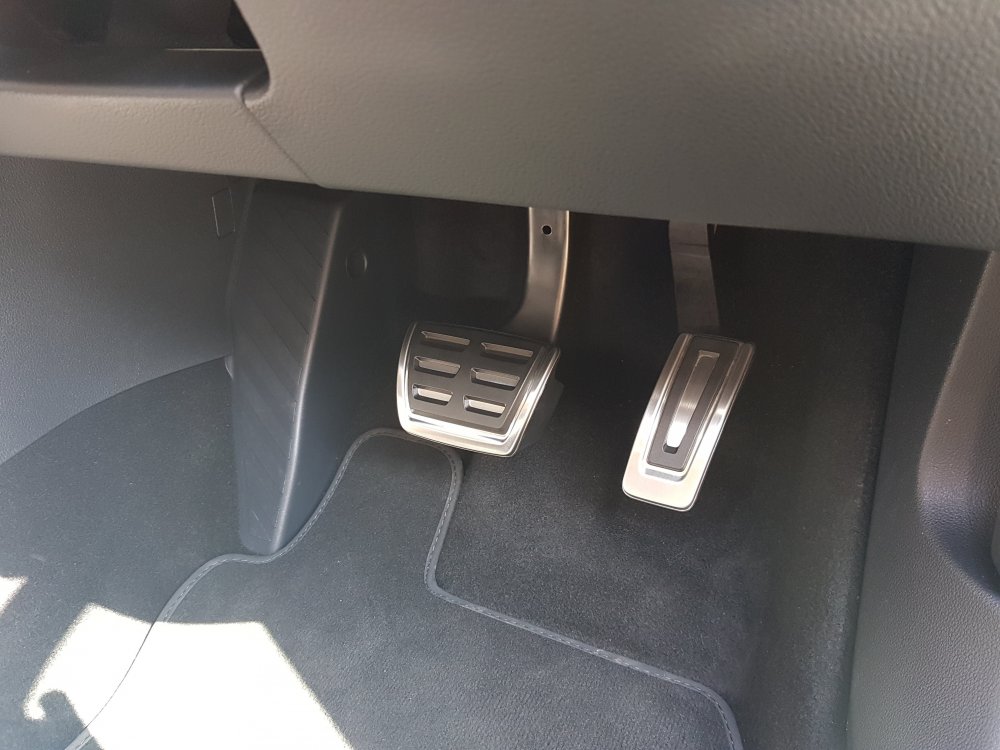

Fitting fairly straight forward brake pedal easy as remove old one and just clip new one on 10 second job. Accelerator a bit more involved as these go over existing pedal and the rubber is tight. I soaked it in hot water (not boiling) for 10 mins worked the rubber a little and it went on fairly easy, slide one side on hook the opposite top corner rubber on and work into place.
Simples, just need to find reasonable priced footrest cover in anyone out there has come across one?
That throttle pedal is upside down just FYI
Cheers ZacDaMan just swapped it around now on correctly!20200716_125621.thumb.jpg.baa5470fc5d6f3d4d54e0bcde16f3c75.jpg

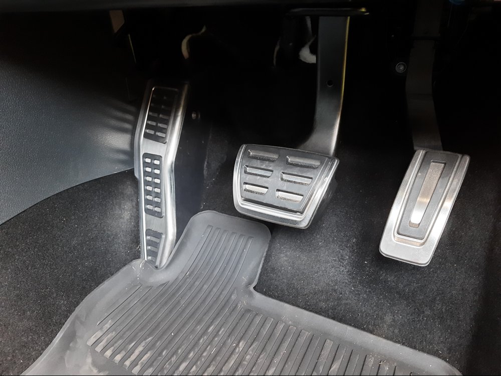

Looks good, wish Skoda made a RHD metal footrest... I'd instantly buy one!
I am sure i have seen them for sale, but you have to buy all three pedals together and they were around £80-£90 so they must be available on their own somewhere!

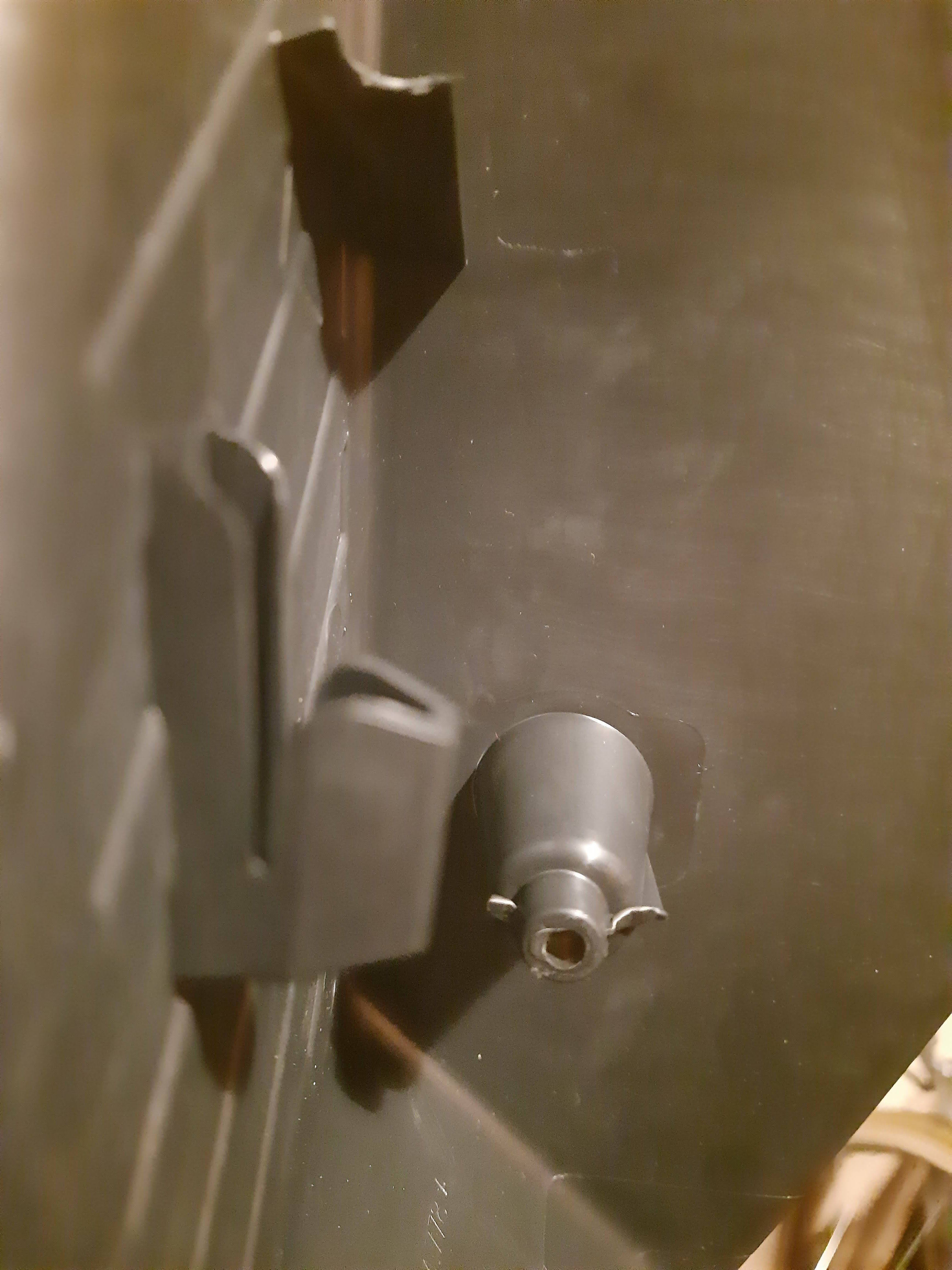

If you do go for one there's two L-shaped clips on the back that slot down over metal retainers. On the Superskoda replacement I found the gap on these clips needed to be widened very slightly to make the fitting easier.
