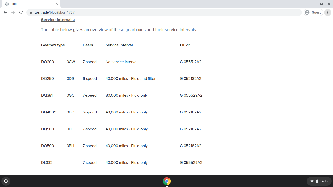

You can change the oil or have it changed if you want,
but if '34H5' has not been carried out then that can be an issue.

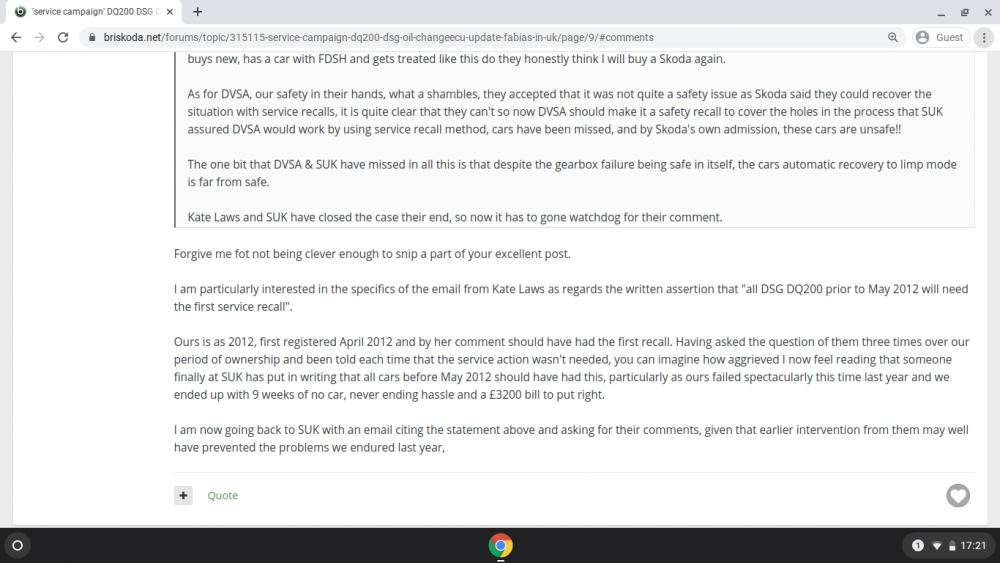

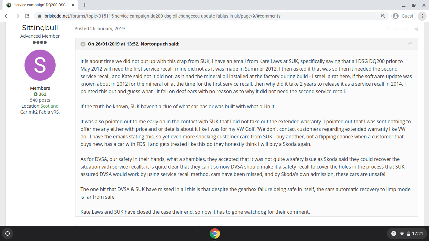

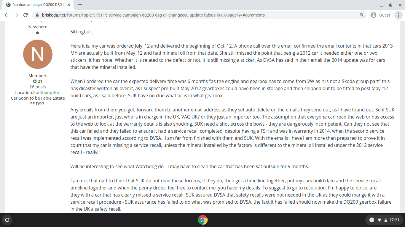

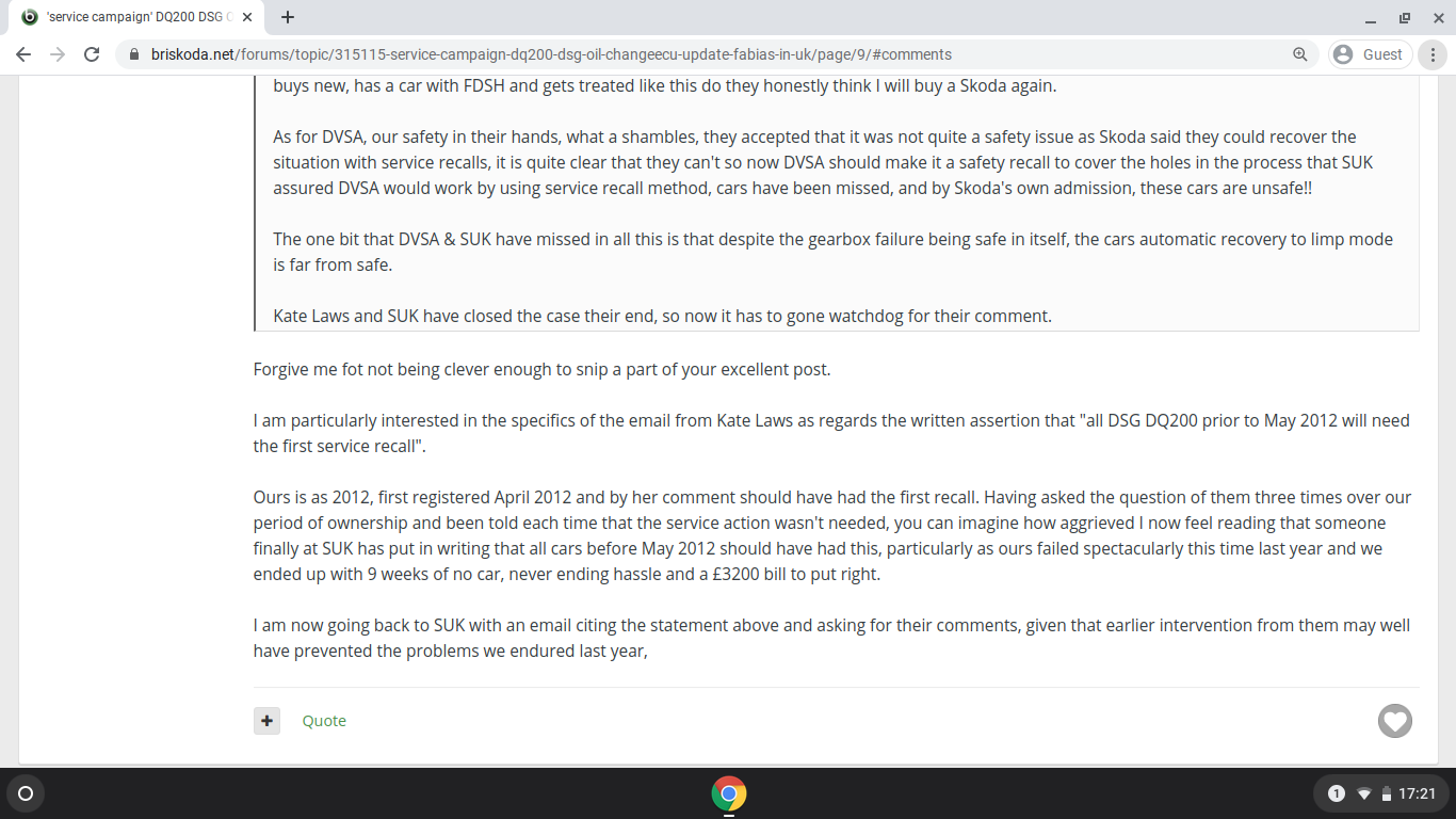

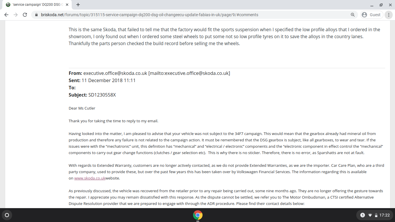

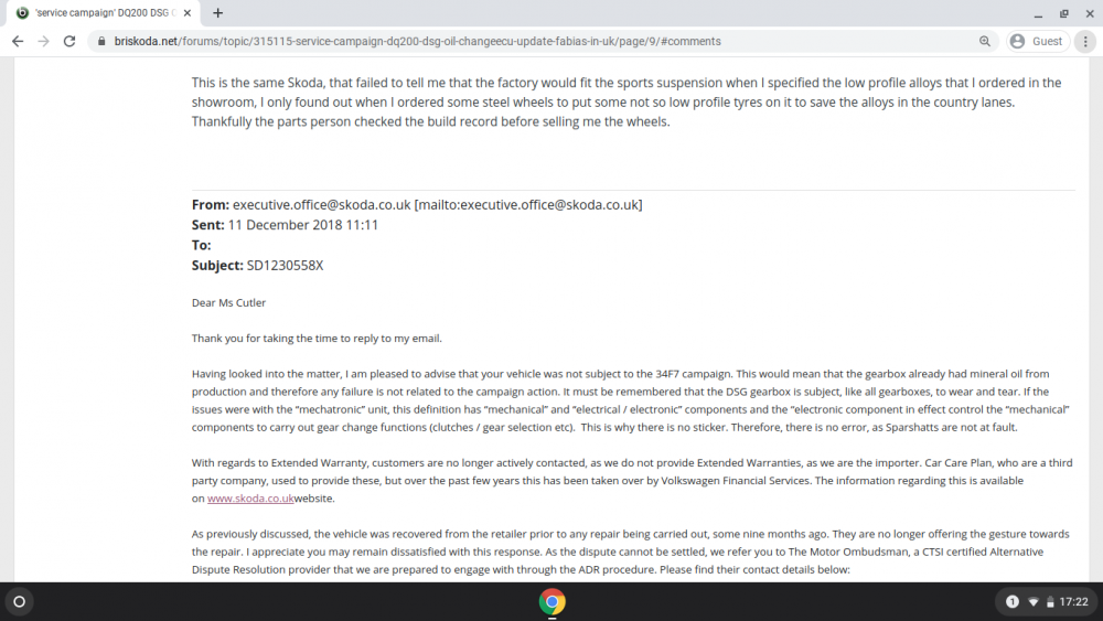

Here is a taste of it.
Edited by Roottoot
