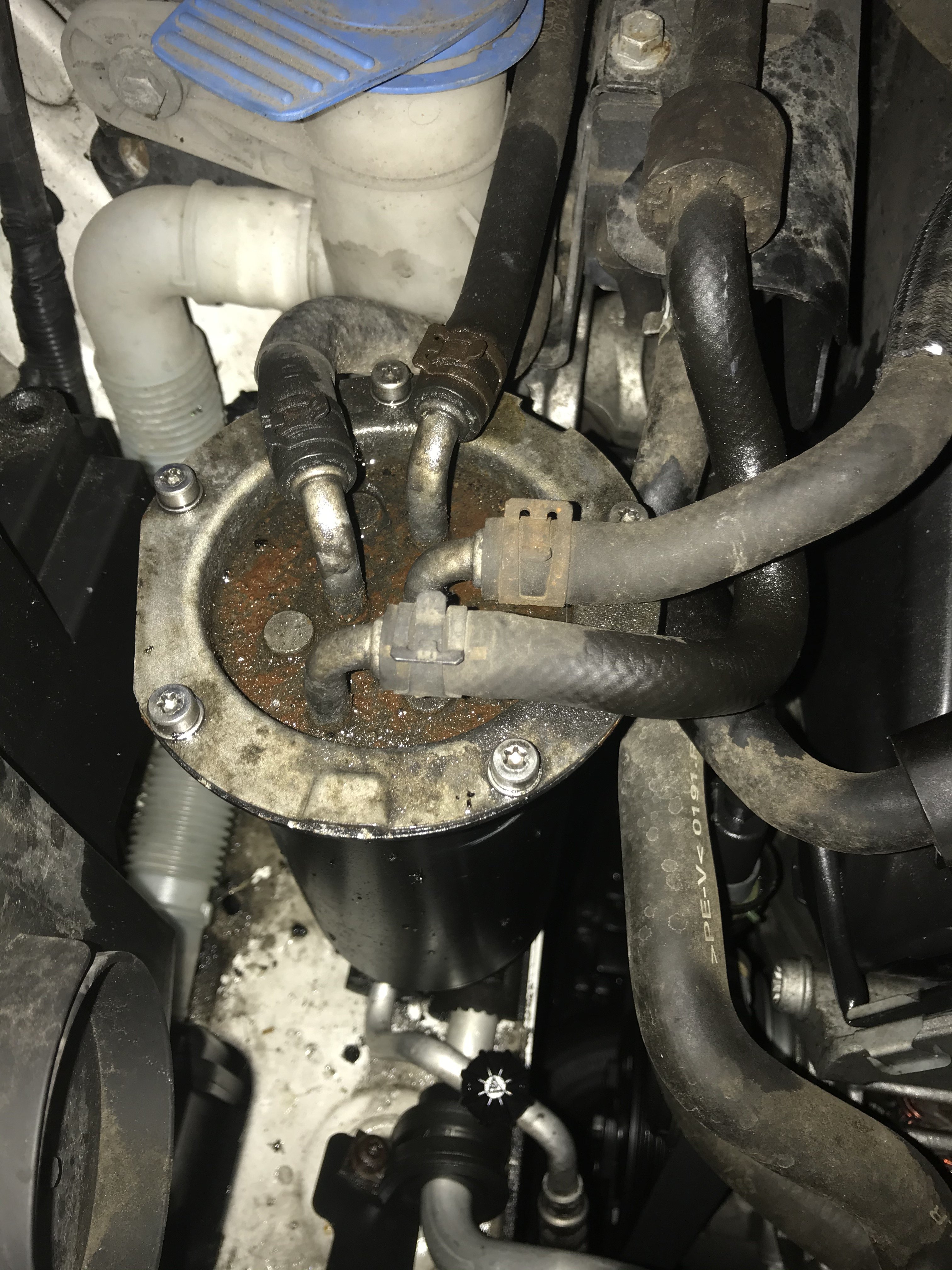

the leak has fuel on the top cap.  There is fuel underneath it.  The other day i hear a small hissing sound and thought nothing of it.  The sound was there again today.
You may have a badly corroded filter top that is leaking (and not unheard of unfortunately) or one of the pipe connections could be leaking.
Ok.  i will check in the morning.  Can you buy the tops or do you have to buy the whole unit ?
The car has done 75k miles
If the dished section is filling up with fuel then the rust has perforated, if the leak is further down then it will be the sealing O ring damaged.
If the top plate is intact now is the time to use some rust convertor and protective paint, a job I must also do.

I opened the filter housing yesterday and just fiddled with the seal a little and pushed the filter home a bit more.  Then screwed shut, this time screwing each screw a little until they all bit tight.
Today we have no leak !  So fingers crossed i have solved the issue.
