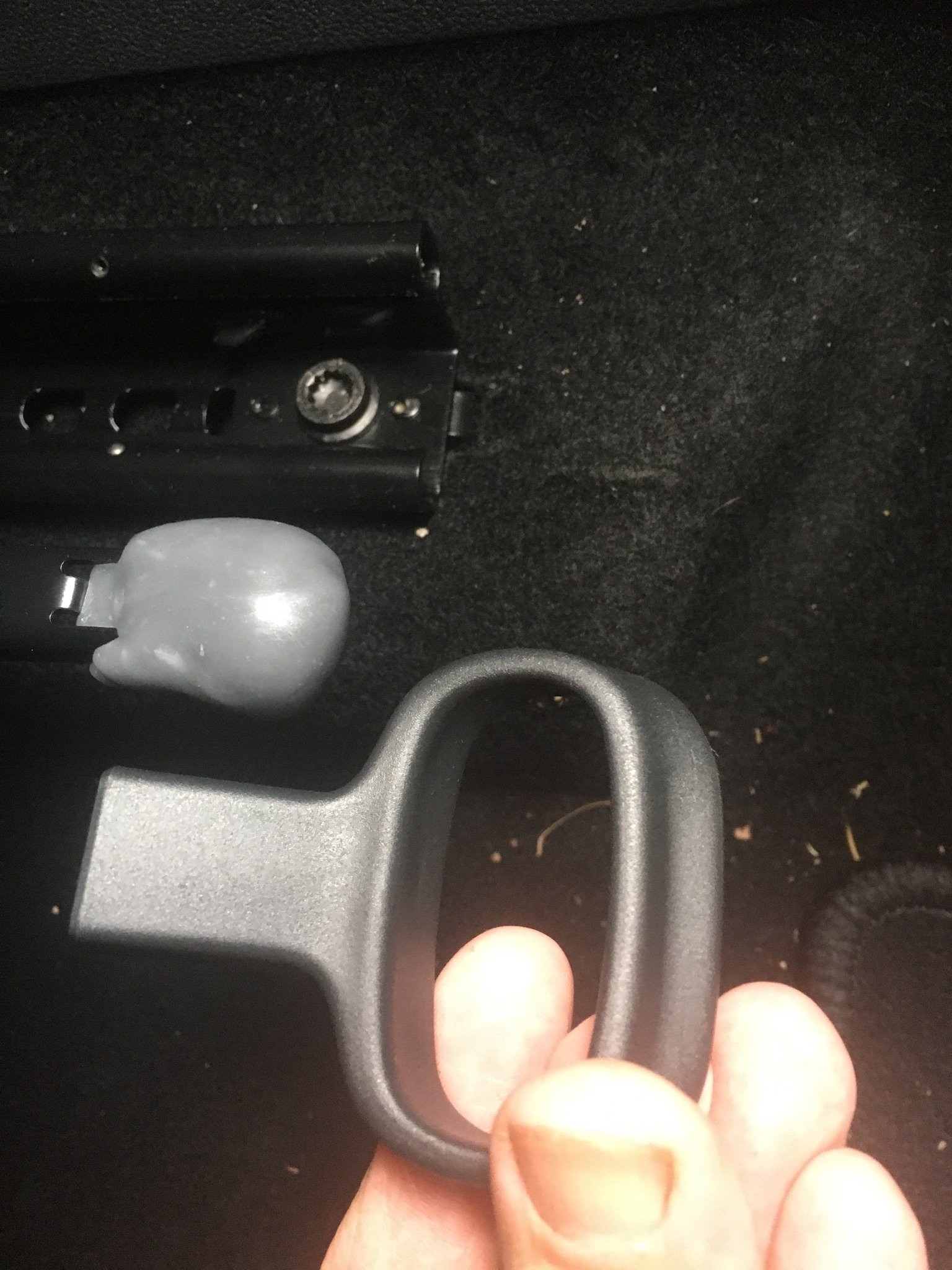

Having had complaints that the oversized handle to the seat slider was in the way (and noticed it myself a couple of times)

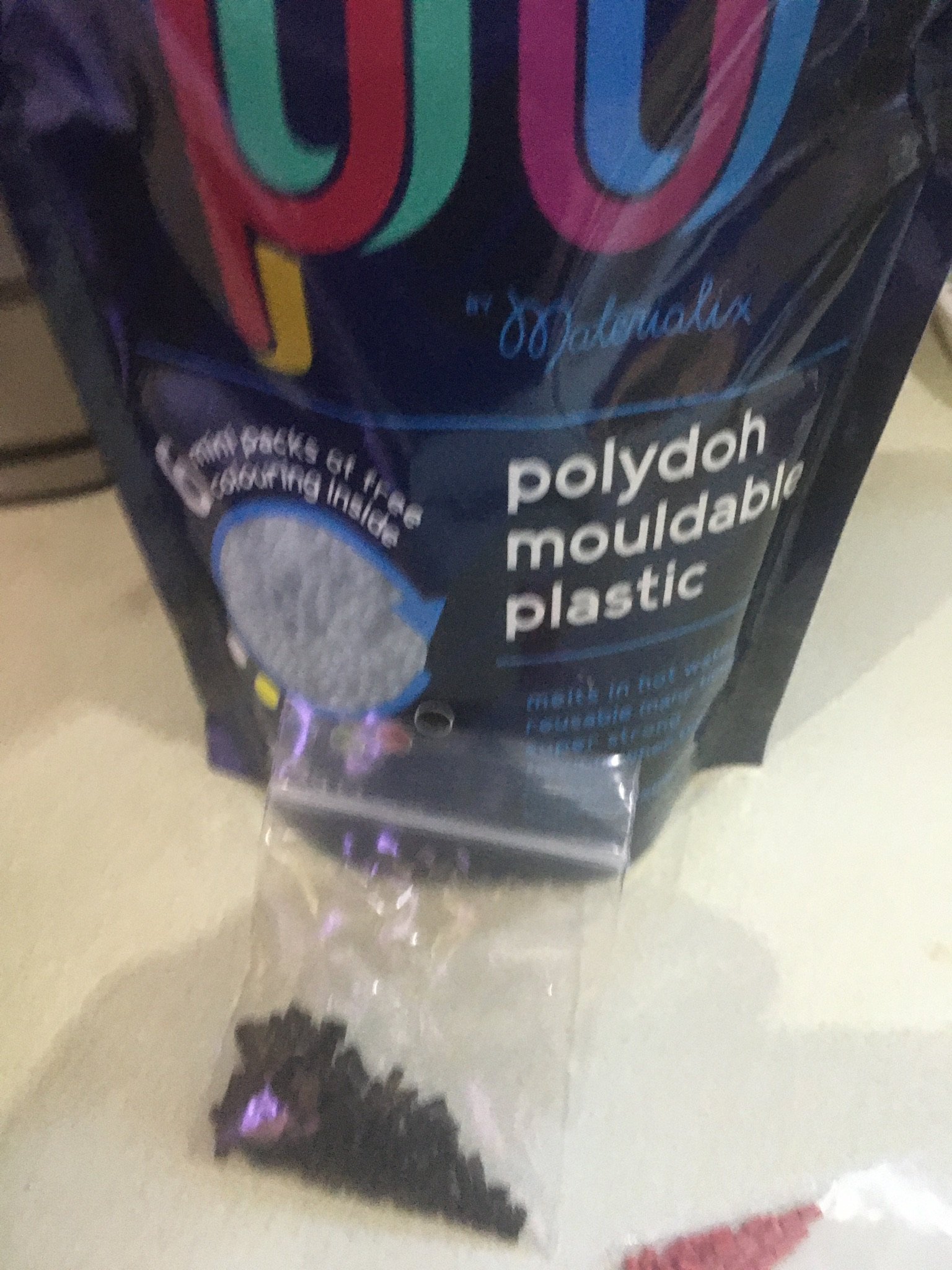

I set about making a compact knob from polydoh

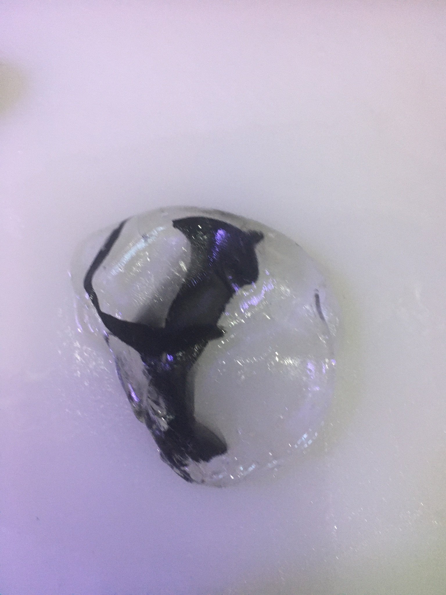

so I weighed the existing handle at around 30g , took about 30 grams of clear beads, and about 4 black strands from the colouring sachets.
( I would suggest a tiny bit darker.. 8 strands) put in boiling water. Fish out with teaspoons and mix the colour. Re submerge for 60 seconds. Cut in half and then mould round the seat control arm .... leave for 30 min..
