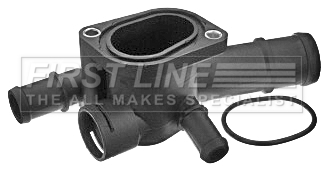

SKODA ROOMSTER 5J 1.4D Coolant Flange / Pipe 06 to 10 Water Firstline 038121132D
First Line Coolant Flange / Pipe FTS1029 [PM724281]
Does that look like the part you mentioned, Wino? They are only around £8 so not sure if I should just order one and have a proper close look when it arrives in a few days! Where I could see though, looked like a silvery-metallic covering. That is not to say the water is not coming from here...

The Firstline part will very probably be rather cheap and nasty compared with your 10 year old original. It'll probably have rough, ridged seams that the hoses will struggle to seal on, and may well be less rigid, made from cheaper material etc. Really wouldn't recommend going cheap on this mate.
Part number (and size) of the o-ring is given as item 21 in that same link. There's very little chance of there being anything wrong with the housing itself.
What you may find though is that the surface of the head that the o-ring seals against may need a bit of TLC to get rid of any corrosion and pitting if it's been leaking at that point for a while.

Post some photos of the new one when it arrives, particularly of the surfaces that the hoses will try to seal against.
Worst case, you won't have paid all that much for the o-ring even if the rest of it looks dodgy.
By the time you'd ordered an o-ring and either paid for delivery or collected, you'd've probably spent a tenner.

I will try and add a photo of the new flange but it does look fairly robust. Not as cheap and nasty as I was thinking after Wino mentioned the firstline part might be!

Took the initiative and did the task, today. Took a while as I was working in the street but removed the old flange, examined it and fitted the new one. The oldie's O-ring was sort of stretched, soft and leaky, along with the temperature sensor's O-ring so I am glad I waited for both parts. I had a new plastic clip, too but managed to mis-place that, whilst doing the job. (Probably turn up one day, in a really silly place). Luckily, the old one was still good and actually felt stiffer then the new one. Not sure if that was good or bad but it seemed sound.
