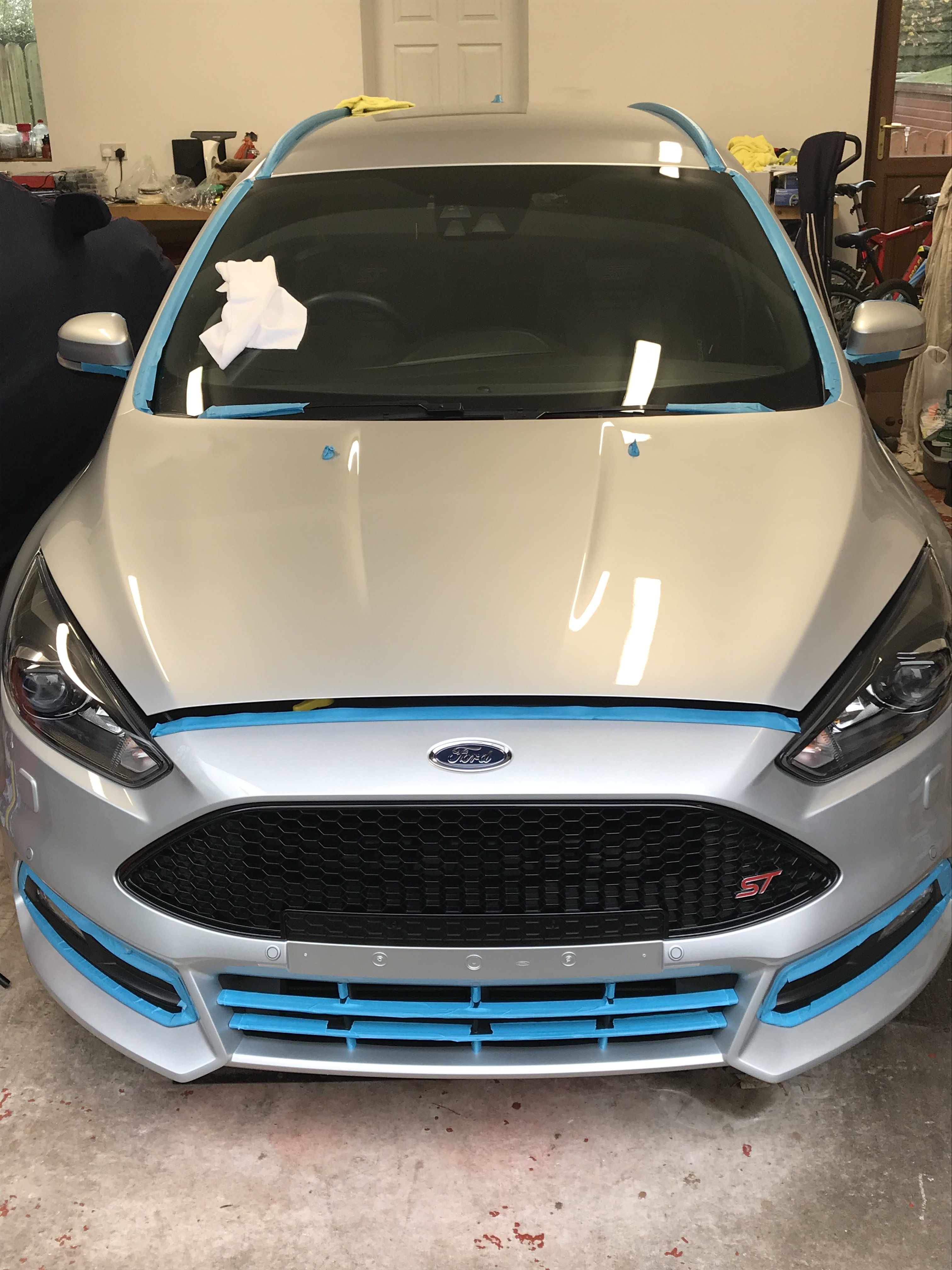

I have 3 rupes machines. The Rupes 15, the 75 and a nano. It’s easier than swapping plates and pads all the time. So I may have a yellow polishing pad on all of them, but use them to access different parts of the panel depending on access.
passes depends on panel and paint condition. Experience will let you see the pad loading. I would prime the pad and do a section, crosshatching as I go. So I’m going to go left to right and then up and down. I’ll do this several times on the same section. Then I’ll clean the pad with the pad brush, and re-load with polish. Trick is with time you’ll get used to when the polish is running low on the pad and when your overloading the pad. The latter will make your progress go backwards.
trim pieces depends very much on finish and polish and pad being used.
I can run round the superb without issue but my wife’s focus for example has rubber weather strips that are a disaster and need taped. The different sized machines make the trim process a lot handier to be honest. If you have polish on black trim you can remove it with a plain white rubber. This was the focus last time I prepped it for ceramic.
Forgot about type of pads. I would use something like the genuine Rupes pads or something like lake country or hex logic. I would also have a range of foam, microfibre and wool pads on hand.

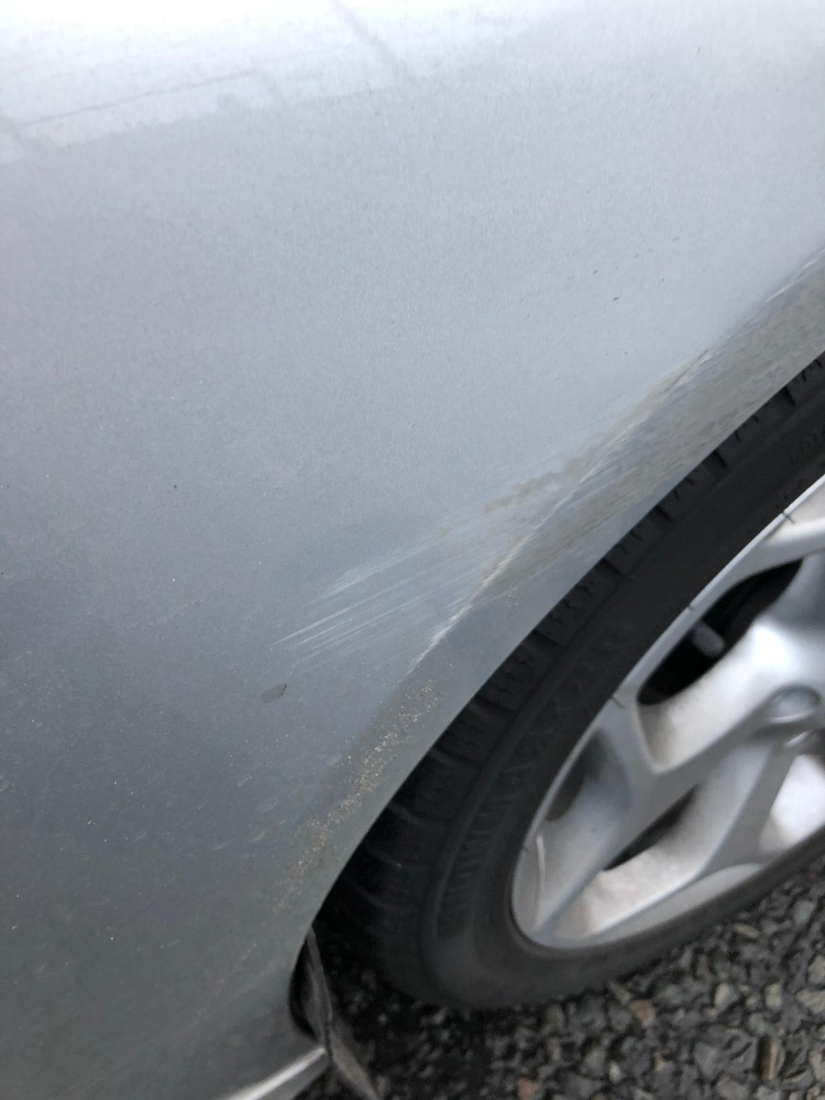

While you have that panel I would use it to practise some wet sanding. Start with something like 3000. You can use water in a sprayer or clay lube, or even soak the paper in a wash bucket with soapy water. A small sanding block will help keep it uniform until you get the hang of it. I had to do 2 sections on that focus as some muppet caught it one day while my wife was in work.

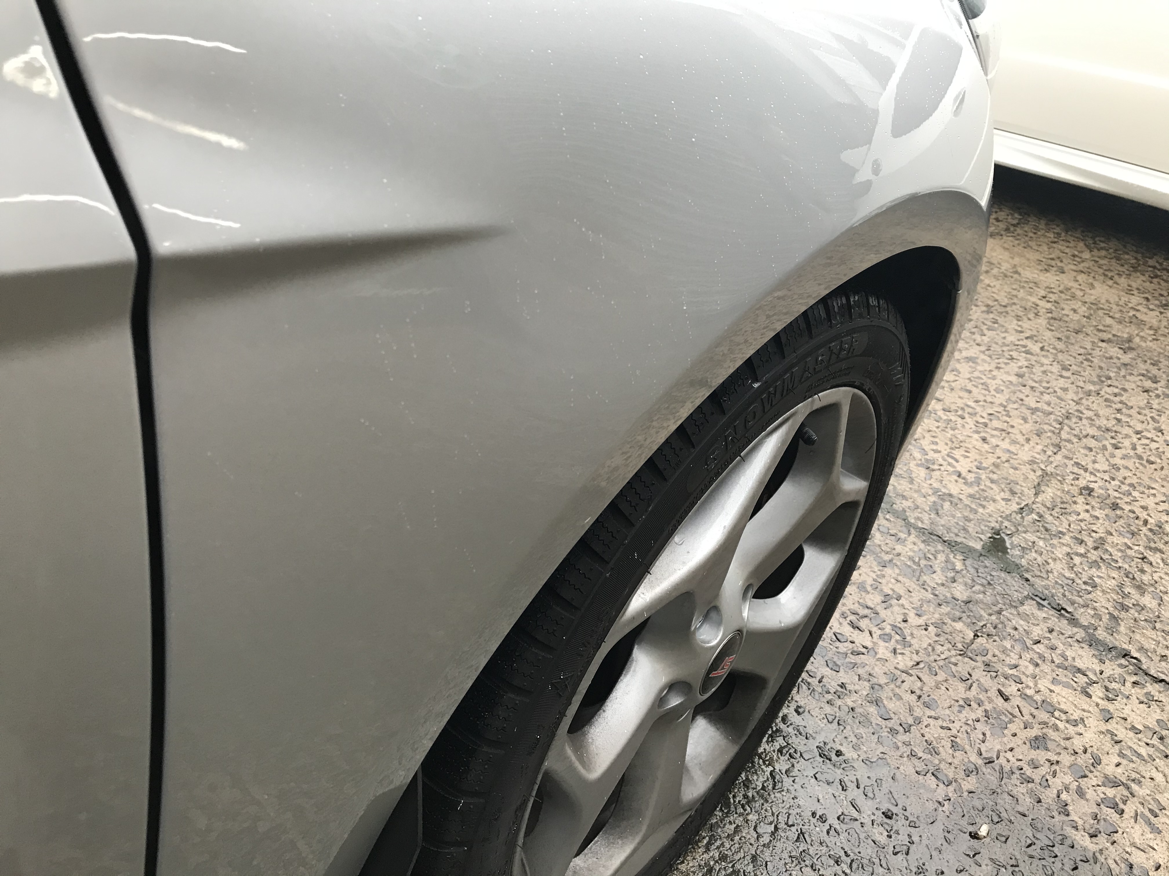

On your wing pic, did you not add any additional paint there? All from wet sanding with 3000?
Most stone chips if gotten to soon enough will be fine with a touch up applied with a tooth pick. Let it sit for a day and do the same again. Then leave for a day and then flatten and polish.

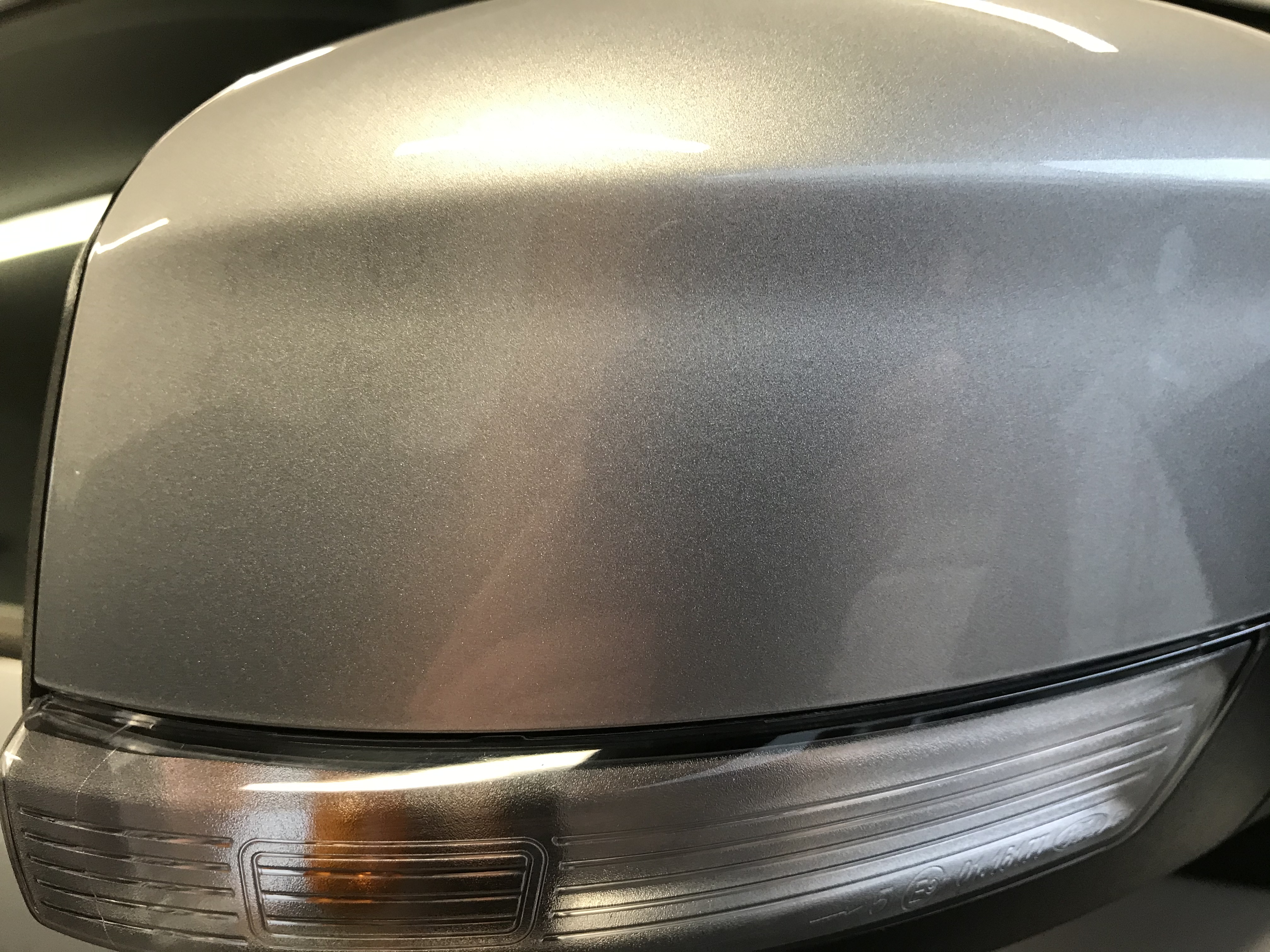

The focus received no paint. The wing was hit lightly with 3000 and then polished with varying grades of pad and polish. The mirror cap was just polished out using the nano and a couple of different pads but with a fine polish, as mirror caps and handles etc don’t have a massive amount of paint on them. Sometimes on those items I would use say, a finishing pad with a polishing compound so as not to catch an edge. Good practise when starting, to tape handles and go over them with same compound but on a hand applicator until you get used to the feel of the machine. Just in case!!
