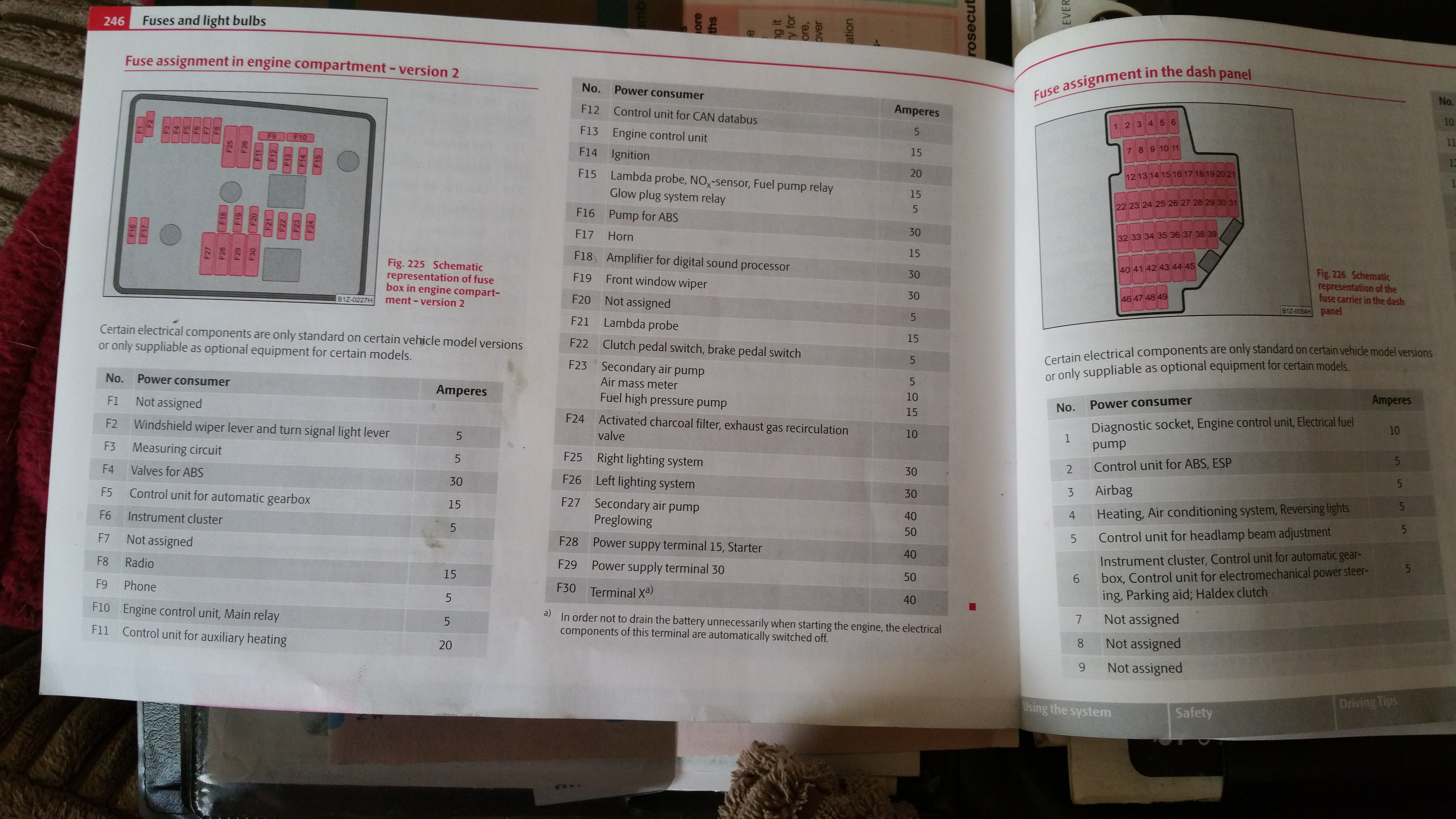

It could well be a remaining fuse or oxidised connection problem, the electric power steering is the most current hungry accessory and is the first to throw up fault codes when its supply voltage drops be it through a weak battery or voltage drop across a bad connection like the ECU fuse problem.
I would start by checking & cleaning all the supply connections and the earths, then have a VCDS scan before playing parts bingo on the say-so of people that say "its most likely................." like the person who said your ECU was most likely to be the problem.

To be honest, it sounds like one of the electrical connections or fuse-holders haven't been cleaned/connected properly which led to a brief power outage to the power steering and it got upset.
Certainly feels more likely to be that give the work you've had done rather than an actual failure of the steering rack...

how do I check Terminal 15 and where is it?
is it these below?
F28 fuse in engine bay Terminal 15 starter
6 instrument cluster interior fuse

Had a quick look, connections on the power steering include:
- T2p/1 (Terminal 31/ground)
- T2p/2 (Terminal 30/permanent power) is fed from a 80a fuse (SA2) of the main busbar (slot 2)
- T5e/1 (CAN-L)
- T5e/2 (CAN-H)
- T5e/4 (Terminal 15/switched power) is fed from a 5a fuse (SC6) of the passenger compartment (slot 6) which agrees with the owners manual
- T5g/2/3/4/5 all go to G269, I'm not sure if this connector is accessible or if it's internal to the steering rack
The three T5e/x wires all go via an extra connector named T6j described as a 6-pin connector, on front left in engine compartment (black).
Given nothing else is complaining about terminal 15, the fuse it probably fine but it's worth load testing the terminal 15 supply at T5e and T6j if you can find them. I can't be 100% certain the diagrams I have match your car either.

yes I checked the fuses and there ok as only fitted yesterday new.
I dont know what (CAN-L) & H or main busbar are sorry mate not learnt all the terminology for the wiring yet Terminal 30 and 31 which plug are they to be found,
I will learn as I go long hopefully thanks mate
