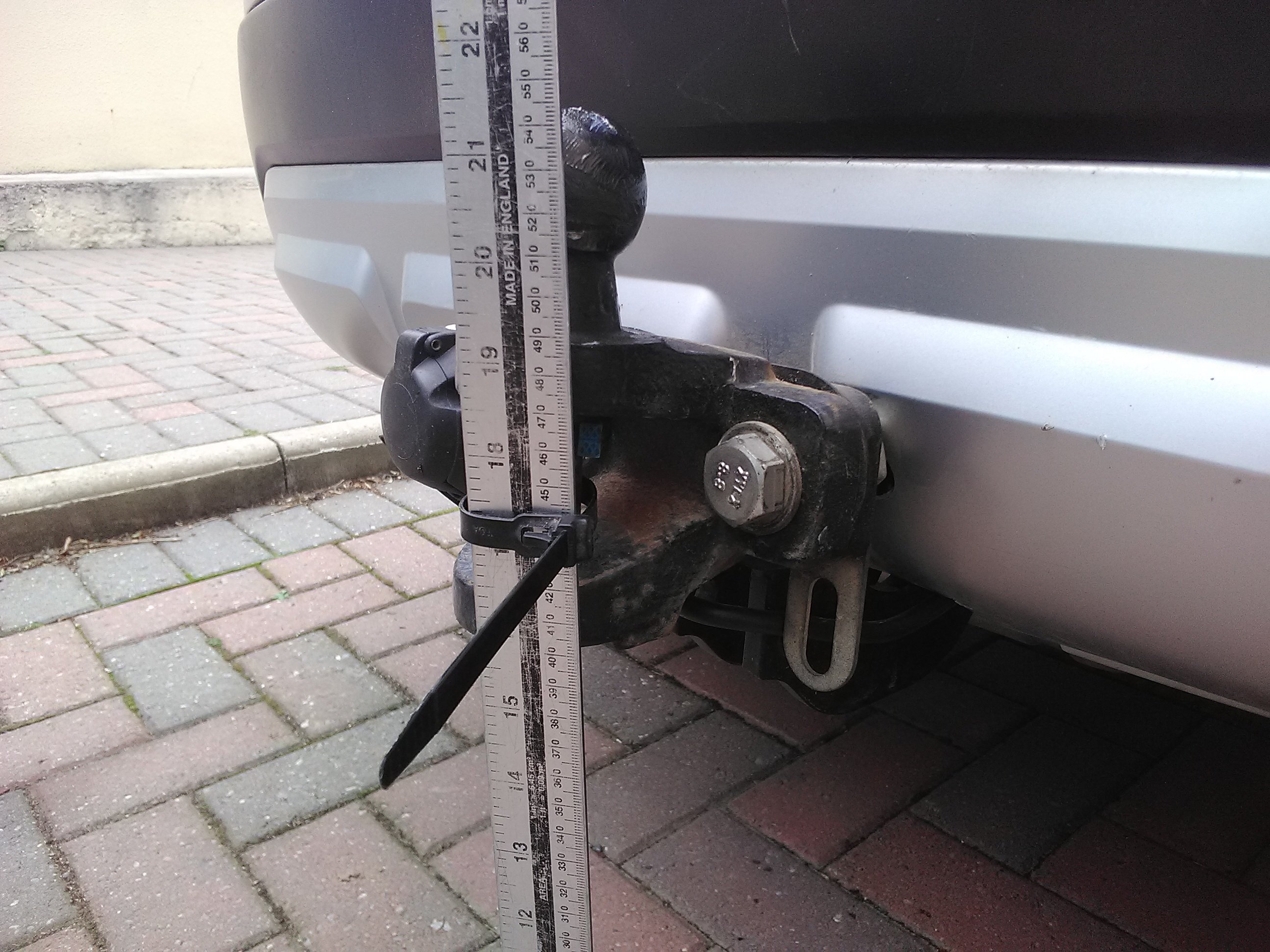

Thanks for all the photos, I will take one tomorrow when there is light, its clear that my towball mounting bracket is significantly higher, it looks right and I dont want to spoil the look with a drop plate so will probably raise the towhitch on my trailer again, it was the right height for most towbars when I built it 35 years ago but they probably weren't concerned about EU regulation heights back then like the Fred in a Sheds who made the Yeti towbar :D

A picture is worth a thousand words, compare my photo with Cap'nslogg's & look where the flange is located, his is hanging in free air and mine tucked up against the removable silver panel which not only had to be cut to clear the flange bracket side plates but i also had to drill clearance holes for the bolts, the nuts fit in with a squeeze but I have to wedge the plastic back, that said I really like the close fit and having the ball above shin height and it suits the aesthetics, I just have to raise my tow coupling a second time.
I think its possible that the towbar was made using a Greenline Yeti as a donor vehicle, they are much lower and the towball would probably be a reasonable height with the towbar fitted to one of them.
There is also the possibility that my Yeti may have had raised suspension from new, I think it may have been a Forestry vehicle, I know the "Outdoor" model has higher ground clearance but mine looks particularly high.
Unladen and on standard 215/60R16 tyres I have a measurement of 31" to the bottom lip of the rear wheel arch at the 12 'O' clock position and 30.5" on the front wheel arch, how does that compare to your Yetis?

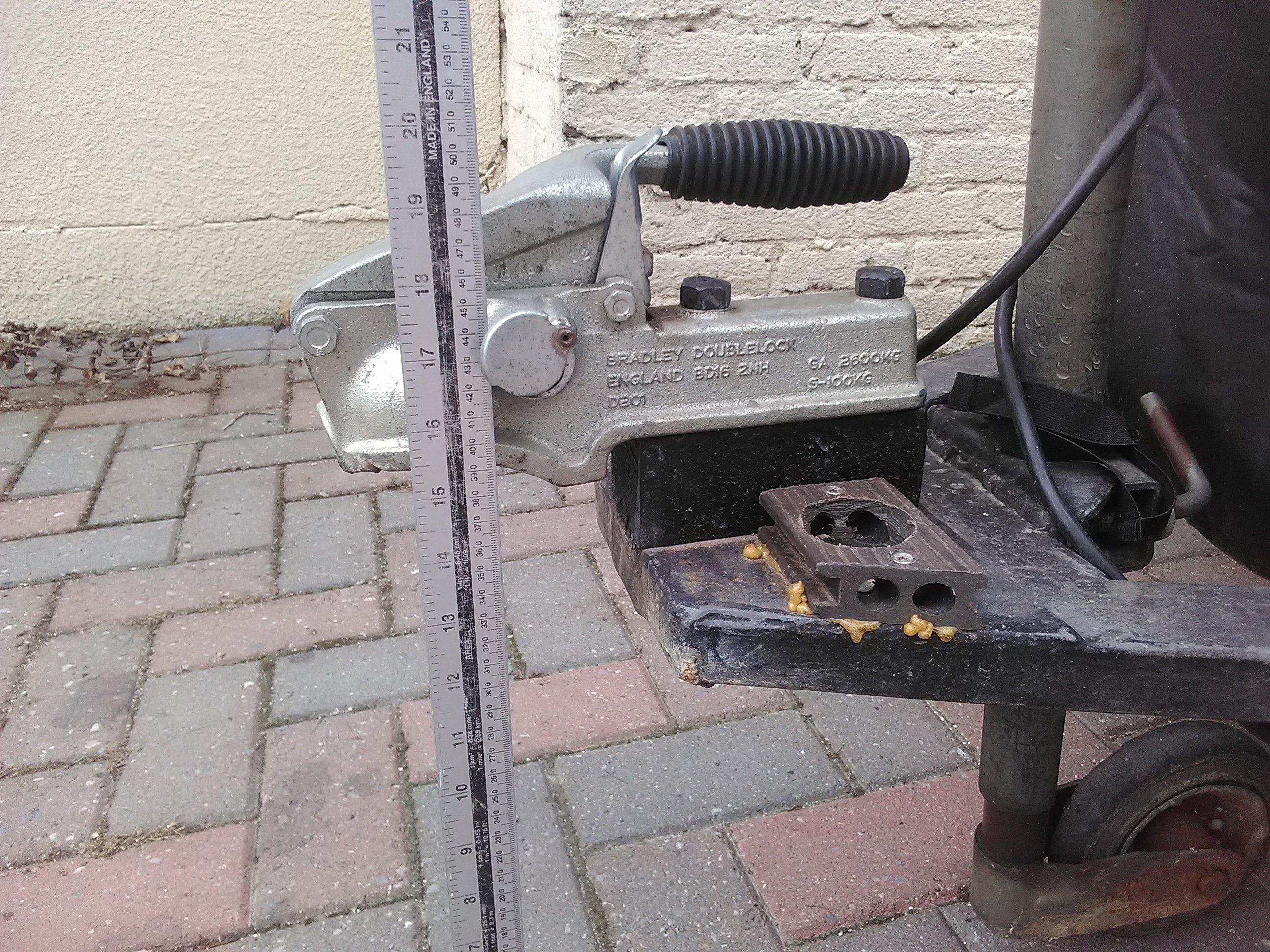

My goods trailer I made all those years ago at the lower end of the height range, what was in those days the standard 14" height, this photo is taken with the trailer level and you can see I have already fitted a raising block to the coupling just like the photos on the attached thread where FrenchTone has done exactly the same thing.
I will have to make two more additional raising blocks but prefer to do that than fit a drop plate, not through legal concerns but because it will look naff.

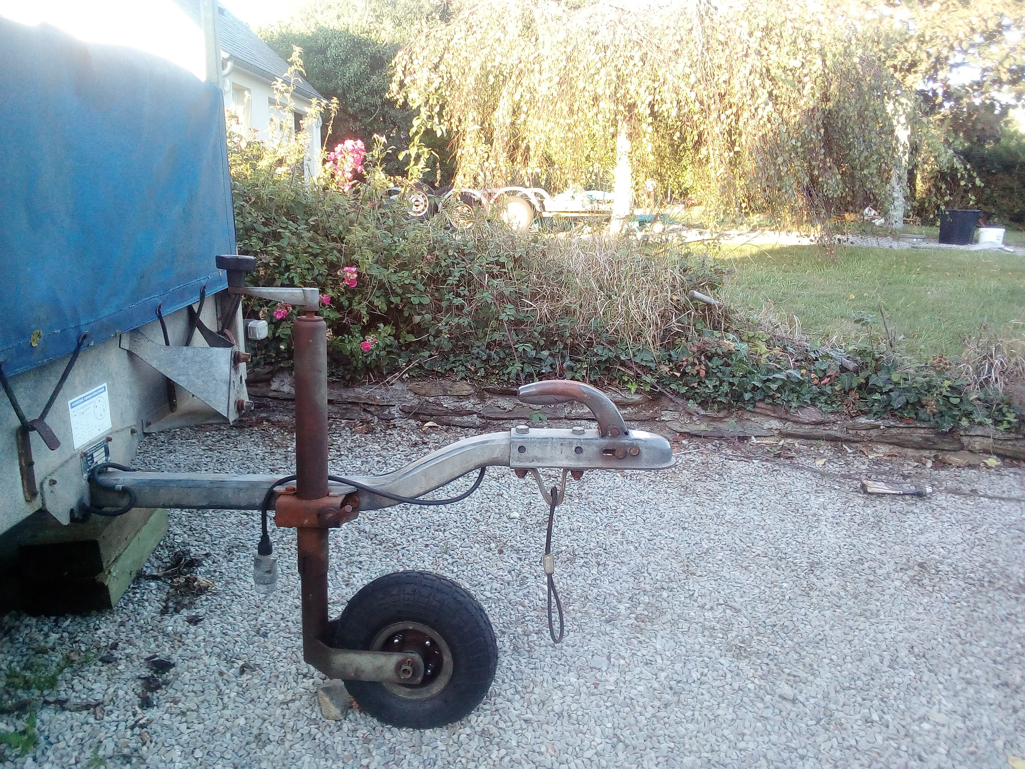

Ok, this is the towbar on my Williams trailer, bought second hand so I don't know if they are all supplied with this or if its just with load bearing tyres version(smaller diam fat jobs) I also have a car transporter trailer , classic Brain James so built years ago and with that because of the relative heights of the hitch and the ball I have had to raise the hitch by using 2 x 2" square pieces of robust steel box section, at that height it all works well!
Comparing the rear bumper mouldings in my picture and the Captains one I would say that my Yeti's ride height is 60mm higher, is yours an Outdoor model or perhaps a Greenline Captain?

I saw the photos of that on the other thread Tone, I think the sections were side by side giving a lift of 50mm which is what your joggled drawbar looks like its raised by, I eventually raised mine by 50mm but it needs to go up another 100mm, less some for loading so it will be a total of 10cm initially & then higher if need be.
