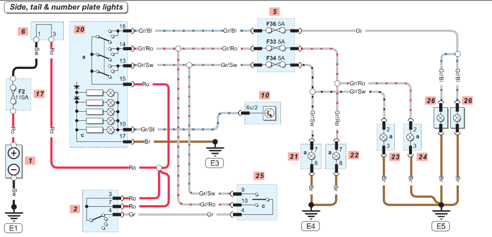

Here's the wiring diagram. There's not much to it, items 26 are the number plate lights....
Edited by TMB
