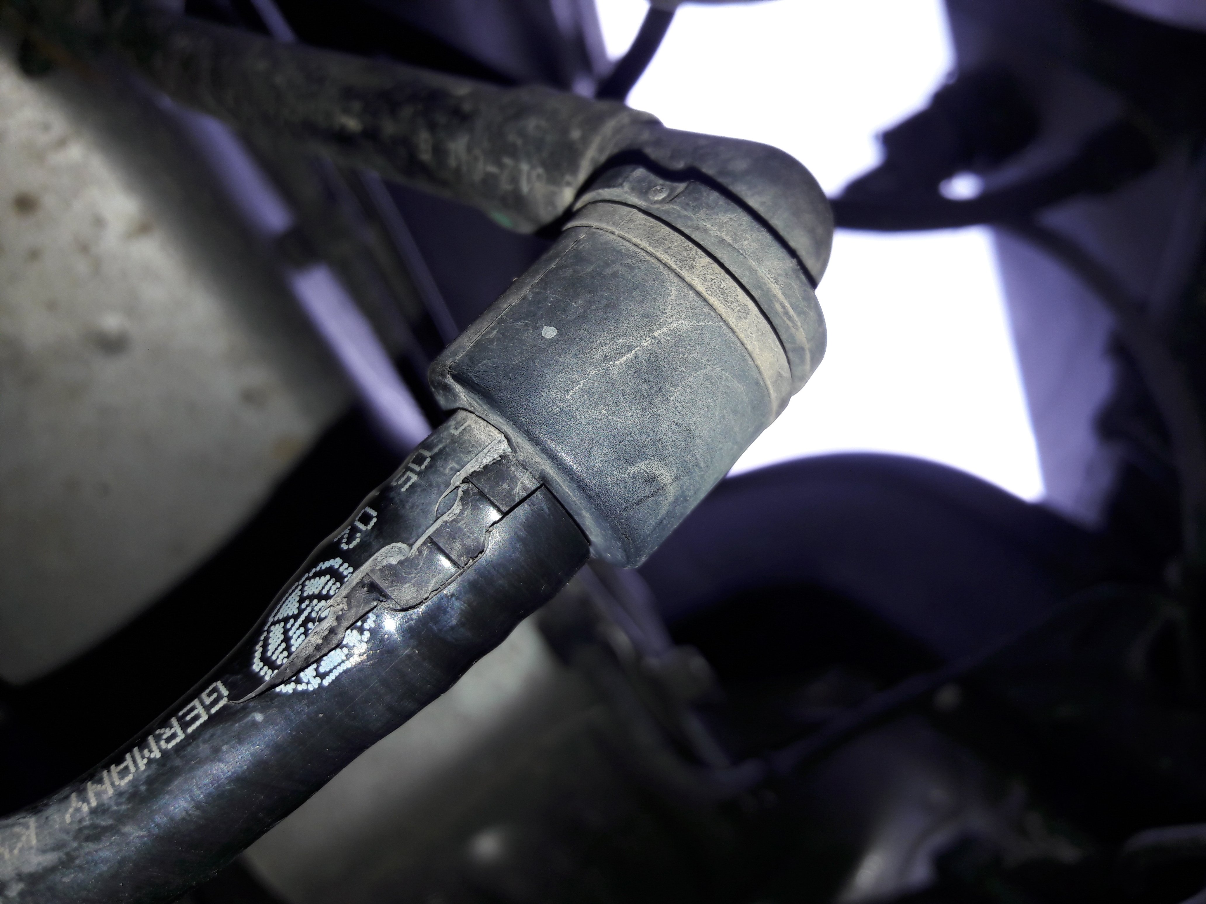

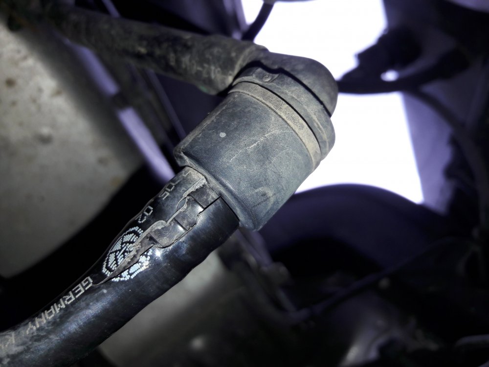

Very common problem.  I find it quite surprising these days when I come across a (VW group) car that hasn't got some degree of splitting in these areas. Some are just hideous/obvious but it can be quite subtle in the early stages.  Look/feel on the underside as well as visible parts.
Here's an end-stage one on a mk4 golf; sounds like yours may well be similar.
