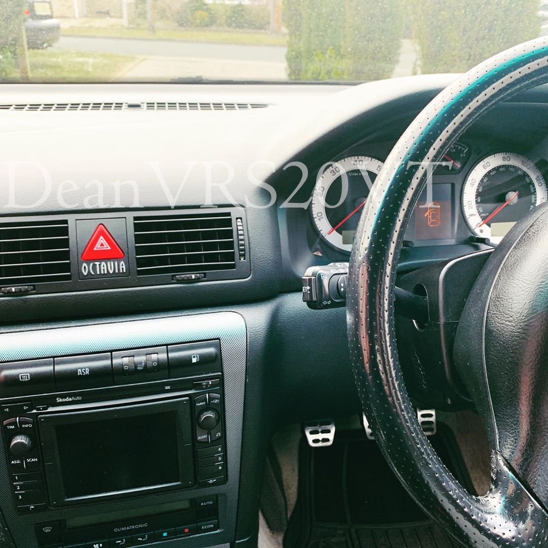

A very rare option at £1500, I've got it on my MK1 VRS, along with Xenons.
So that's why the climate controls are so stupidly low!!
@guss84 - Do you have the CD stacker? It's in the LHS of the boot near the rear light cluster.
