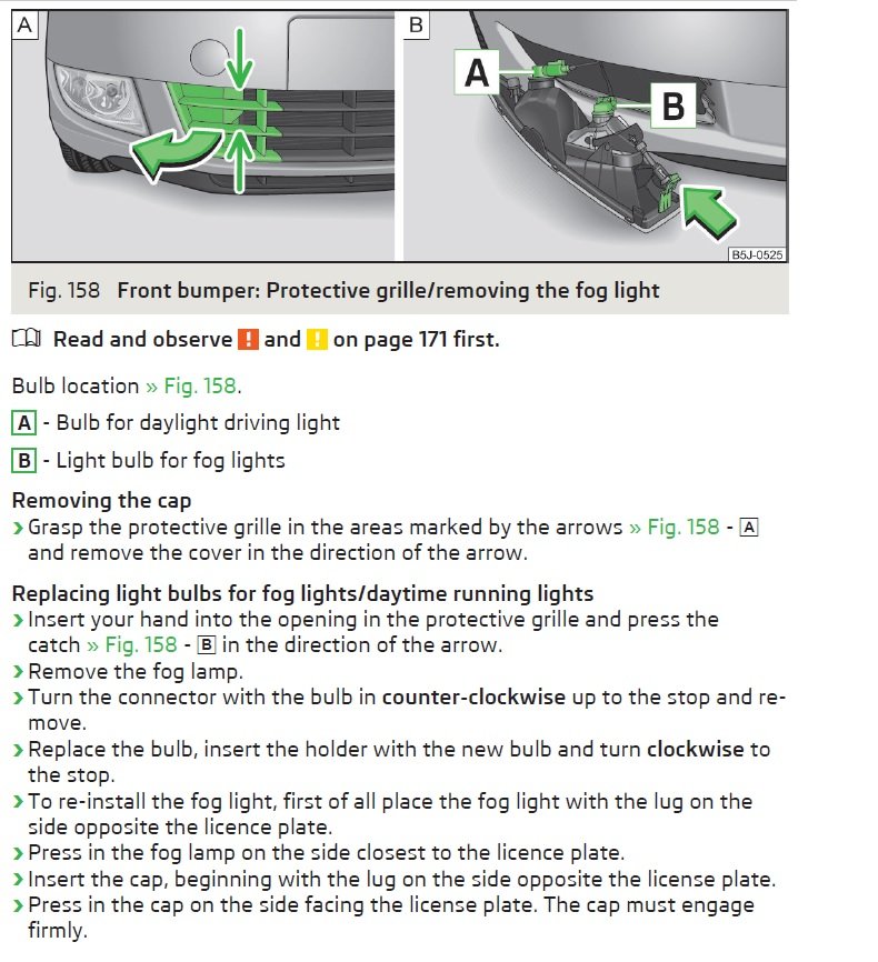

Hi, Does anyone know how to replace a bulb in the nearside daytime running light please. (2013 Mk 11 Monte Carlo) The book says remove the grill and push the retaining clip to one side-maybe Im overthinking it but I'm dammed if I can work out how to get into the light cluster.
Thanks
You dont "get into" the light cluster. you remove the whole lamp and then the bulb is accessible.
Remove the end of the lower grille nearest the lamp itself, then put your hand in and you can feel the clip, push the clip towards the lamp and she will pop out, really is easy once you have done it.
Just incase your book is different..............attached is instructions...
Hi, thanks very much for your reply and the info. The bit about removing the cap in fig 158 A suggests it simply pulls off. Is this correct?  Ive got it partly loosened at the top but the bottom won't budge and I don't want to force it.
Thanks
yes it pulls off, pull it at the top and bottom at the same time.
Edited by UrbanPanzer
sorted, easy when you know how! thanks very much.
