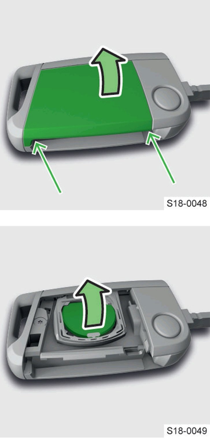

I've got remote central locking (not keyless entry) how do you get onto the unit it to change the battery? Can't see any obvious tabs etc and don't want to break it.

I read you can get a CR2032 in there but seems way to tight and didn't want to force it in there so settled on a CR2025 as original.
Battery didn't seem that flat, measured around 2.99V.
