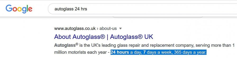

Cracked windscreen replaced by Autoglass beginning September, the latest downpours bringing flooded driver side floor. Removed driver door card to check for panel leaks , can't ' see' anything untoward, put some sealer on it anyway. Auto glass site chat says open MONDAY today being Saturday. I'm Sure they fit 24 hours ! No money in fixing leaking fitted windscreens ?

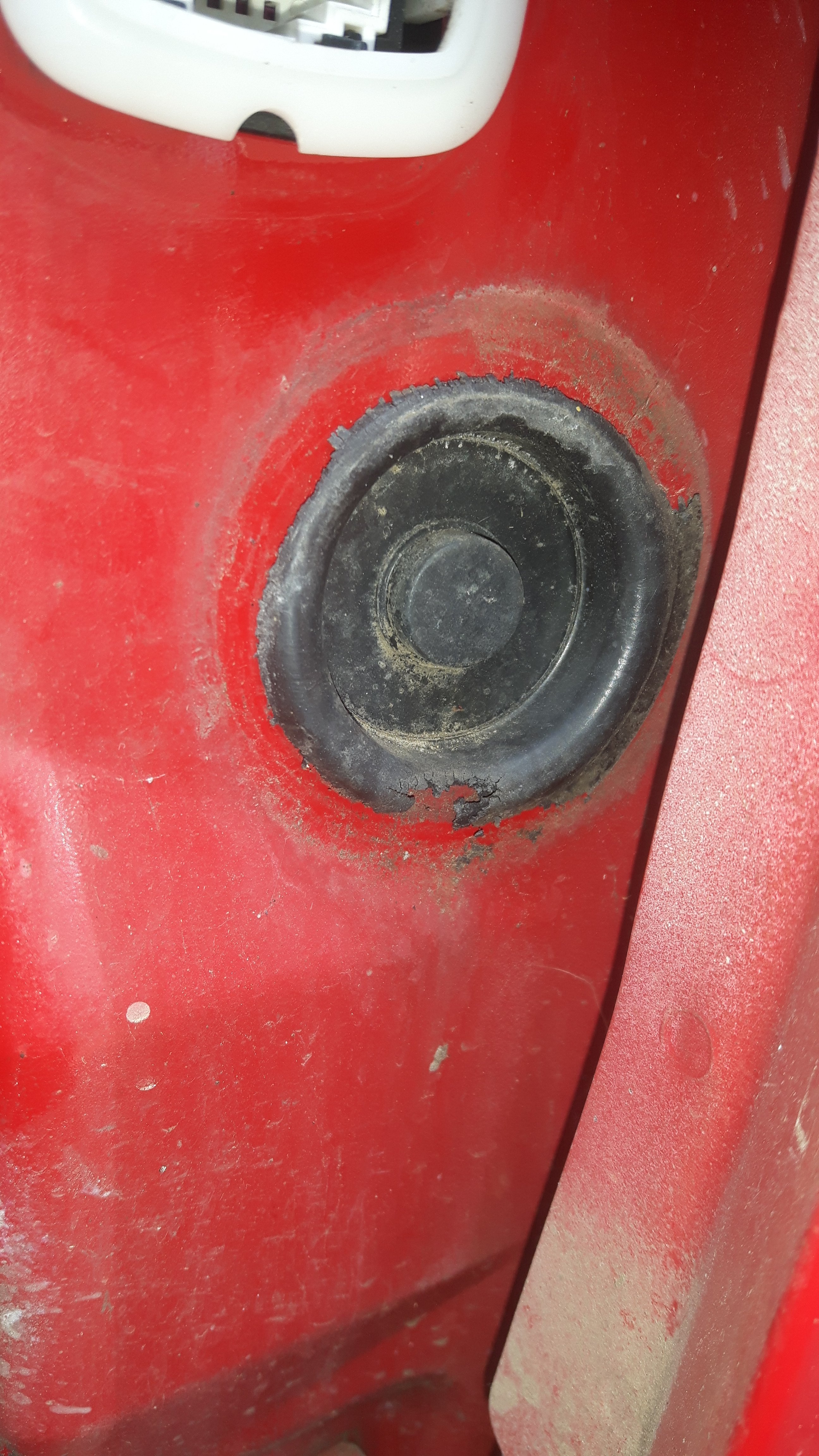

Check the condition of the blanking grommet a little way down from where the wiring goes into the a-pillar, in the door hinge area,  They seem to perish and become a very loose fit in the hole. Sealant it to death if you do find it loose. Also check that the rubber boot at top end of wiring bellows is sitting right, tight up against metalwork.

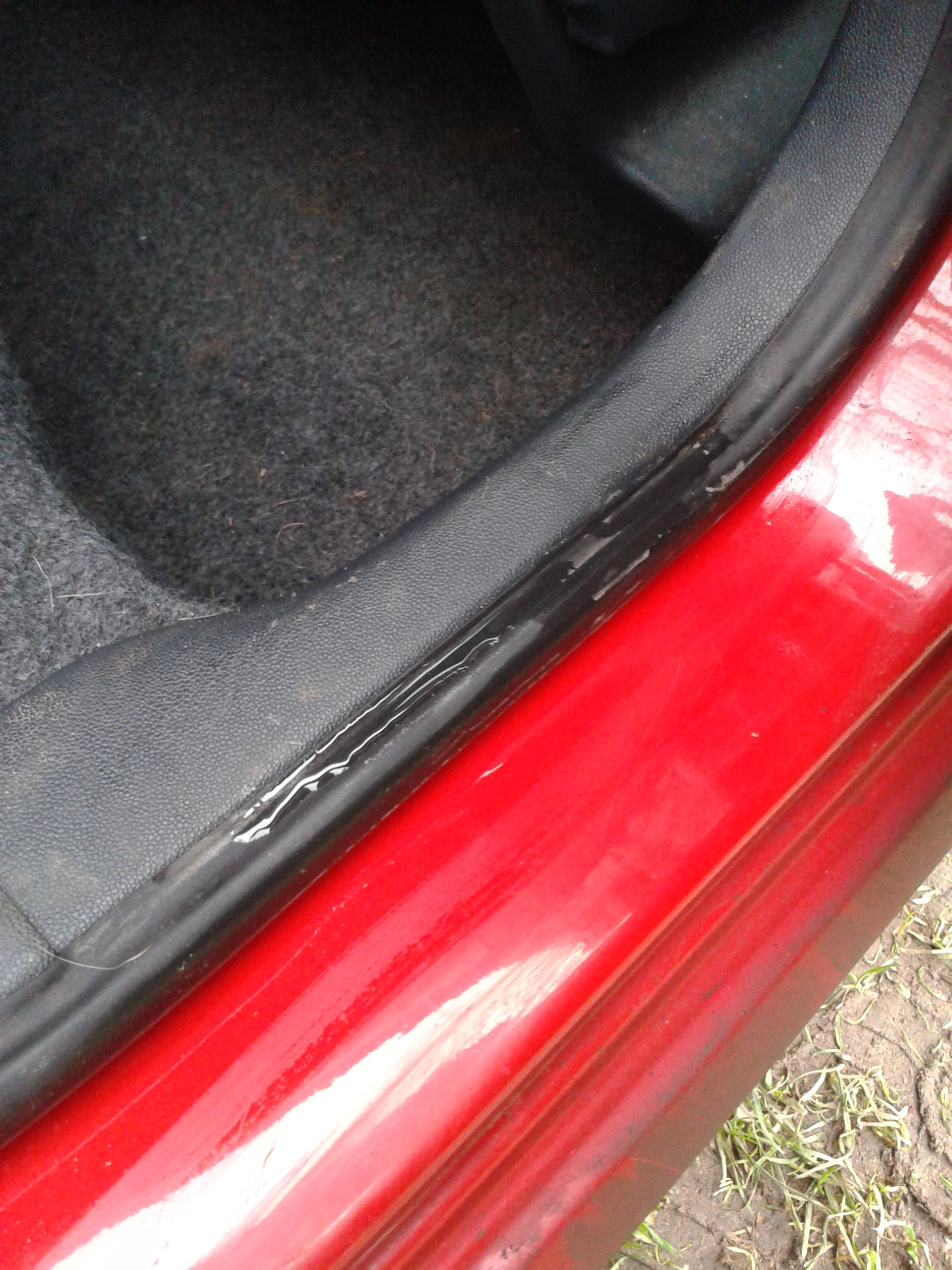

The other thing to do is to look at each door opening after rain, checking for water on the horizontal bit of each inner seal.  If you find little puddles on any of them, that door is leaking. Here's a picture of the offside rear door of ours with some water showing where I mean.
