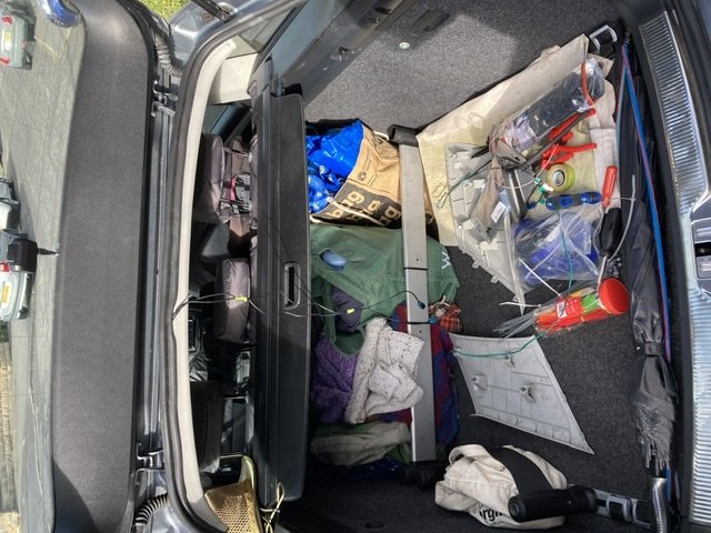

Now that I have half the rear boot supports down I should be able to remove the rear grab handles and drop the rear liner enough to get to the antenna and swap that out tomorrow.

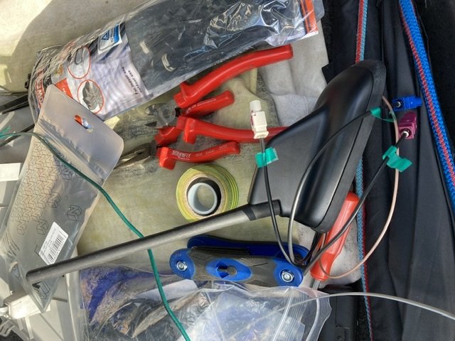

To confirm you do indeed need to remove the rear grab handles to drop the roof lining enough to get my arm in to undo and disconnect the old shark fin antenna. Wonderfully the old fakra lead is clipped to the roof and that needs to be pulled out carefully with pliers.
You have to be very careful pulling the roof down or you’ll get a crease by the grab handles.
I cleaned the area under the old antenna and refit the new fin. I tightened up using an adjustable as it gave me better control your mileage may vary.
