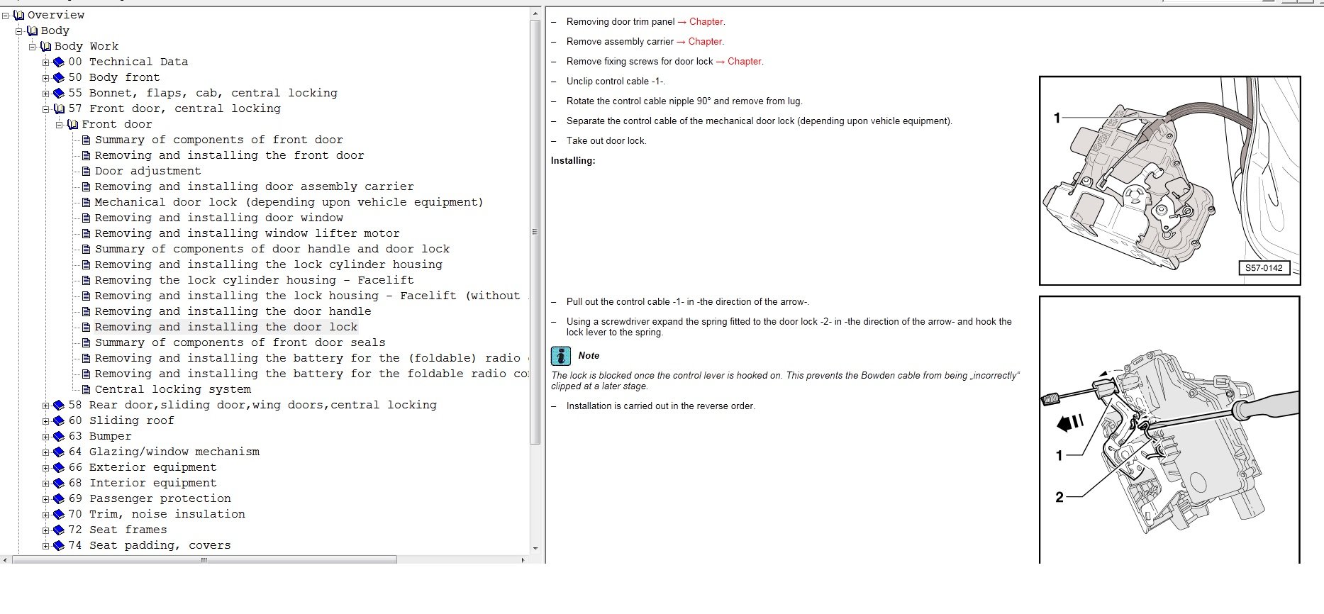

This is in the Fabia section, you have an Octavia, although should be similar......
Assuming you have door trim off and carrier removed to access the lock, there is no mention of the barrel.
