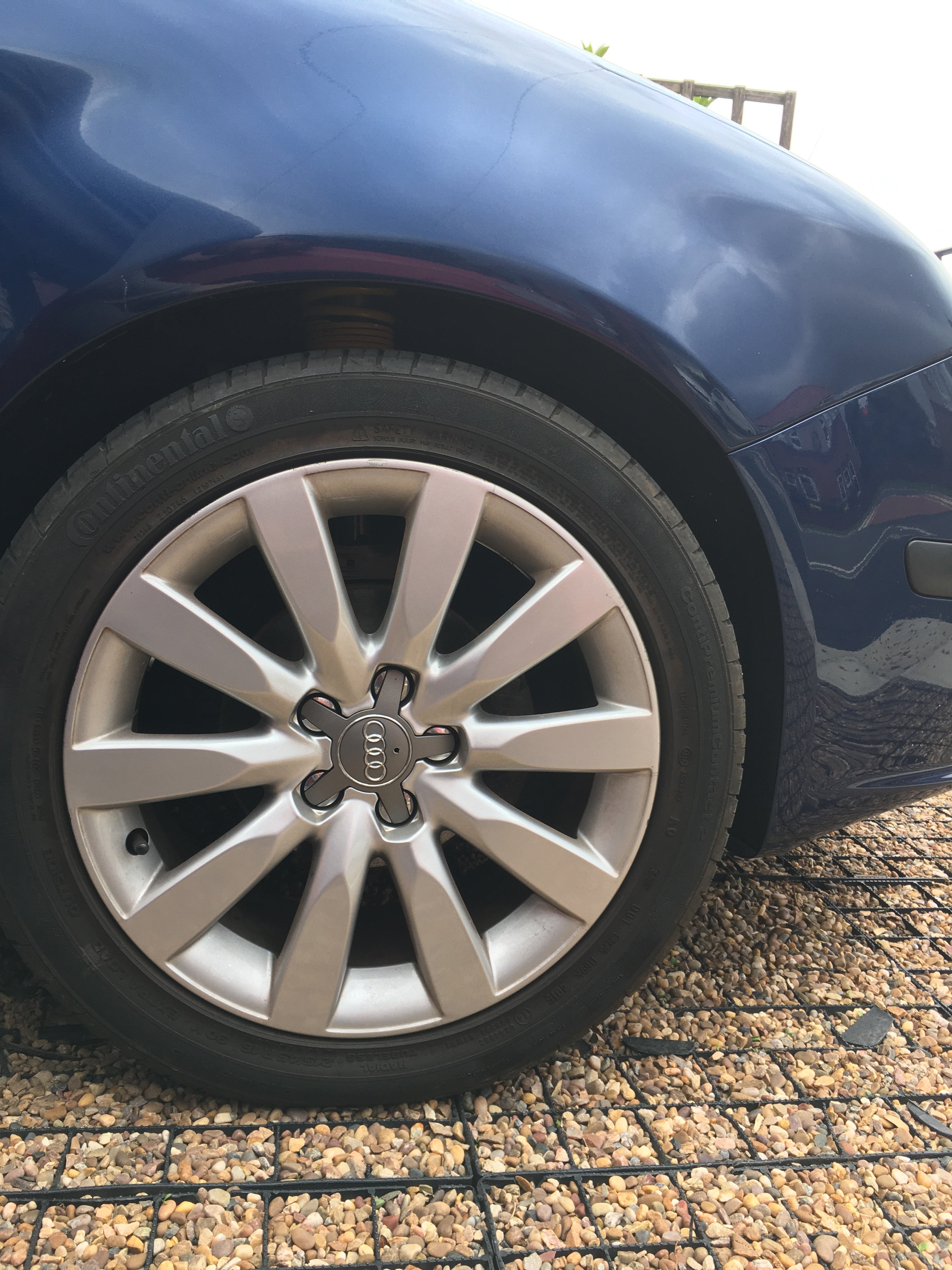

Hi guys,
I know this subject has been done to death but I just need some thoughts.
So the car is on a set of A1 alloys 16” 7j ET34 wrapped in 215/45 R16 tyres. These fit perfectly in the arches and are nice and flush.
when the car was on standard suspension no problems.
I have now lowered the car on Coilovers. Nothing fancy as it is more for looks as it’s only a 1.2.
mits bot slammed and I can still get 2 fingers plus space in between the wheel and arch but I seem to be getting some rubbing when on full lock.
The question I have is should I just raise the suspension a bit at a time until it stops or should I look at some slightly thinner tyres like 195/45 instead?
any thoughts or anyone had the same issue?

The tyres are slightly too wide, however you can fit thin spacers behind the wheels to get rid of the rubbing without spending on a new set of 205's.
Awesome I was hoping someone would have the exact answer, going to lift up a little to get rid of the rubbing for now. I will be getting fresh front tyres before the winter really sets in so was looking at 195 do you think these will be too much of a stretch? 10mm less on either side of the tyre.
205 is the standard VRS tyre width fitted to 16" rims.
205/45R16 might get rid of the rubbing. However, the 7J rims and the low sidewalls don't do the ride any favours. 195/45R16 would make the situation even worse.
185/55R15 on Audi A1 6Jx15 ET29 rims would help move the tyres to the edge of the wheelarches compared to a more normal ET43 that you might use with this size tyre on the Fabia MK1.

Thanks for the input.
I’m not gonna lie I’m not gonna swap the wheels to something simply because I like them and tbh I’m saving for an old Porsche the suspension was a treat because I just can’t stand riding round in a monster truck for my daily driver lol.
The ride isn’t actually bad at all in fact it’s just as comfortable as our MK2 Monte.
I’ll raise the coilovers a few threads to hopefully get the clearance back then revisit once I’ve got some 205’s on.

Wheels are 1/2" (12-13mm) wider than OEM = 6-7mm wider inside and out.
Offset is ~10mm less than OEM = more sticky-outy.
Tyres are 10mm wider than OEM but same profile (45). Another 6-7mm plus a bit taller too.
If you can identify exactly where they're rubbing/scuffing the tyres, that's a good start.

7J rims and 215/45R16 tyres don't really make sense on the Fabia MK1 as the OP has found out. At least it saves others making the same expensive mistake.

It’s not an expensive mistake. I like the wheels and with okay tyres they only cost me £100 on eBay and one has a slight scuff the other 3 are perfect. They will need new tyres soon anyway and it’s only around thy e same amount I’d have spent on 4 tyres for my steelies.
I’ve raised the suspension on the front by 4 threads and so far their is no rubbing. But even with the wheel off there are no scuff marks and there’s no marking on the tyres so I’m at a complete loss for where exactly they were catching but got a feeling it’s where the inner arch starts to come in. You know as if it’s high enough it doesn’t catch lol.
Decided I’m having the wheels powder coated black so will be getting new tyres when that’s done.
