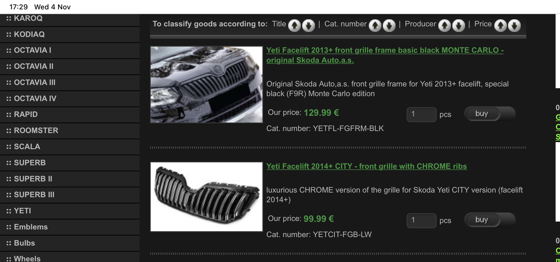

Superskoda
I never cease to be amazed by peoples willingless to pay far more than retail price plus delivery for parts from Superskoda.
Mine was the black grille which is more expensive than the chrome one shown there (go figure!) and cost me £57.93 from TPS with 8% discount which was given right off the bat without ever being asked for. Retail price £62.97.
Delivered to my door from their van the day after the order.
Part number for the OP (black grille) is 5L085366B9B9
