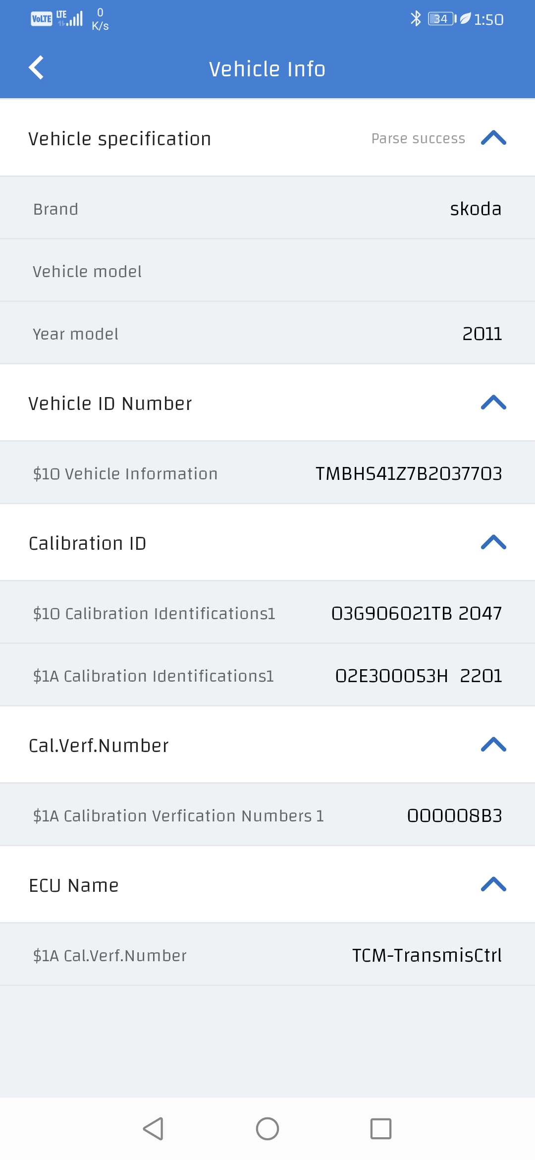

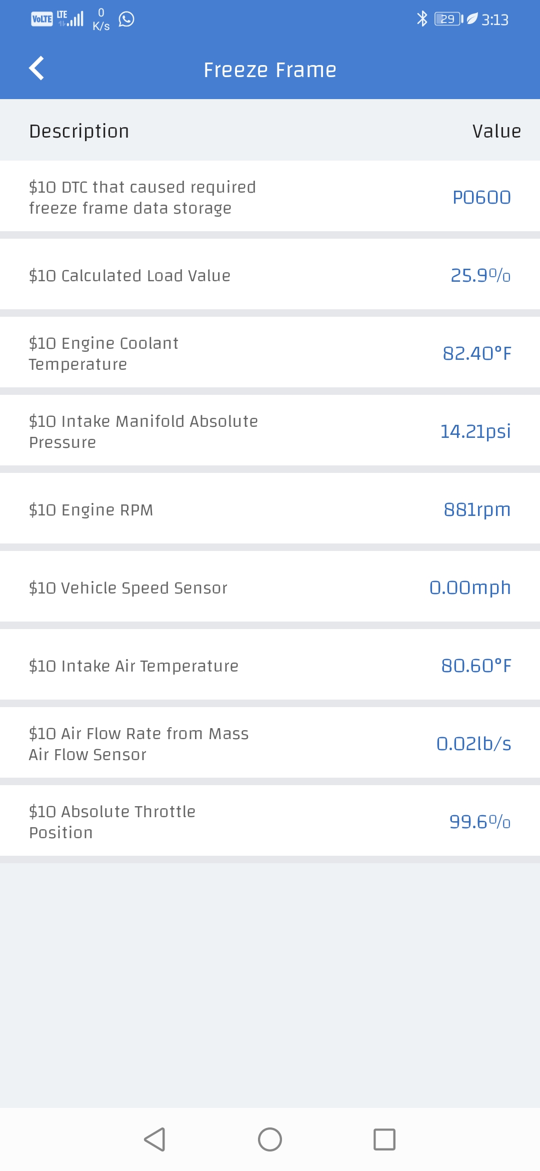

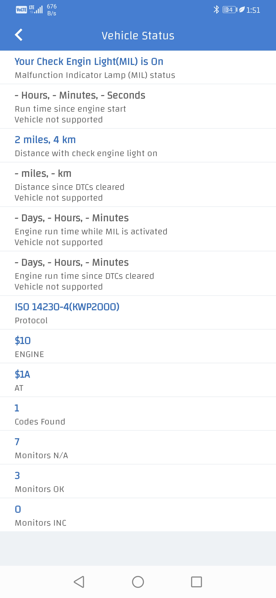

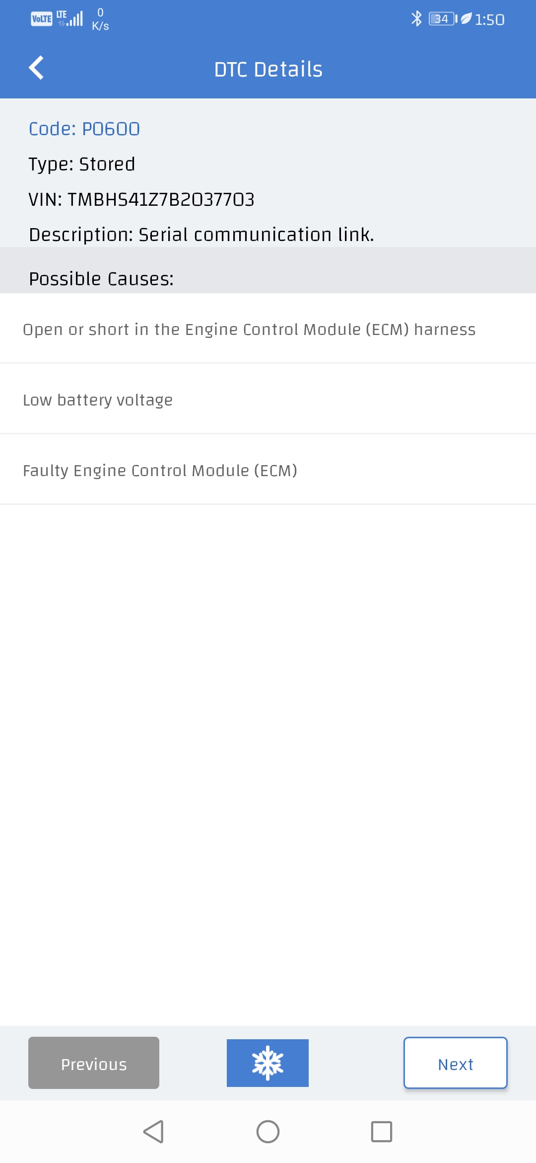

I borrowed a OBDII scanner ( this is an universal scanner, not the official for Skoda) and it show me a failure code: P0600. I attach the screenshots whit all the info that I collected with this scanner.
