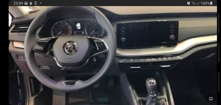

Also  has anyone have an Octi 4 without virtual cockpit but analogue dials (pic bellow)... I would love to see a video that version for the speedo cluster.

No idea on the analogue dash. I think this pic is preprod, from when the car was still in testing.
