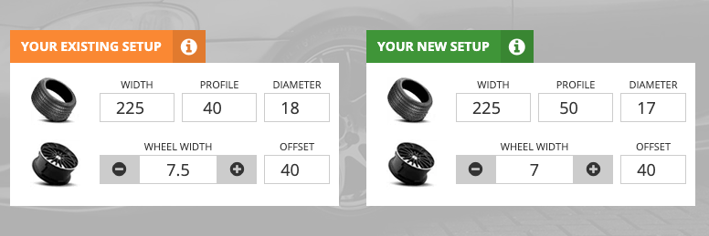

So today I changed the wheels and tyres from 225/40r18 (7.5") to 225/50r17
I got an excellent deal on the 17" wheels from a 2020 Octavia buyer - 17x7" for AU$200 (EURO140-ish) - and went up from the recommended 215/50 to 225/50 (the VW Passat uses this size as standard)

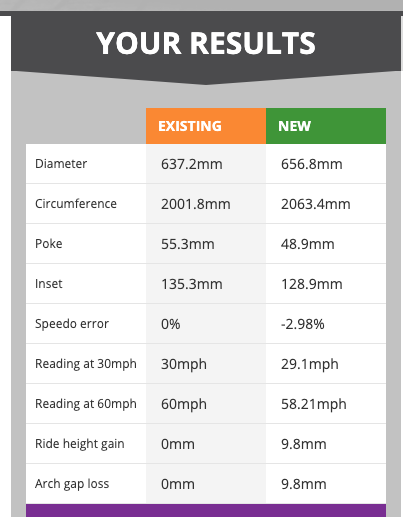

Think I can live with the difference to speed and ODO. I know the speed reads fast anyway.
The arch gap loss is not noticeable. I guess its  0.5cm either side.

According to GPS, the speedo is now showing the exact speed. (GPS and speedo show same)
