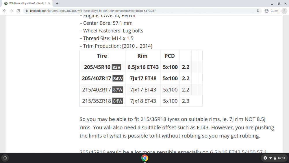

This is what it says on wheel-size.com
Skoda Fabia 2012 1.4TSI VRS
– Generation: Mk2 5J [2007 .. 2014] [EUDM]
– Power: 177 hp | 132 kW | 179 PS
– Engine: CAVE, I4, Petrol
– Center Bore: 57.1 mm
– Wheel Fasteners: Lug bolts
– Thread Size: M14 x 1.5
– Trim Production: [2010 .. 2014]
Tire
Rim
PCD
205/45R16 83V 6.5Jx16 ET43 5x100 2.2
205/40ZR17 84W 7Jx17 ET48 5x100 2.2
215/40ZR17 87W 7Jx17 ET43 5x100 2.2
215/35ZR18 84W 7Jx18 ET43 5x100 2.3
So you may be able to fit 215/35R18 tyres on suitable rims, ie. 7J rim NOT 8.5J rims. You will also need a suitable offset such as ET43. However, you are pushing the limits of what is possible to fit without rubbing so you may get rubbing.

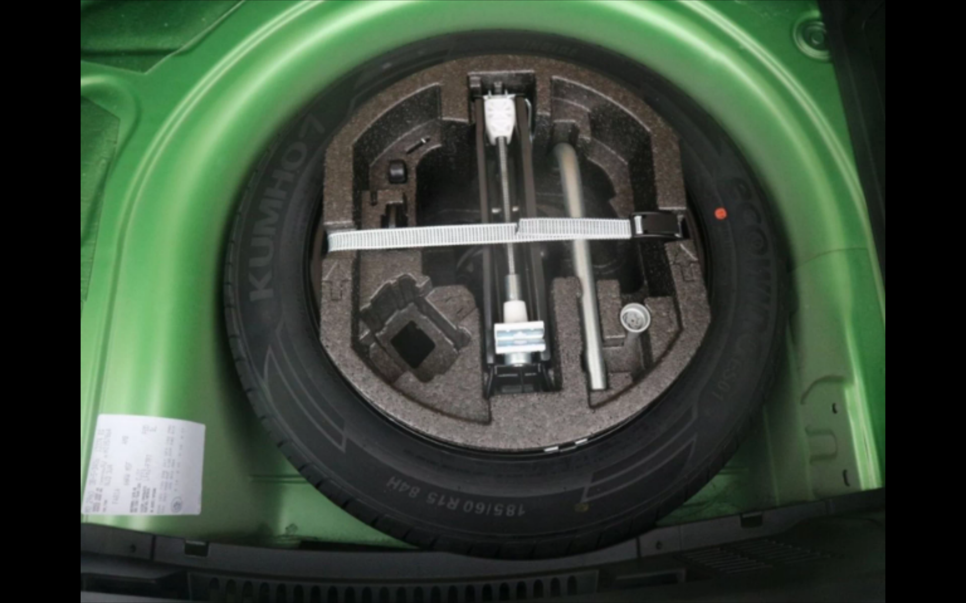

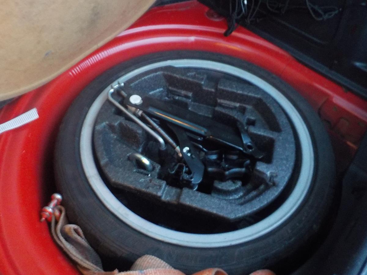

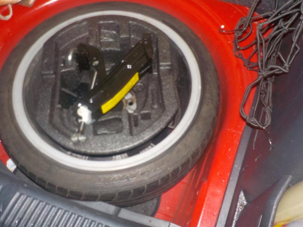

The full size alloy and tyre to match what you fit on the car will fit in the Spare Tyre Well.

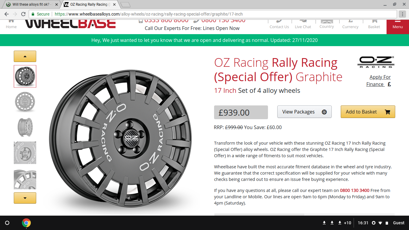

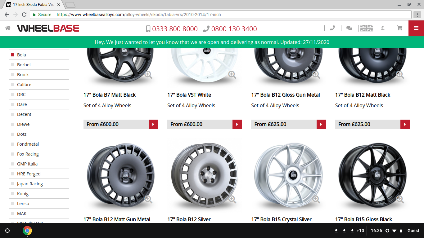

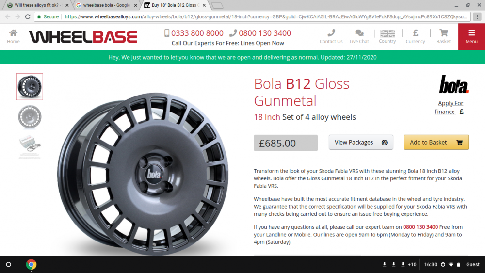

There are Bola ones or i have on order OZ ones similar in 17" for my Corsa,
Maybe in your fitment in 18" or 17" which really might be best for tyres.

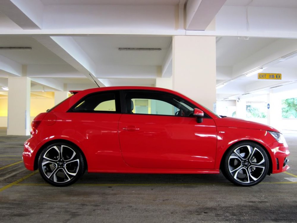

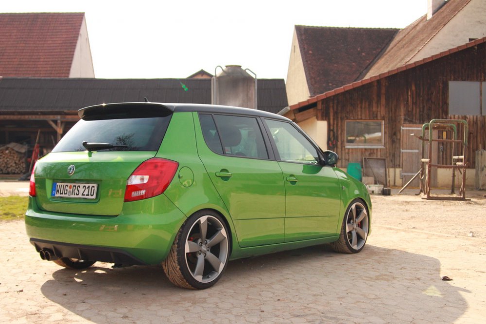

The 18" rims are the Polygram as fitted to the A1 Competition Line 1.4 TSI 122ps.  MY2012.  ( A1 in Red or the stickered up ones..) Horrible IMO.
Or the other styles OEM or aftermarket.
7.5 x18 ET 39.5 5x100
