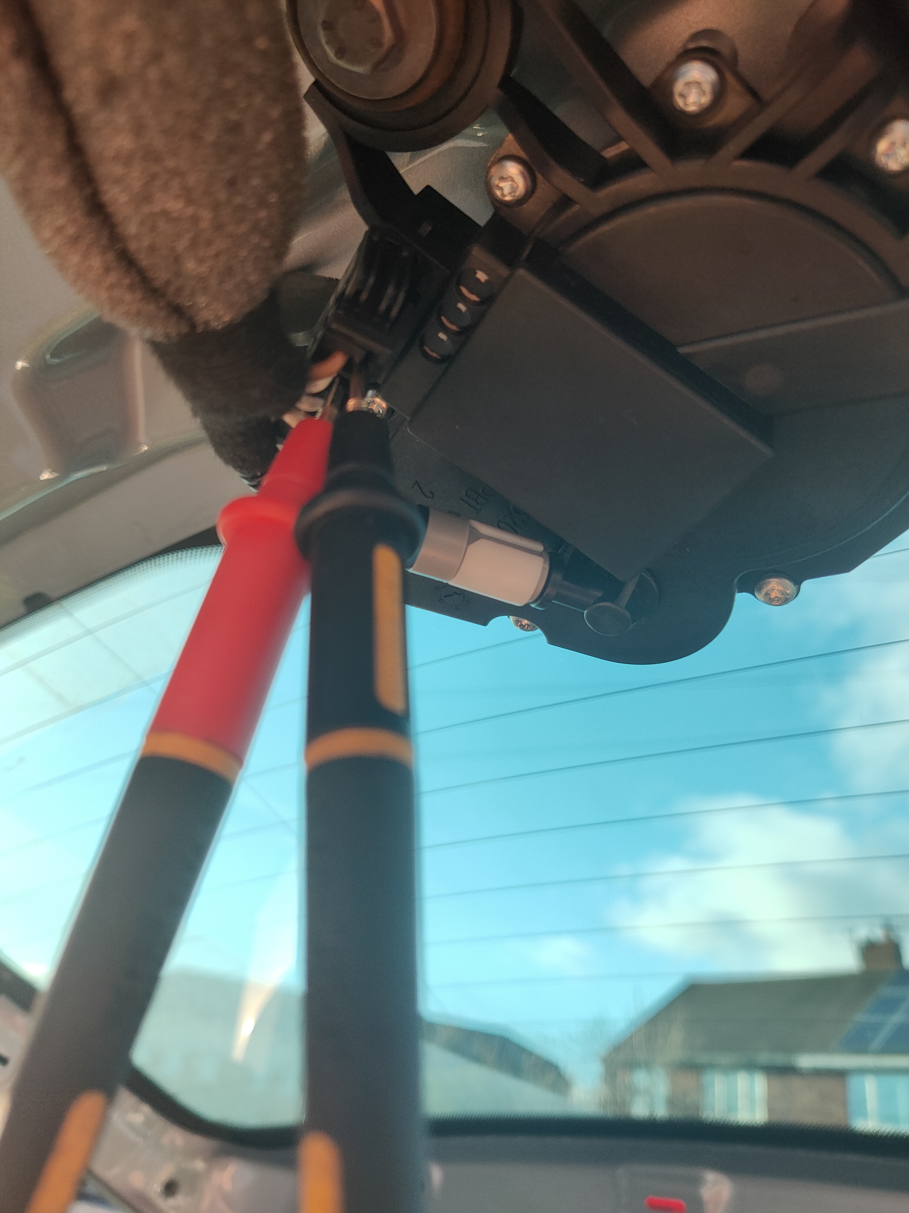

I can assure you that either there's a short in the wiring loom or there's a fault in the BCM that's shorting that line down to ground. If you read the last post on my other thread about the rear wiper not working you'll see I've investigated the operation of the wiper motor so today I checked for shorts;

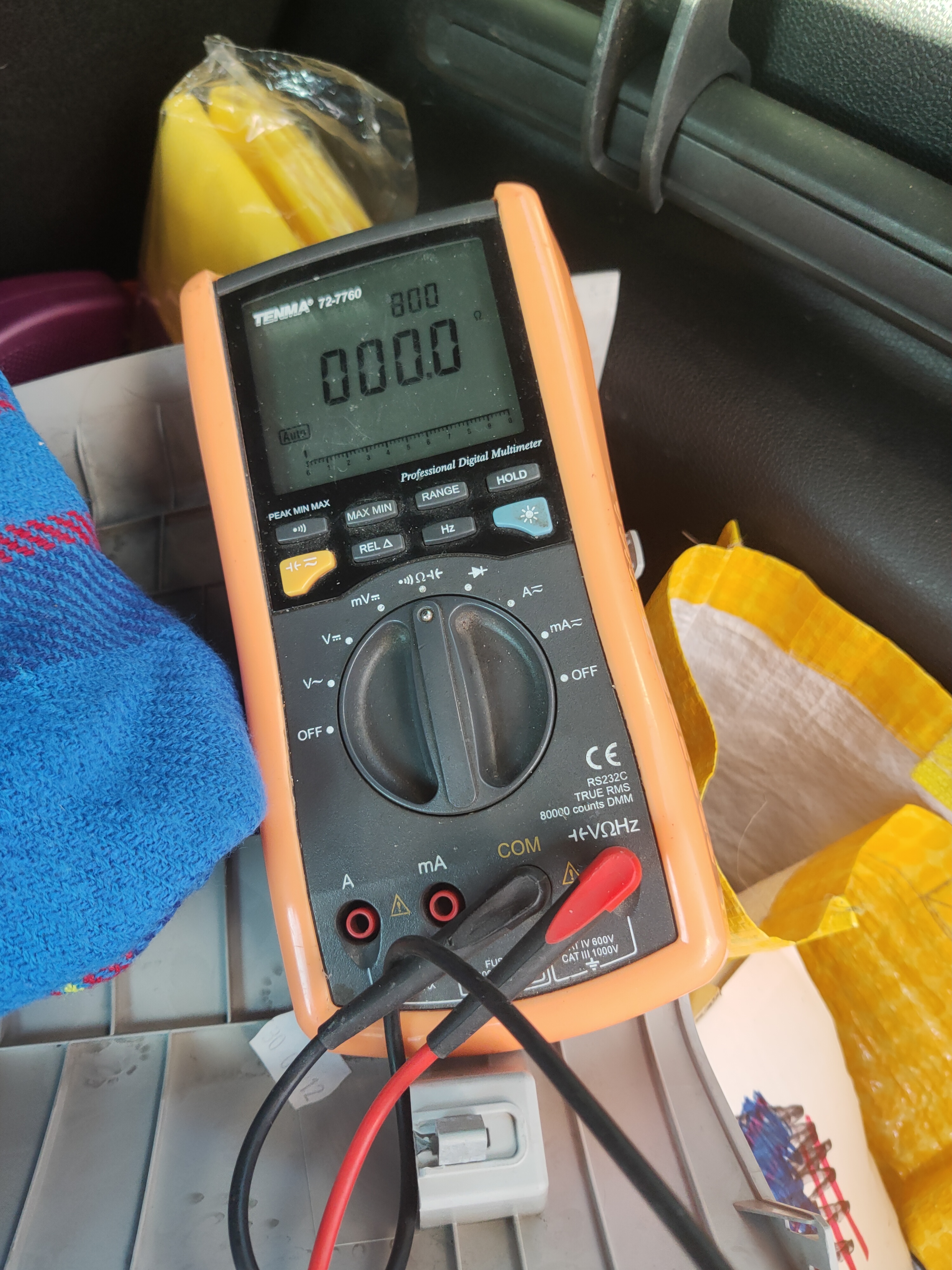

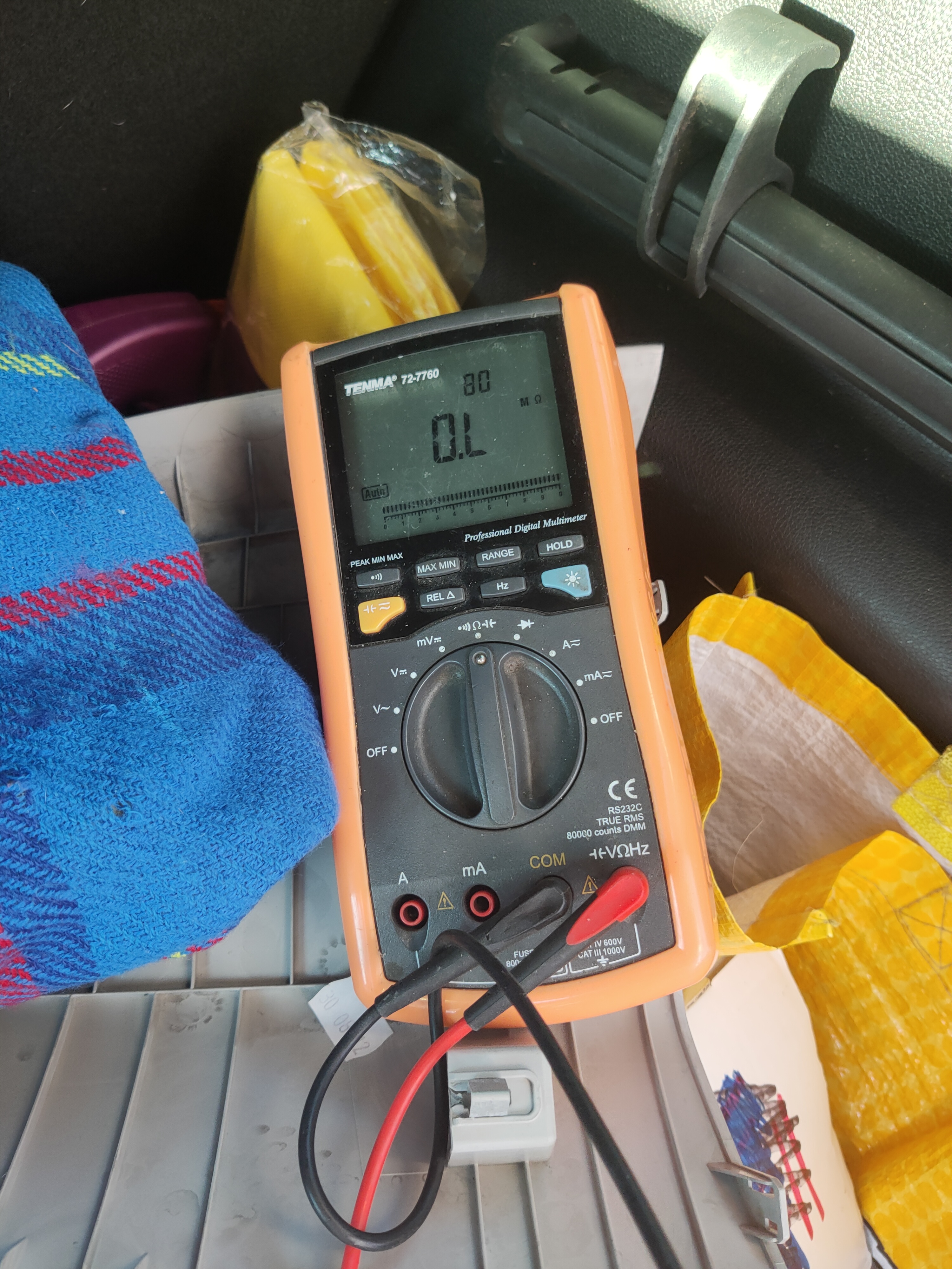

Multimeter connected at the motor plug;
Direct short to ground with both ignition on and off, irrespective of stalk position.

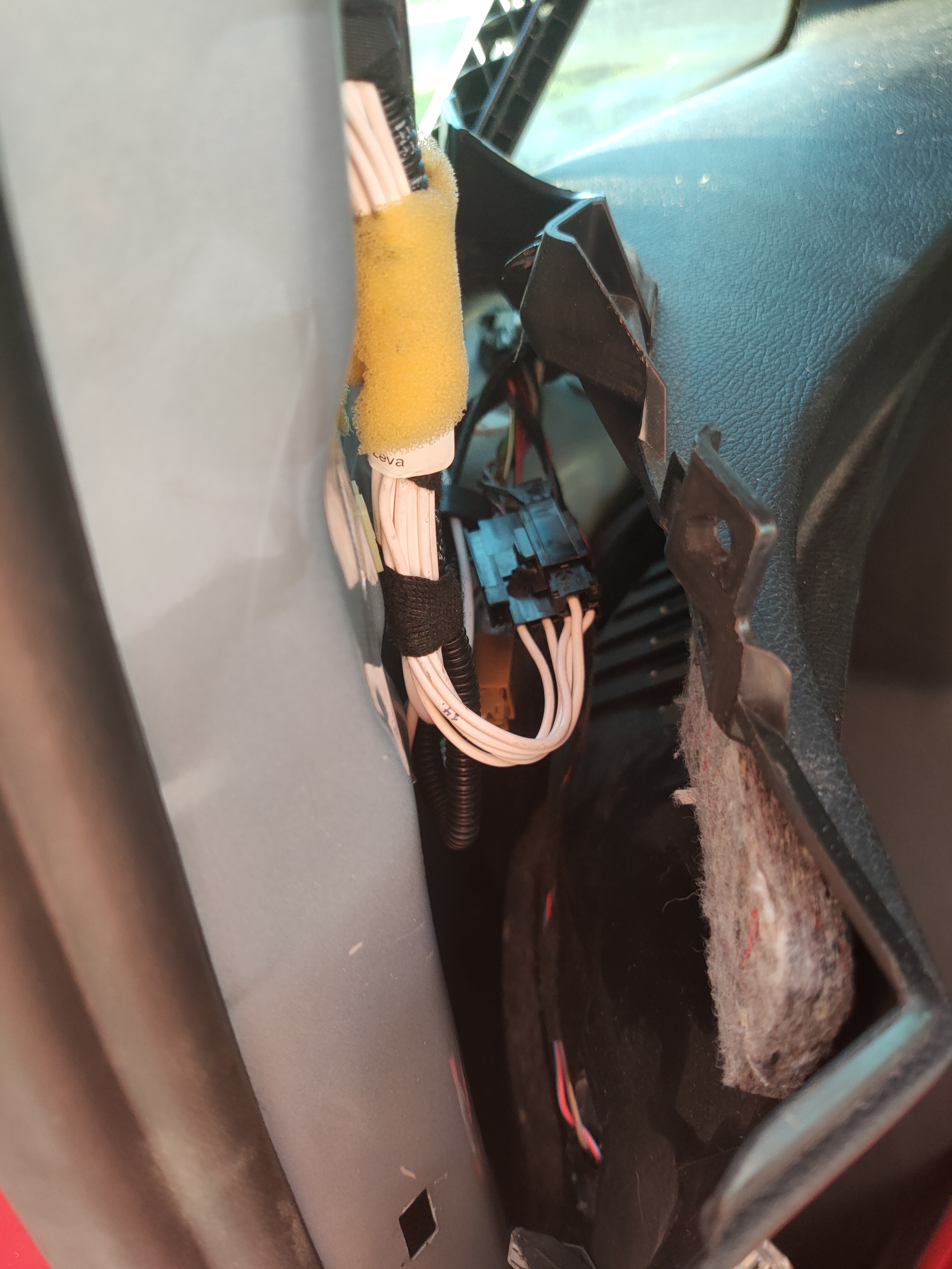

Disconnected this plug inside the D pillar behind the trim panel;
Short circuit gone.

OK, so judging by your photo the short is between the brown earth wire and the white wire nearest to it?
That white wire becomes a green/red one at pin 2 of the five-way connector you've found. From there it heads forward to the BCM, pin 2 of the white 52-way connector. At some point before getting there, it also tees off to the washer pump motor, so there's the possibility of a short in that leg of the wiring too. Do the windscreen washers work, front and rear?

I should mention that BOTH white wires appear short circuited to ground, which is why the motor is running all the time.
On the wiper motor, it looks like the pinout is as follows;
1 - Ground
2 - Intermittent wipe (when connected to ground)
3 - Constant wipe (when connected to 12V, AND when pin 2 connected to ground)
4 - +12V
It's pin 2 at the washer motor that I need to trace out, looks like pin 3 is the one that goes directly to the washer fluid motor, could you please trace that other wire for me? I really appreciate your assistance with this.
