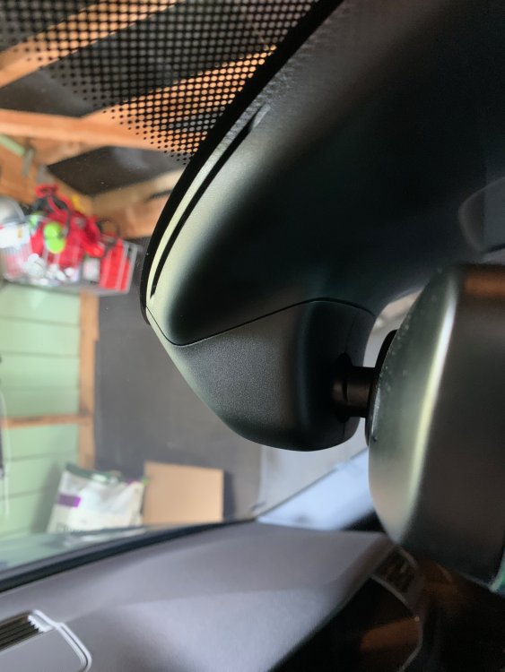

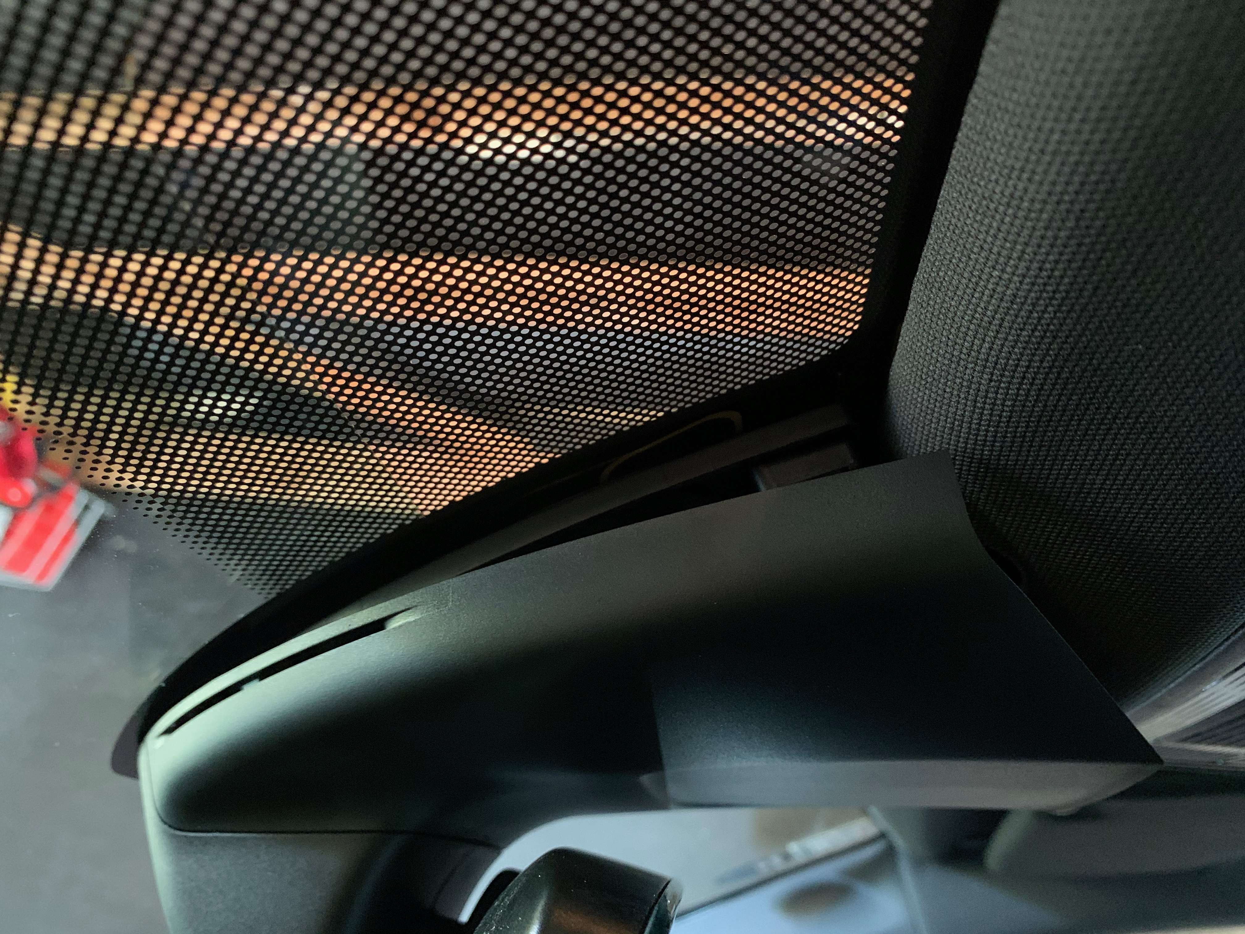

Does anyone know how to remove the plastic "cups" that surround the rear view mirror?

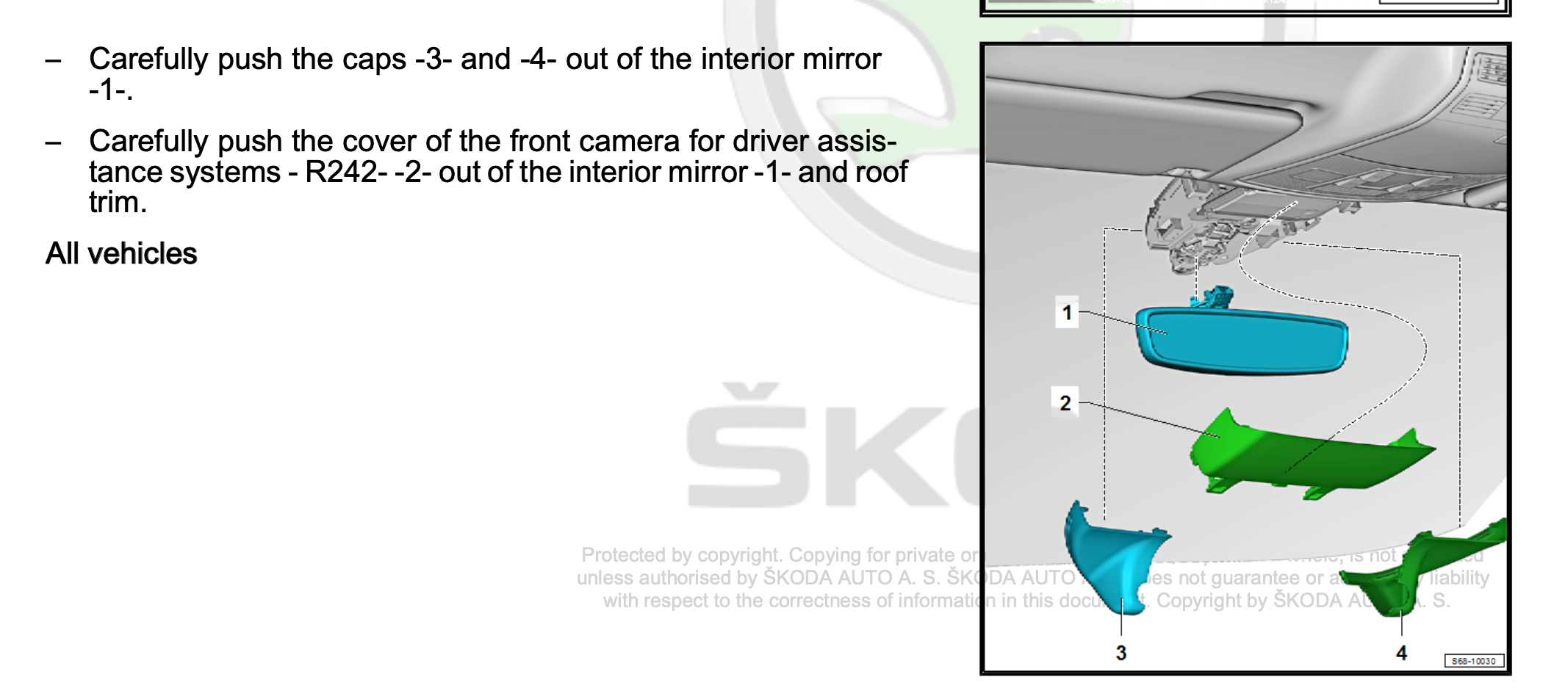

I downloaded the manual from Erwin but the pictures look nothing like what I have in my car.
This is what it looks like:
IMG_0716.thumb.jpeg.57f4a545bed6206754a7028ca86fa369.jpegIMG_0717.thumb.jpeg.1d27bf9cef25dfa3ac5bce3d41f7b6fd.jpeg
This is what Erwin thinks it looks like:
144399515_ScreenShot2020-12-17at4_16_13PM.thumb.png.56c1dbab8c903bde1b5c64f7efc2e102.png
The only thing that pulls down easily is this part:
But I can't figure out how to get those two cups that surround the stalk of the rvm off without snapping something
Any thoughts?

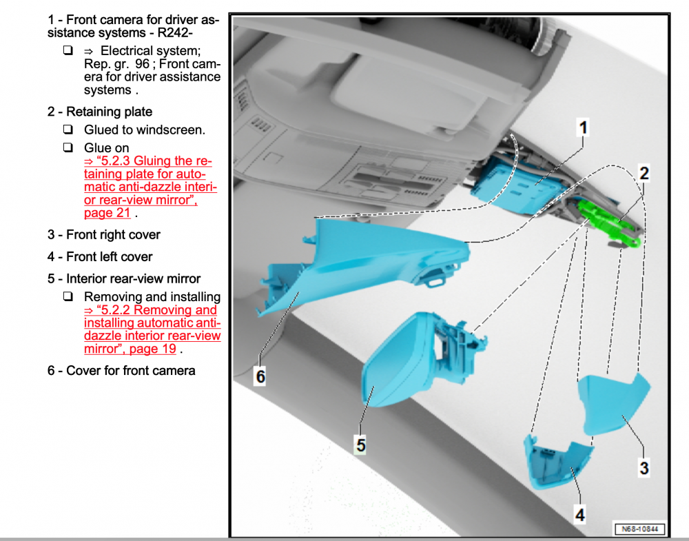

And ironically the summary of parts in the workshop manual shows it well, just not the removal page:
529277139_ScreenShot2020-12-17at4_42_44PM.thumb.png.03364b7b421d39fd420c005dcc9e6278.png

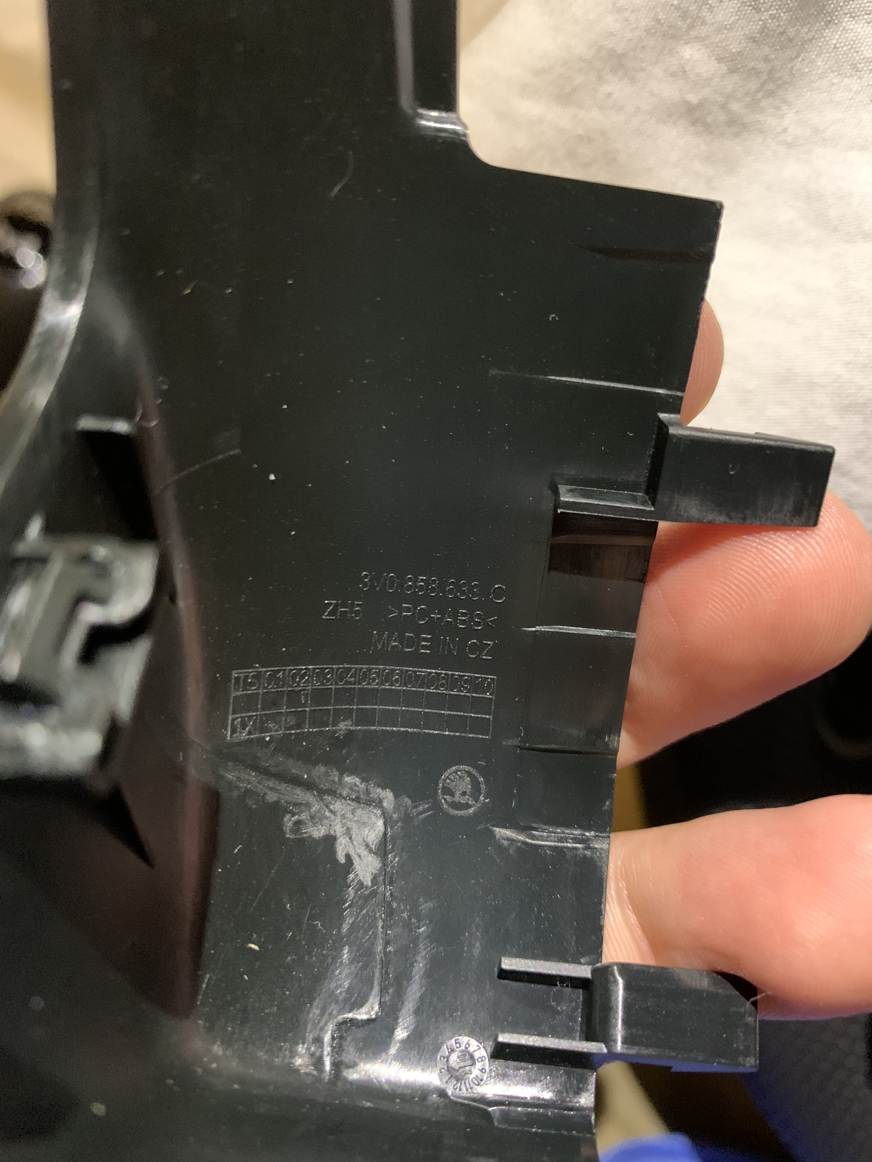

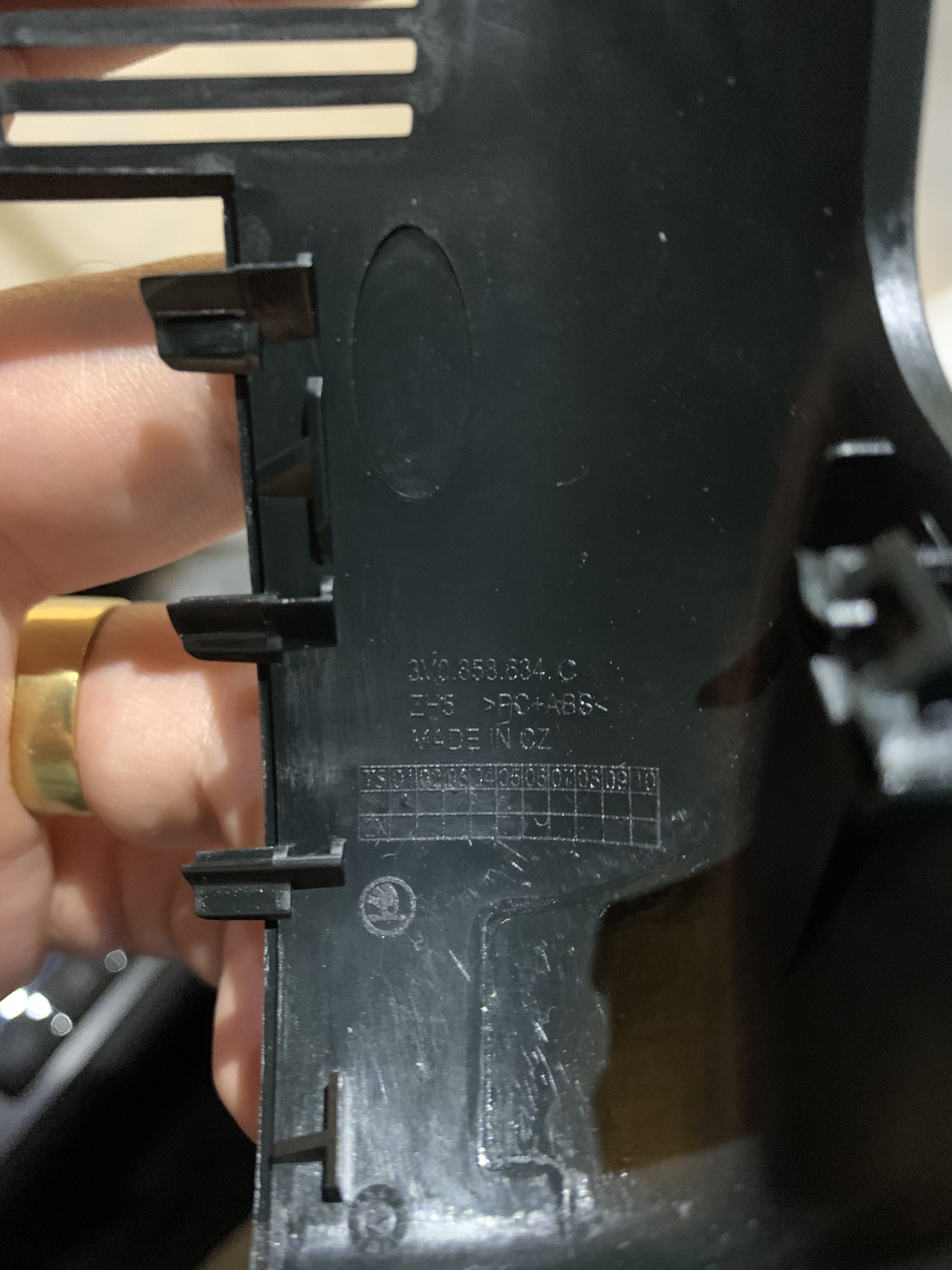

I took pictures of the part numbers for those interested
