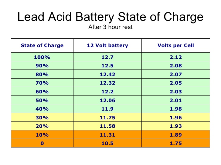

Resting voltage (nothing connected, and not recently in use or on charge) of a fully charged lead-acid battery is about 12.6/12.7V.
Charging voltage has to be higher, and for a while afterwards the battery will still show this higher voltage. After an hour or two it'll show the 12.6ish volts if fully charged and the car isn't taking excessive current in its  'fully shut down' state. See below.

I conected my charger up and it read 12.06 % which the list above shows as 50% charge so I dumped it and bought a new battery.
