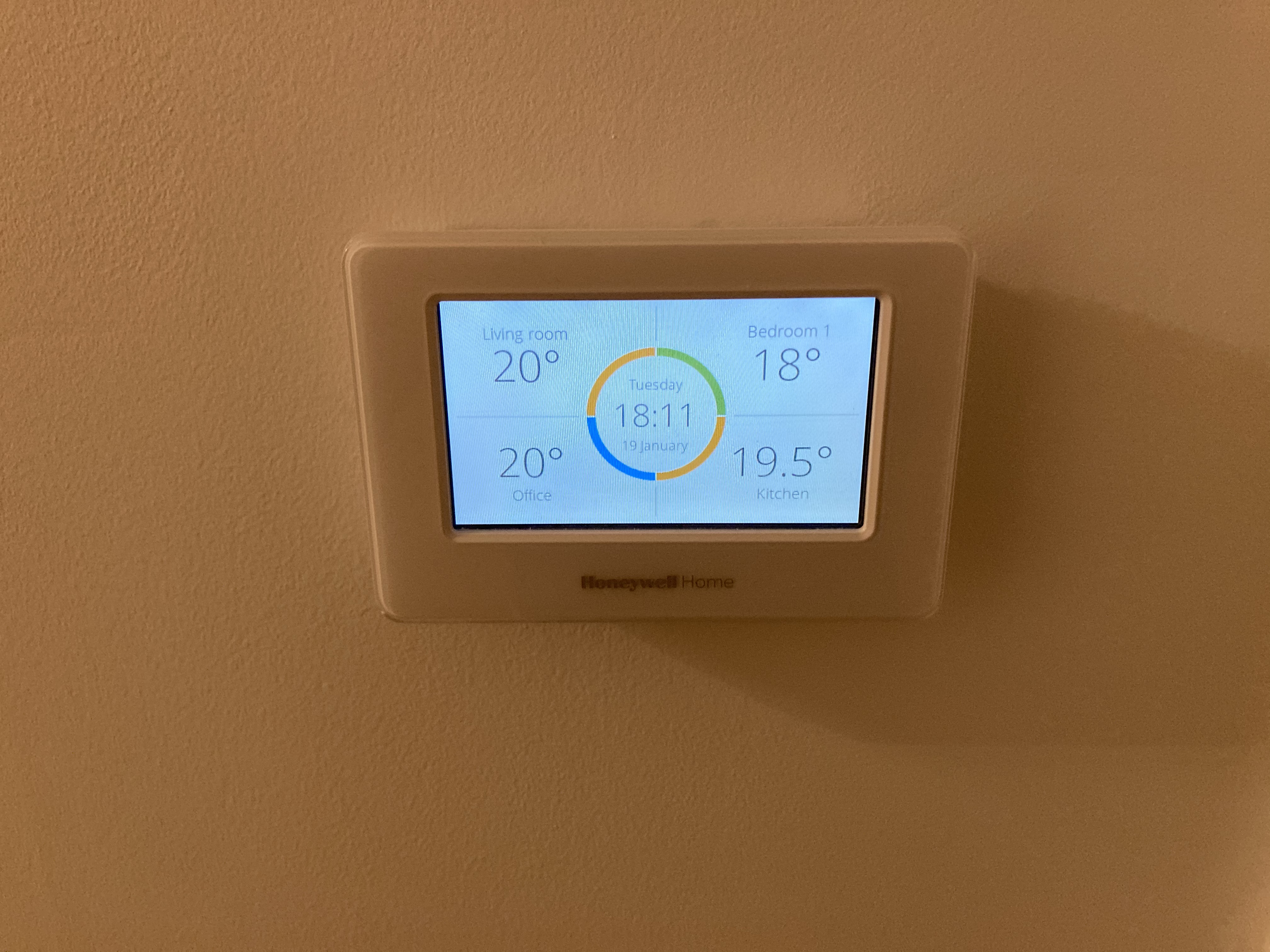

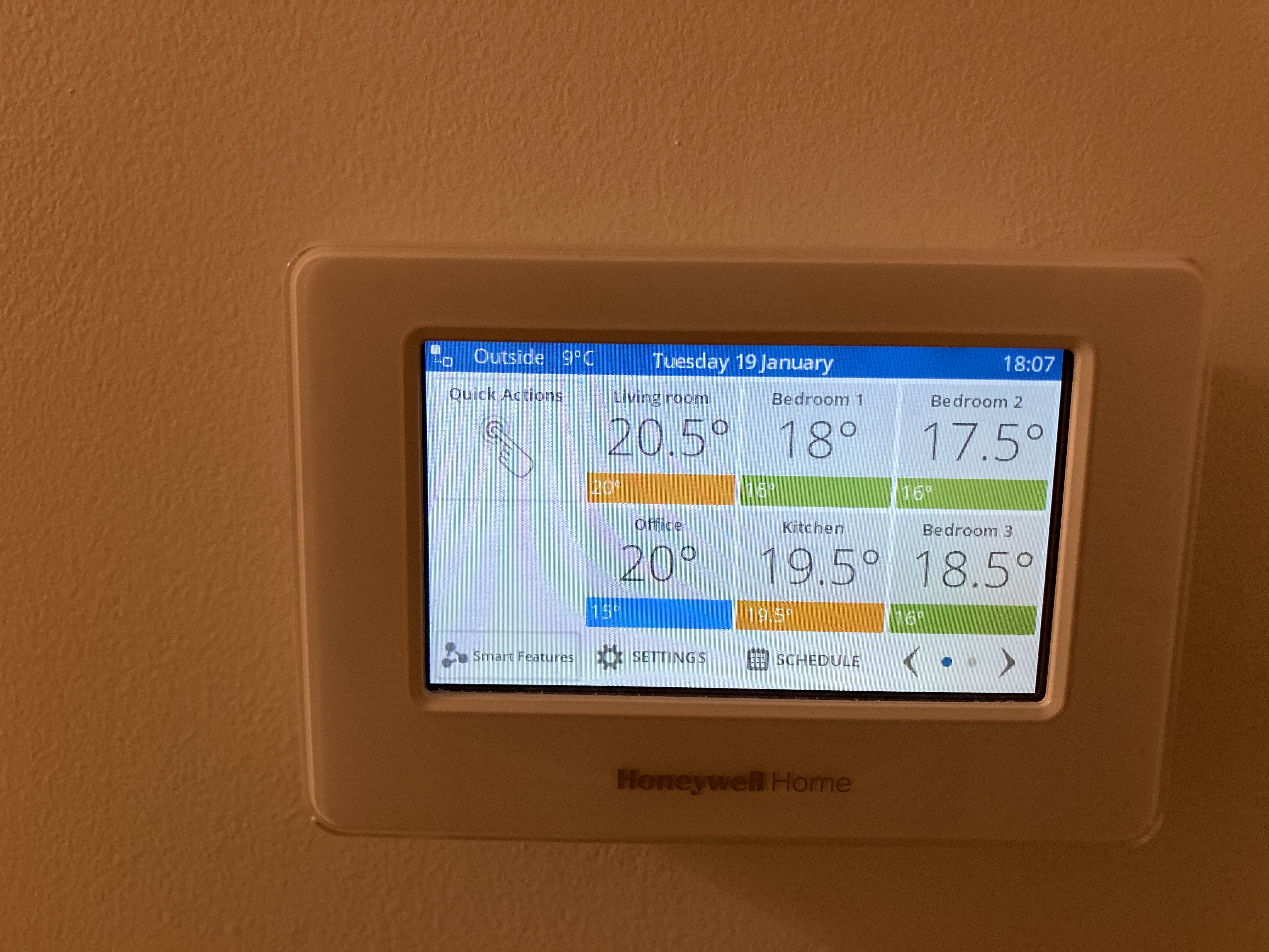

Smart stat was a Honeywell evohome in the end and I have to say it’s much better than nest etc.
It doesn’t directly have geofencing, which I never really fancied anyway. That however is more made up for by rooms as zones, optimised starts + stops and weather compensation :)
Wifi controller, pairs with a Honeywell brd91 relay (found in most Honeywell wireless stats) or their opentherm bridge.
Controller has a stand and a wall mount transformer which fits in a single gang back box. It’s neatly on a wall looking very sci-fi.
7 smart TRV and a separate room stat for one room where the trv is hidden behind something.
The app is pretty good and best of all it works properly bar the app even if there is no internet.
The biggest downside is the cost if you buy it all separately, but buy a starter kit and it’s not much more than a single zone nest/hive.
