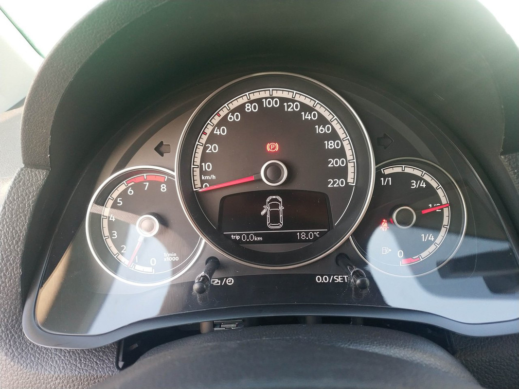

After a lot of search and thanks to a great guy from Netherlands VW club and Nefmoto forum (Bonny Gijzen) , maxidot cluster is installed!!!!!
It is gorgeous, to say the least, compared to stock green LCD cluster...
Bonny not only coded immo data, but also changed welcome screen to Skoda (cluster came from  a VW UP) and corrected km...
I also installed MFA buttons which worked straight away without even needing coding..

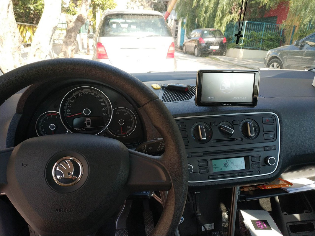

So ....here it is.....

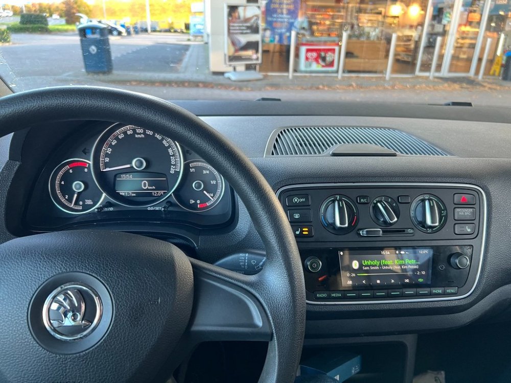

Cool, we went to the same guy! (Bonny)
This was taken a few minutes after it was all done:
