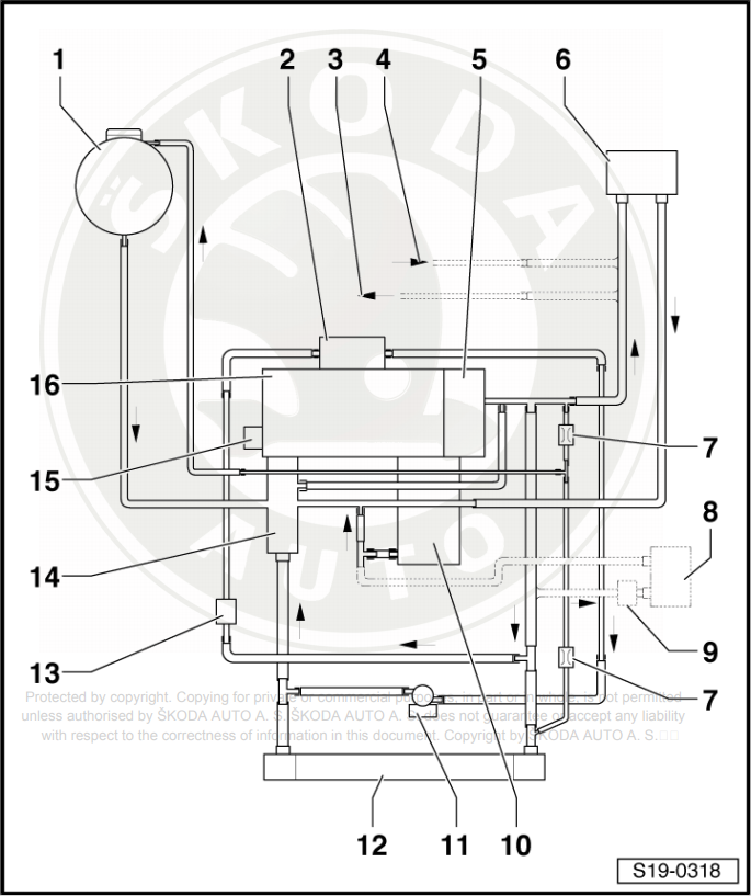

I believe the cooling system layout looks like this on CR engines:
Where:
1 - Expansion reservoir
2 - Radiator for exhaust gas re‐circulation
3 - to auxiliary heating
4 - from the auxiliary heating
5 - Cylinder block
6 - Heat exchanger of heating system
7 - Throttle valve
8 - ATF radiator
9 - Coolant regulator
10 - Engine oil cooler
11 - Coolant recirculation pump 2 -V178-
12 - Radiator
13 - Coolant temperature sender at radiator outlet -G83-
14 - 4/2 way valve with coolant regulator
15 - Coolant pump
16 - Cylinder head
The question in my mind is where should the inline thermostat go given the original one is a 4/2 way valve rather than just an inline thermostat?
I'd be concerned that an incorrectly placed inline thermostat could cause sections/components to overheat or even block the flow to/from the coolant pumps. I don't know enough about exactly how the system works to suggest a location :)
