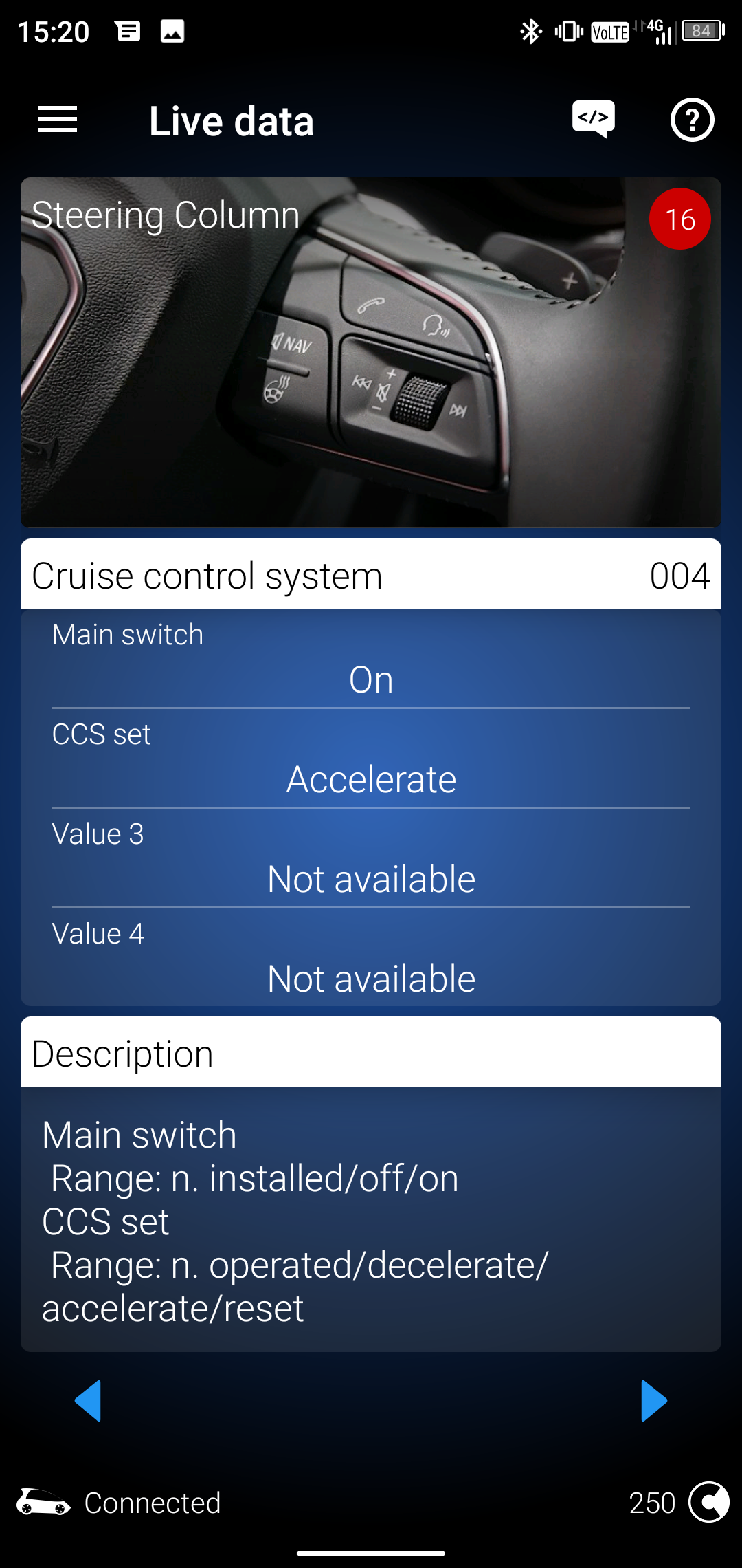

It's a base model, swapped steering controller & stalk. On checking live data the CC stalk inputs are detected on 16 steering wheel but are not detected on 1 engine. I assume this means I need an additional wire from controller to ECU? would anyone be able to help me with pin numbers on both the ECU and steering controller?
Also on 16, I get main switch on or off, accelerate, decelerate and saved off but no "set"? Is this correct?

Thanks very much Trev, was reading through the pdf earlier and noticed I had missed the engine coding step hence nothing coming through on the engine live data, works a treat now!
