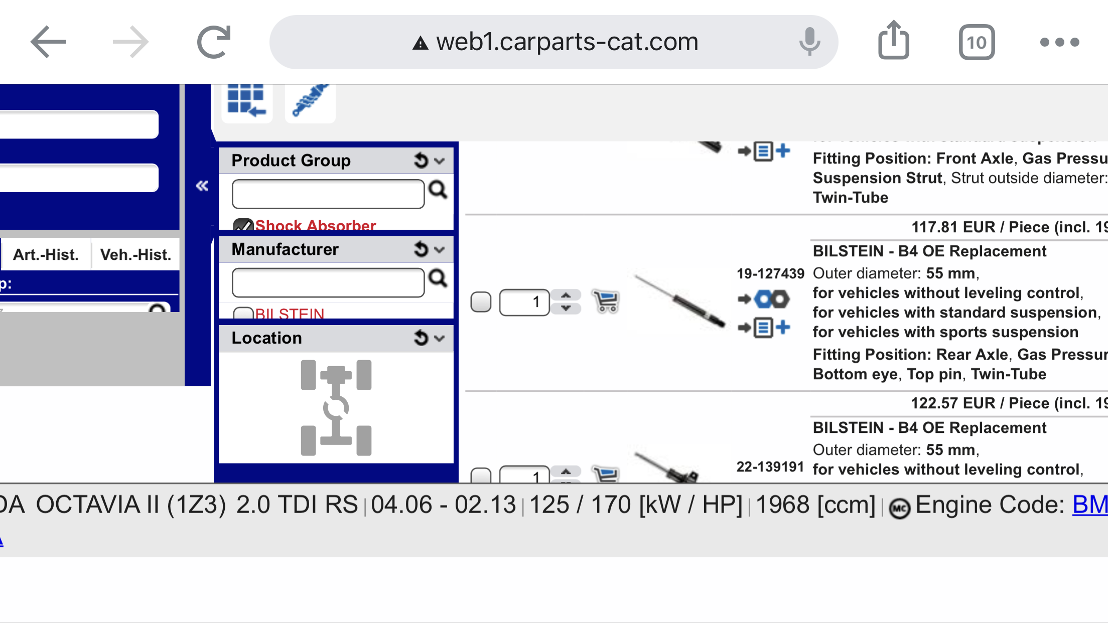

Checked their site. Good price , although my chassis is 1Z2 should be same fit
not 1Z3? The bilstein web catalogue
Checked only listing 19-127439. Dont know what difference there is between 1Z2 & 1Z3 models
Have seen 1Z3 is octavia 2 hatchback & 1Z2 is Octavia 2 larger fuel tank ?
