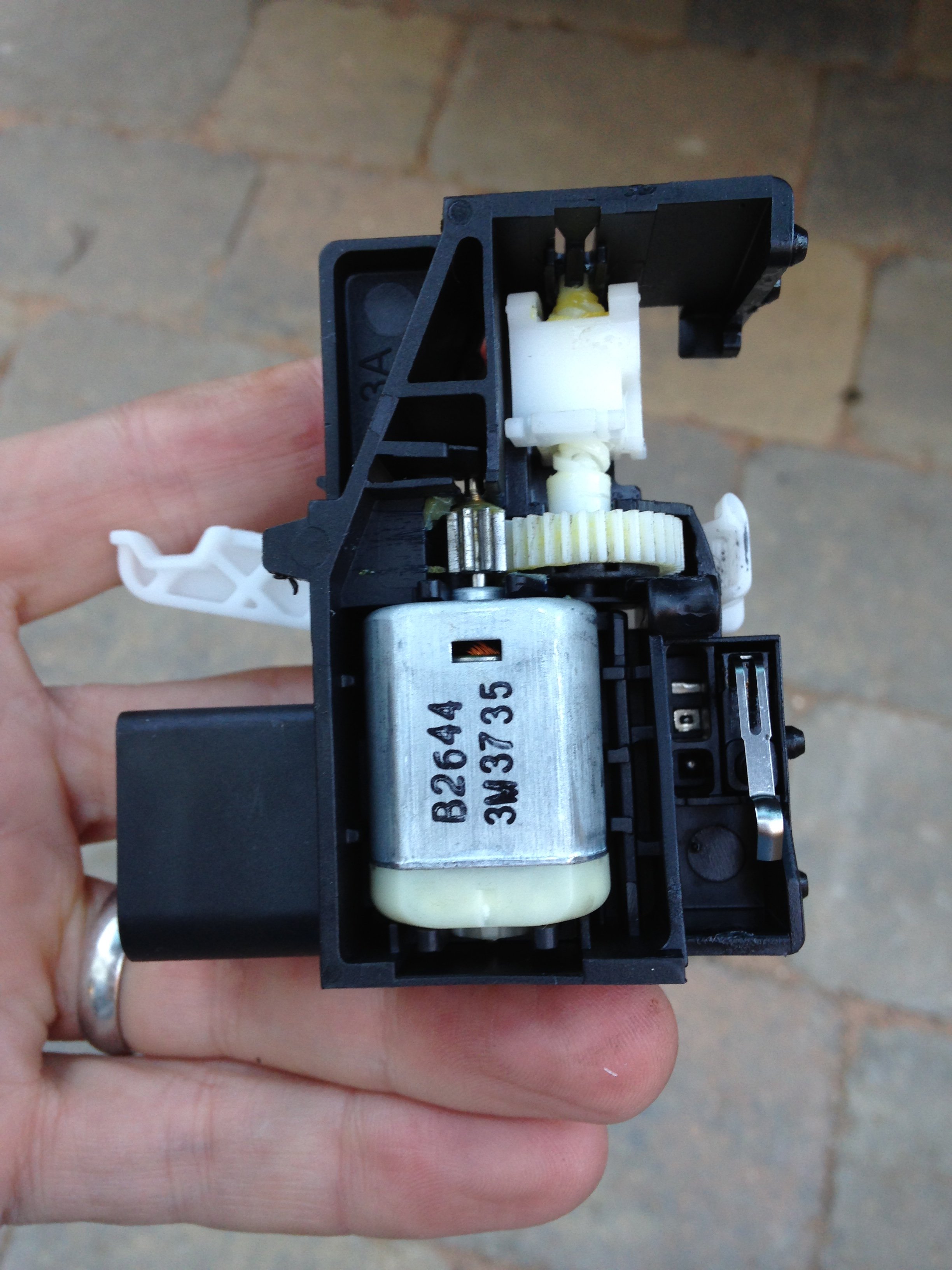

If it helps, this is what it looks like inside. The white plastic lever is the emergency release.  The plastic shaft from the gear on the right can shear, leaving the unit unserviceable (this is what happened to mine).
Ah so that's what it looks like inside.  I'm guessing that the white bit rotates and that unblocks the black bit of the hook on the latch and it can swing round and open?  Perhaps there was frost/ice in the black hook bit of the latch mechanism holding it shut then.  If the white bit had sheared off it wouldn't have started working ok again afterwards would it?
It’s a screw-linear actuator- the motor turns the gear, which has a worm gear type of shaft, which moves the white plastic block up, which pushes on the latch to pop it open.  The motor only turns a few revs until the plastic block reaches the end of its travel. When power is released the mechanism rewinds back to the beginning.
