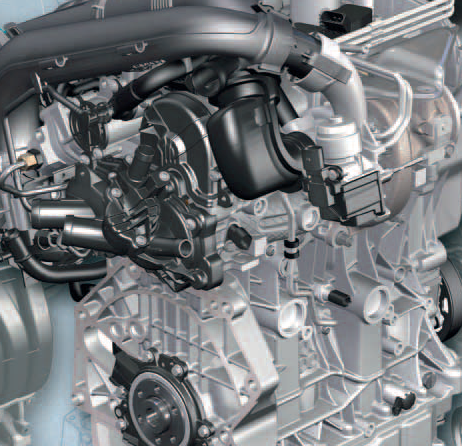

I don't know where the coolant temperature sensor is but I have found this image:-
''Coolant temperature sender G62'' appears to be attached to the back of the engine in between the turbo and the water pump.
The water pump is fitted to the cylinder head on the gearbox end of the engine.
This image is looking at the engine from behind, as if you were in the left hand seat, passenger seat for UK.
