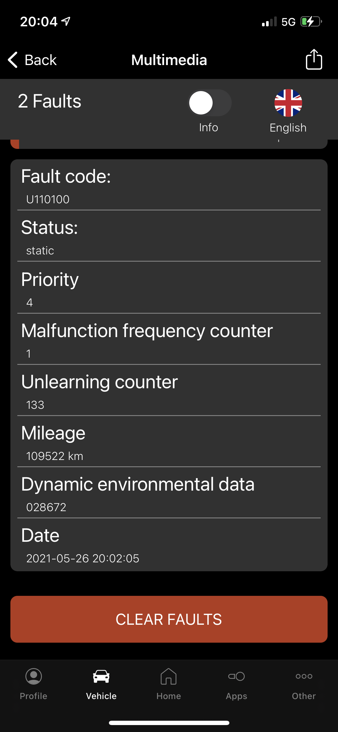

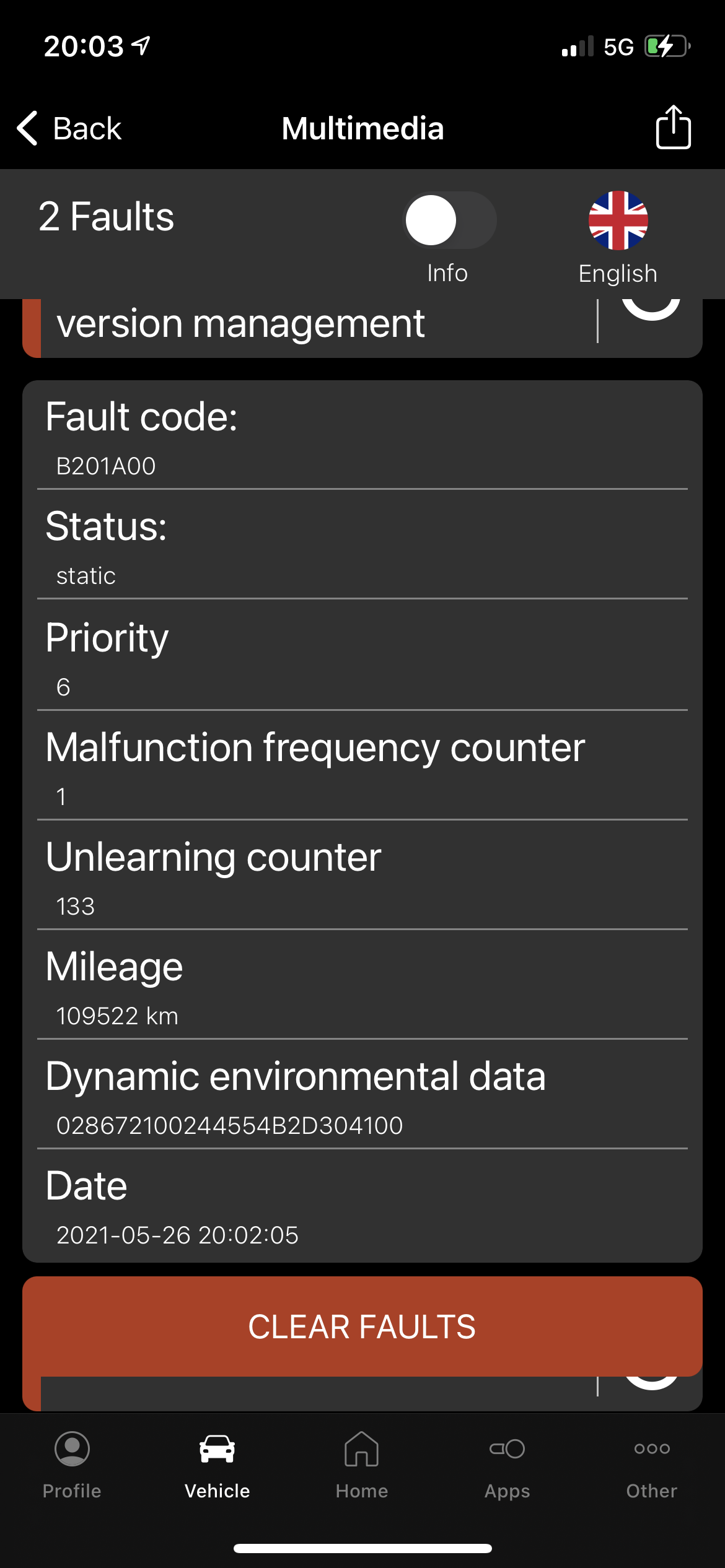

Now I’m even more confused. Because I noticed this when looking at the fault codes. The mileage reads +108k. Where as there is 68k on the clocks. Now the stereo isn’t the original, so is that the mileage from the car the stereo was removed? Or has my car been messed with?

From the main vehicle page the year doesn’t match....
109km is roughly equal to 68k mile.
Oh for goodness sake. Don’t I look a tool now 😂😂😂😂
Doesn’t explain the issue with the year though. I’ll dig out my paperwork tomorrow but it was definitely a 2014 car
Edited by somedudebob
If it was built after around May 2014 then it would have been a 2015 model even though it was registered in 2014.
Check the model year digit in the VIN - this is VW details but the model year still applies to Skodas VW VIN codes
Edited by PetrolDave
You are correct.  The 10th Digit is matching up with 2015 year, all be it first reg in 2014.
How very odd.
1 hour ago, somedudebob said:
How very odd.
Not odd at all.
Skoda and VAG always build cars for the following year they will be sold in. E.g. MY15 cars are built in 2014. Now what could have happened here is that due to popular demand of the MK3's at this time, Skoda UK might have asked for the MY15 model to be released from Czechia in 2014. This meant that certain models were put to market earlier than expected.
Remember that an MY starts usually in September the previous year and goes onto August the following year. It's all very misleading and you will only find out this when you go and visit the factory in Mladá Boleslav (Guess who's been ROFL).
Ah ok,  Yes that makes perfect sense, I just meant odd from my perspective, of assuming that the car would believe it was built the same year it was registered, Like Im expecting someone to code in a date of birth as it rolls out the factory or something.  Long and short of it is my worries of a clocked dud car have been alleviated.
