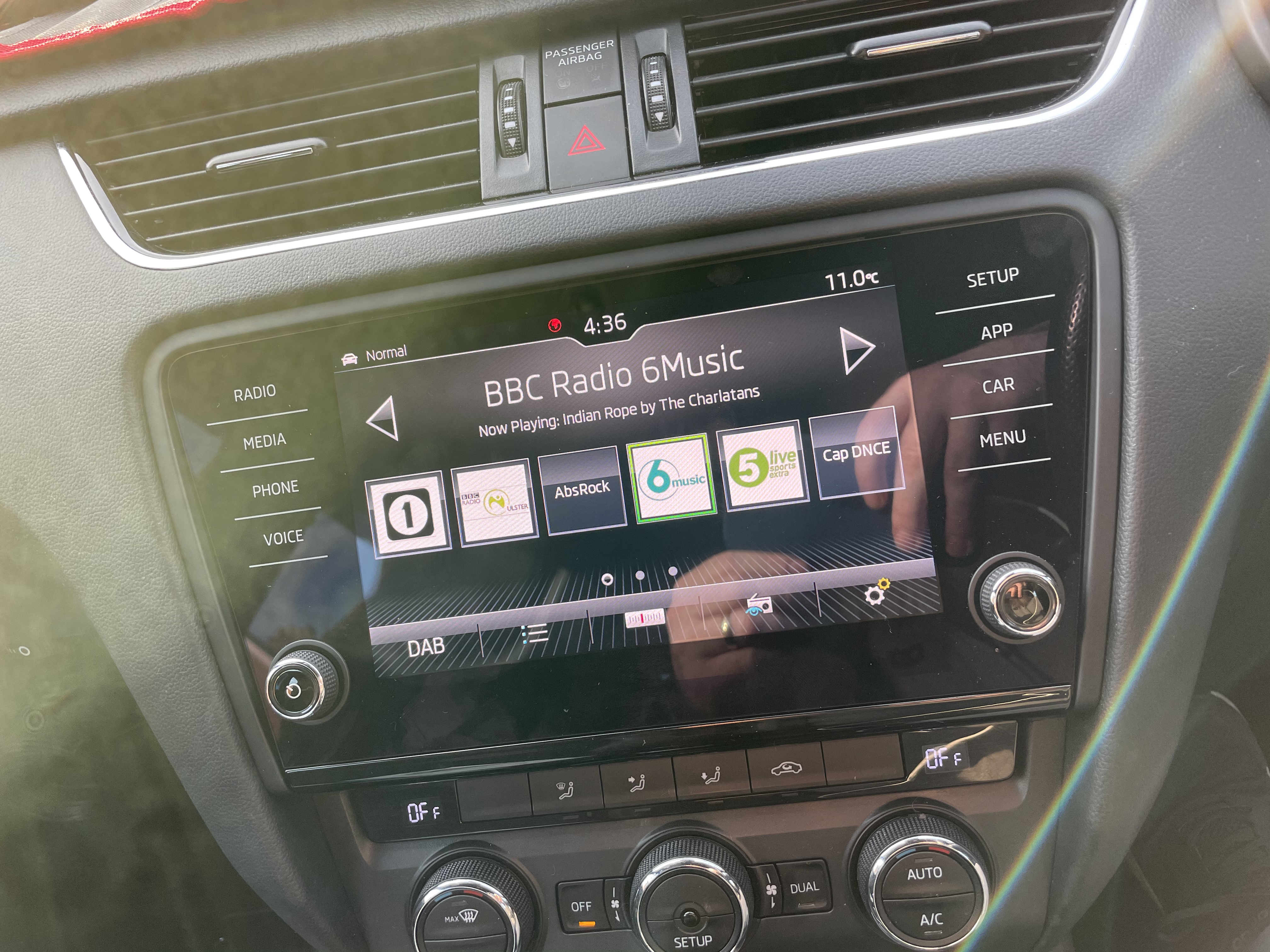

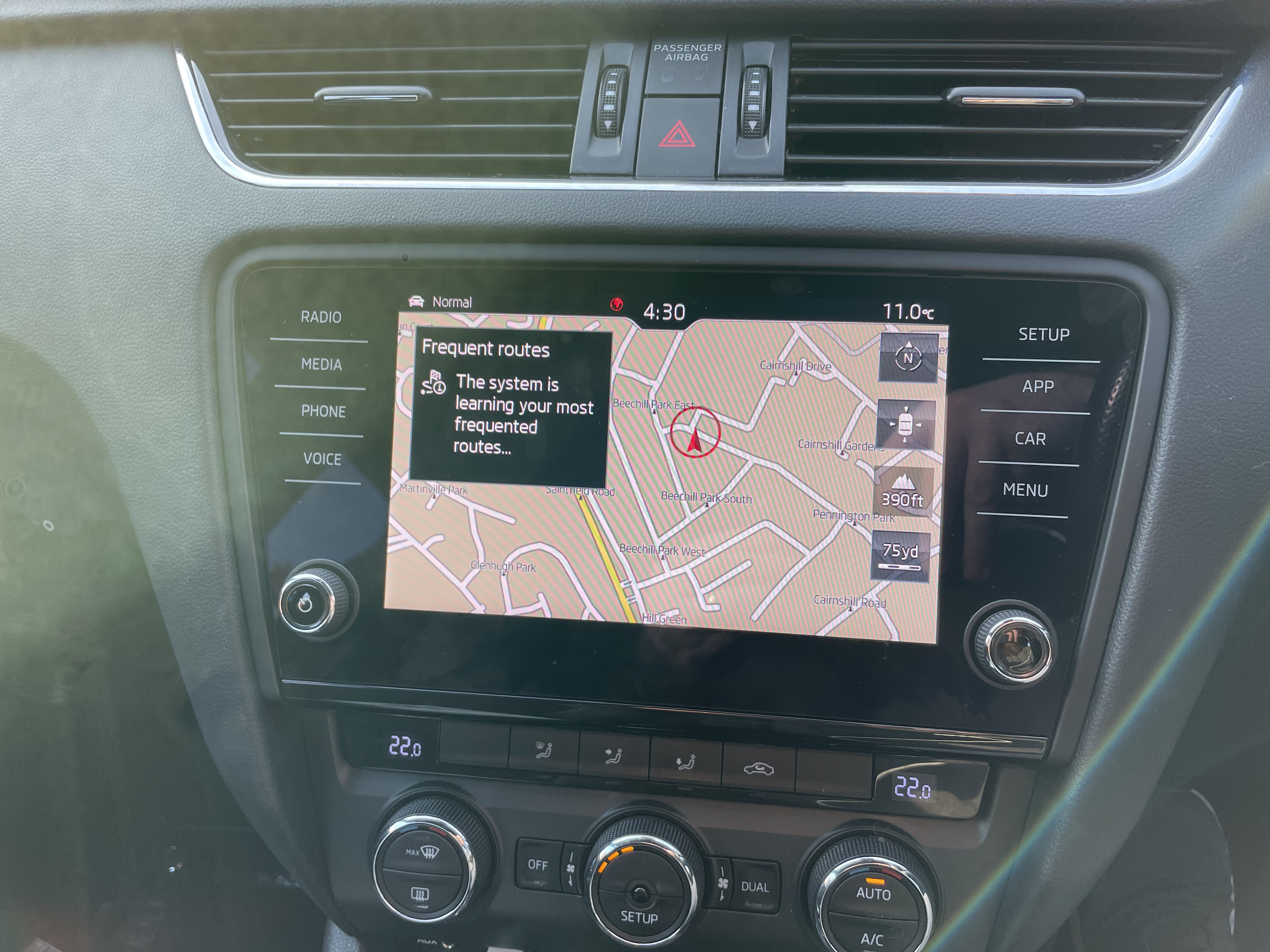

Well. I have to say. That went a lot smoother than expected and looks like everything working. Car play is there anyway! And just lifts the look of the whole interior.
even has an estate when in car mode.
thankfully all the reading I did on here paid off, knowing where to trim plugs etc in advance, how to remove the A/C control etc. So thank you all.
now to decide what’s next!

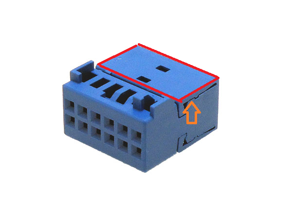

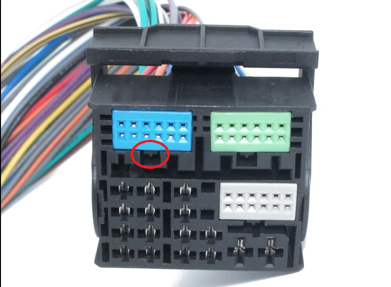

Got an image of your connector?
I assume it's this connecter and style:
You need to 'unlock' it first. There are two flaps that release, one on each side. I've marked one side up in red and I tend to unlock it using a tiny flatblade and sticking it in around the orange arrow.
The pin should slide in with very little effort and 'click' into place :)
Once it's unlocked you should be able to clear our any broken bits too.
Ah, This I did not know.  Any ideas how you release the blue clip from the black holder?
I had been assuming they just pushed in, but this explains it now.......
Thank you!
It just needs unclipping, it should slide out to the rear with little effort. I've circled the clip here, again a small flat blade to move the clip down works well:

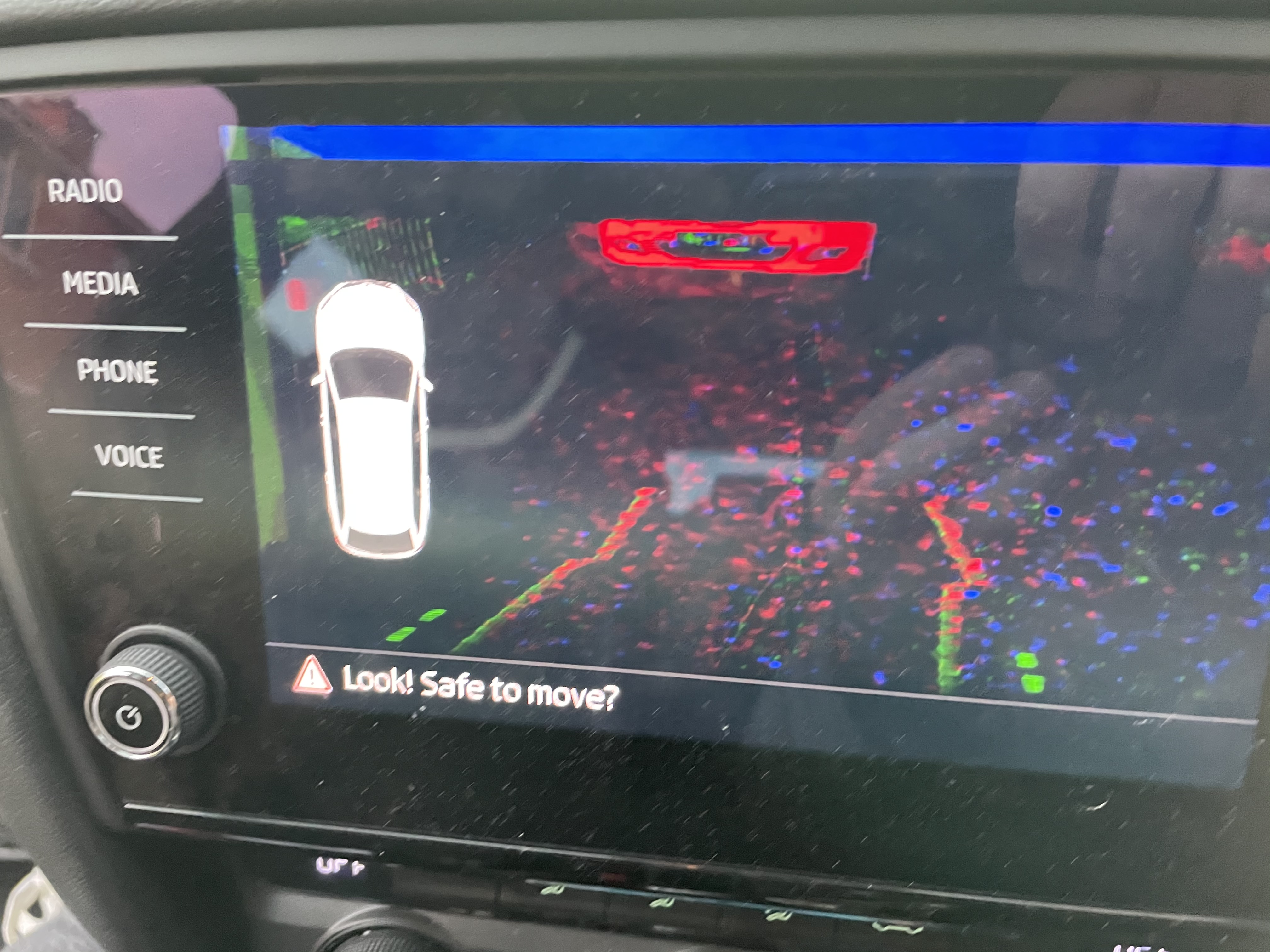

Perfect. Thank you. All wired and plugged, but no rear view. I’m assuming it needs coded in at this point, but I can’t seem to find an option in Carista to enable it. Will have to look again later. At least the trunk handle still works for now.
Byte 19, bit 4 in unit 5F
Well. It’s kinda working. Have re made the connections at the back of the stereo to no avail
