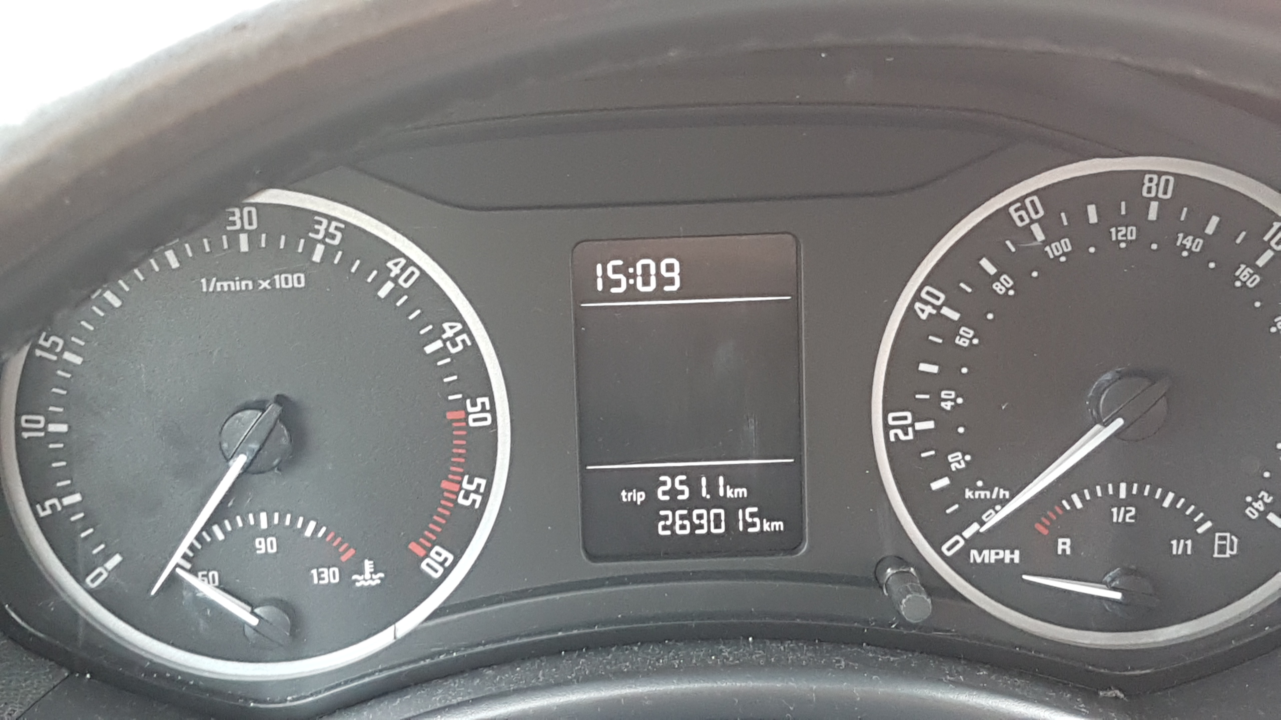

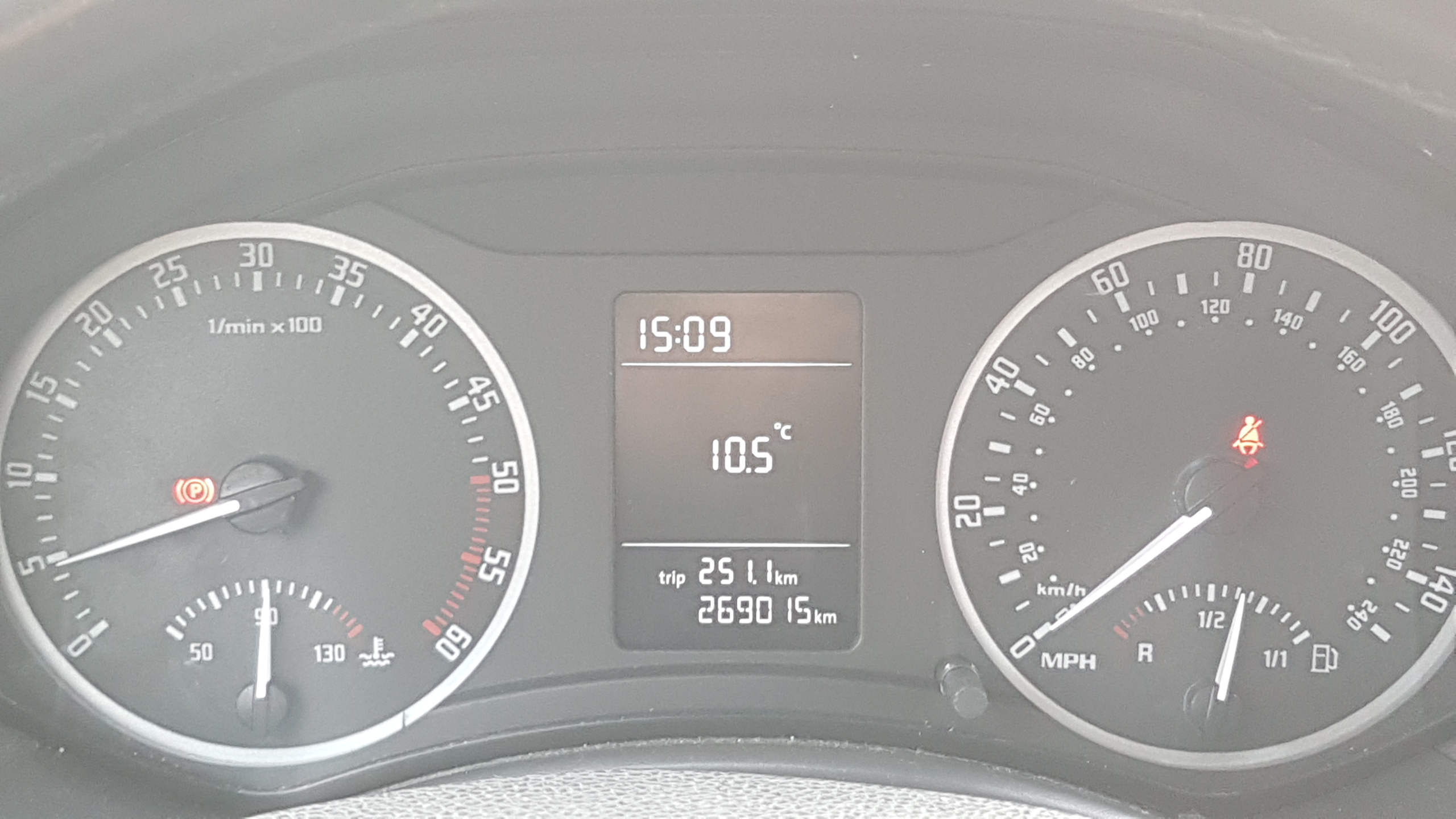

My instruments show negative fuel and rpm while the ignition is off, and way less than real values while it is on. I got a vcp+diag cable at hand, can this be fixed just via the software/reprogram the instrument module? I am fine using the hex editor, done that before on the central electronics.
The car is an octavia II facelift, 2011 model.
Can you get a picture/video to show what you mean?
At a guess, the needles will need removing and refitting at the correct angle.
(Tank is full)

Tried refitting the needles, didn't help. Will give it a second try...
When I've refitted needles, the easiest way I found was to:
- take the cluster apart
- remove the needles
- refit them very lightly
- connect the cluster to a car or testbench
- use VCDS to do an output test on a gauge
>> this causes the needle to go to max, then min, then hold in the middle
>> adjust the needle to point directly up
>> stop the output test and re-run it
>> if the needle still points directly up, refit it properly
>> stop the output test and re-run it to confirm the position
- repeat for the other three gauges
- put the cluster back together
Simples :)
Those dial facias look aftermarket to me?
The scales don't look original, have they been changed?
Yes, replaced the metric dials.
